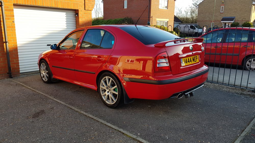

I have H&R springs with Bilstein B8's, which have worked amazingly on this car... It's my go to set up, had it previously on my Mk5 R32 and 106 Rallye. Great fast road set up.
That's a lufly looking vRS.  Nice to see one being cherished :thumbup:
