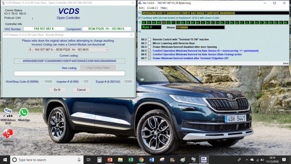

Re-reading your opening post I notice you have VCDS. This means the absence of Maxidot (and therefore the option to turn off 'rain closing' via the dash menu) doesn't matter, you can turn the rain closing feature on and off using VCDS instead.
This means you will be able to retain the auto wiping feature, when it rains, and also leave the wiper stalk in the auto position, you'll just lose the feature that closes the windows if the car detects rain / overnight moisture.
It'll be in 09 Central Electronics, but I'm not sure if it'll be called rain closing in VCDS or not, you might just have to have a play with a few of the related check boxes.
EDIT:
I just founds this, it is from my old 2011 Skoda Superb, but it should give you an idea of what to look for in VCDS.
Byte 4, Bit 5 & 6...
Edited by silver1011
I'll have a look at that, I changed a few things in there the other day, so I may have already come across it, but probably worded differently as you say, being an older model things aren't quite as they seem when compared to later ones!
Thanks again Silver!

After playing with vcds the other day, I think I cracked it, windows stayed where I left them even after a few showers, so thank you both very much for your help and advice. Sorry for not explaining myself very well at the beginning, I do tend to ramble on when I get going and didn't want to leave a massive message that people would get bored of reading and give up! Thanks again!
