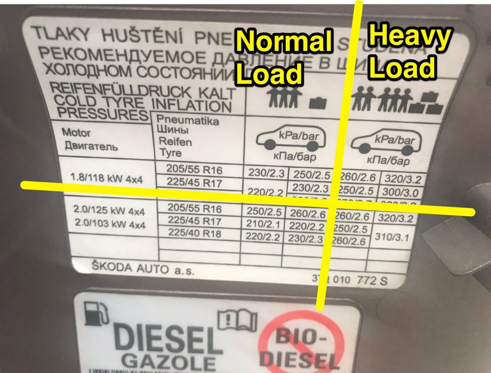

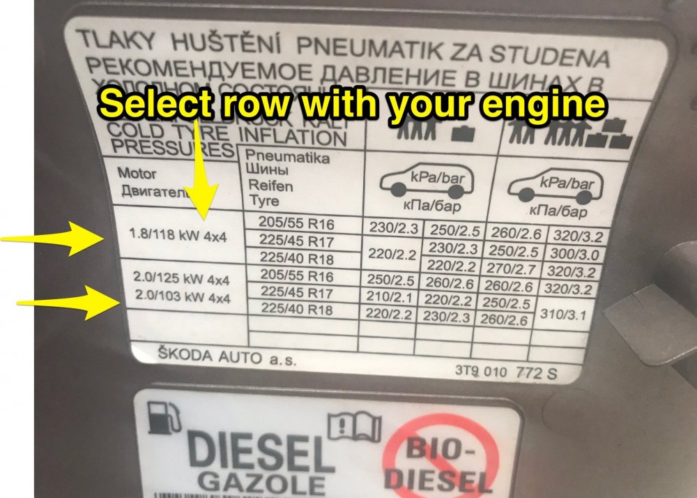

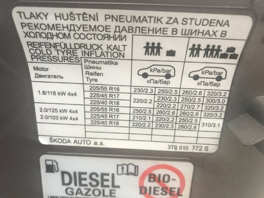

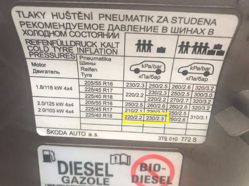

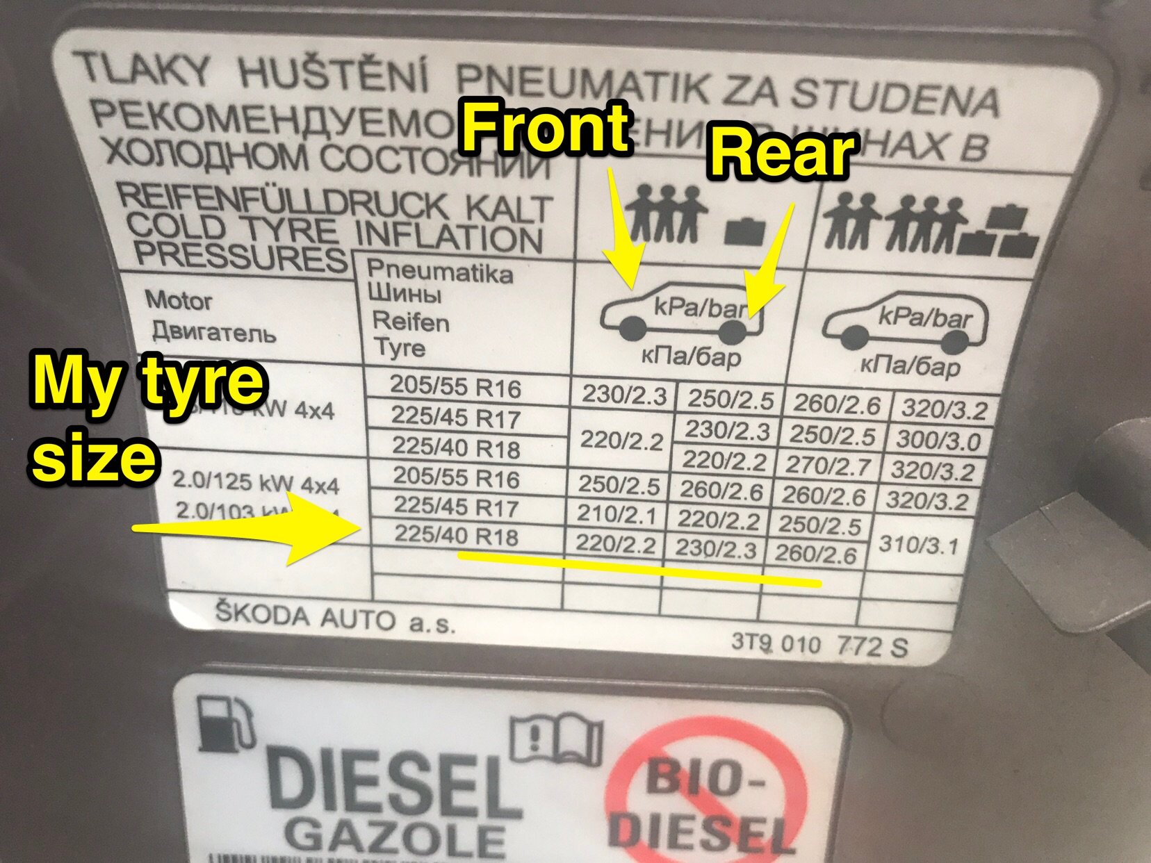

Let's go through it, I have a 4x4 with the 125 kW engine fitted with 225/40 R18 tyres so I would choose the bottom row. Then as I am running a normal load, move along to the first car image with three people.
In that block, the first vertical row is for the front tyres, the next row along is for the rear tyres so in my case for the size of tyres fitted to my car I would inflate the fronts to 2.2 bar and the rears to 2.3 bar. In Psi that would be front 31.9 psi and rear 33.3 psi. If I was running full load I would move to the next car image with lots of people and bags and again on the bottom row for my car would be 2.6 bar in the front and 3.1 bar in the rear, or front 37.7 psi and rear 45 psi.
