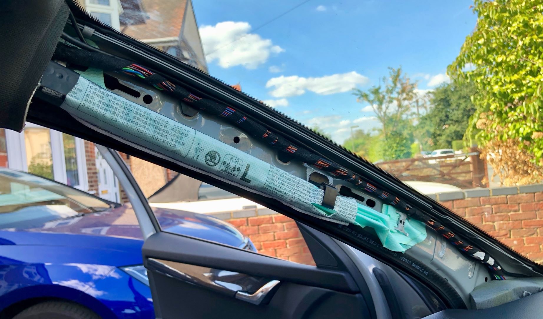

The headlining material will pull away from the edge and rubber seal easily, you must make sure that you route the cables above any airbags. There are some supporting brackets above the side airbags that I fed my cable through, and in-between them just tucked the cable behind the airbags. I'll try and get you a photo of what I mean later if I get time :)

the front pillar airbag as mentions looks like this.... and the cable MUST route behind it.

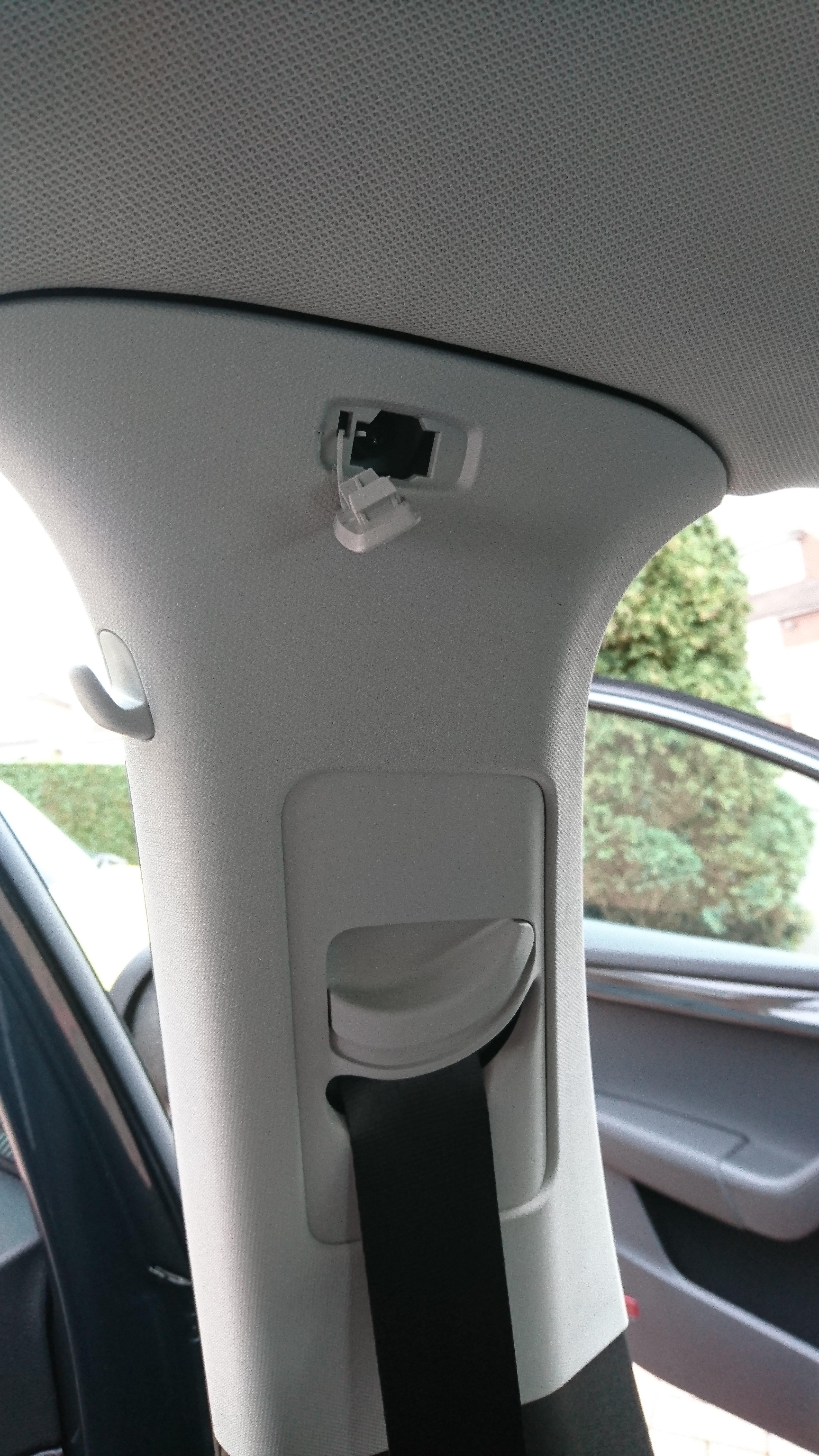

Agree with all of the above, I released the B pillar trim at the top as well (it holds the head lining)  torx screw hidden here

The front camera is already routed down the full length of the A-Pillar, so I know all about the Airbag positioning (and the b@$tard slidey retaining clips which refused to go back in neatly...)
