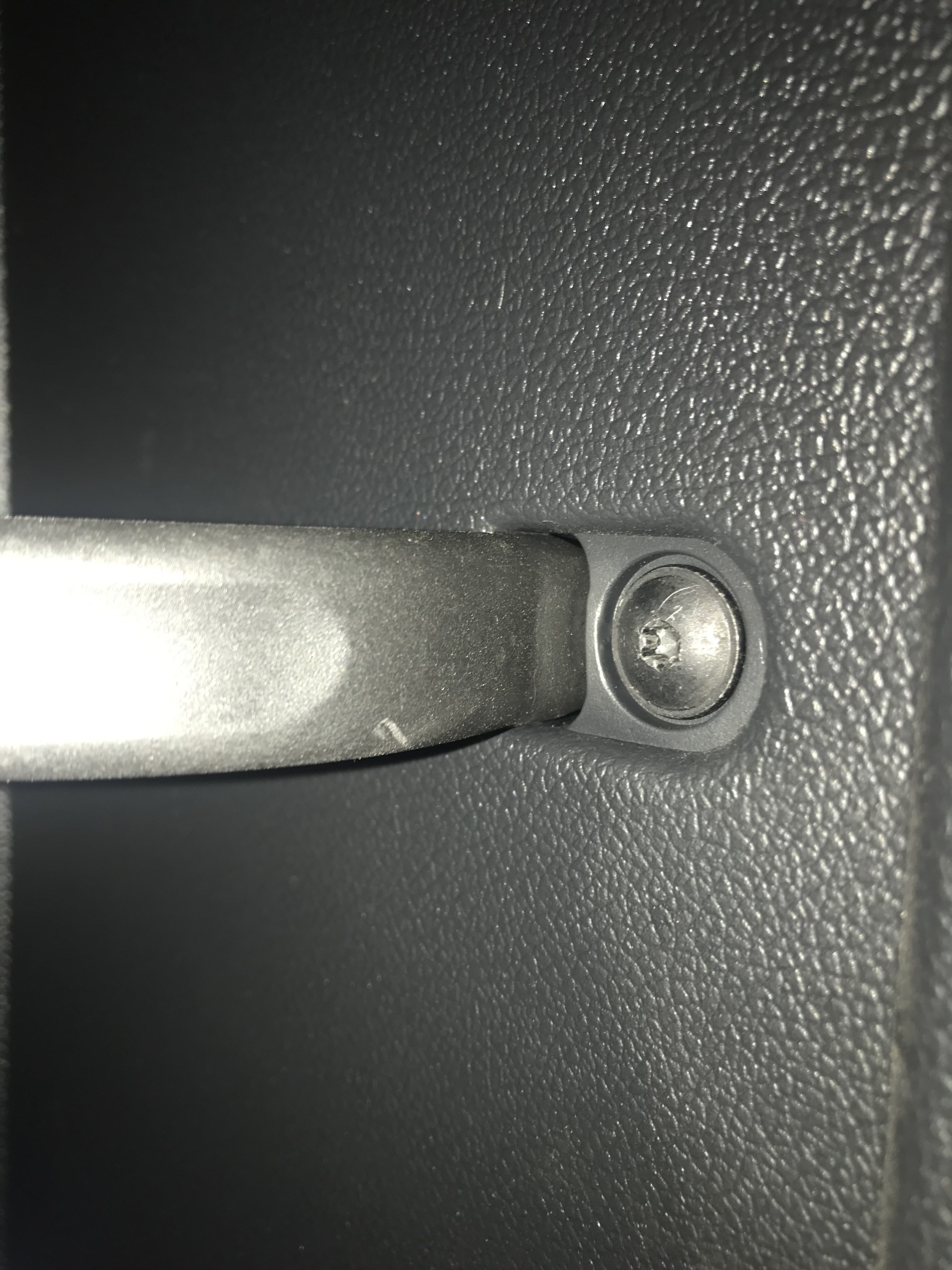

Think one torx if I remember for handle.

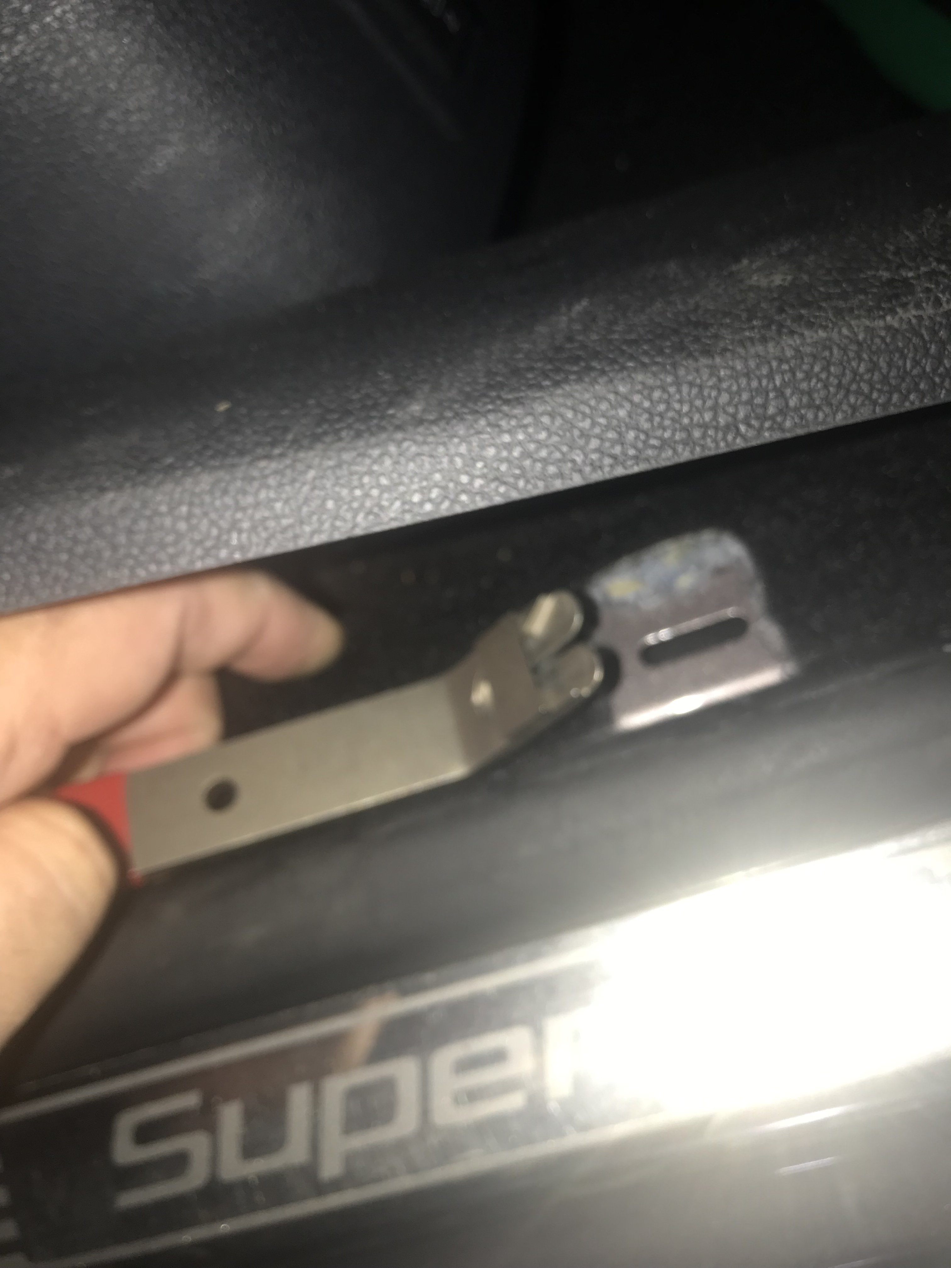

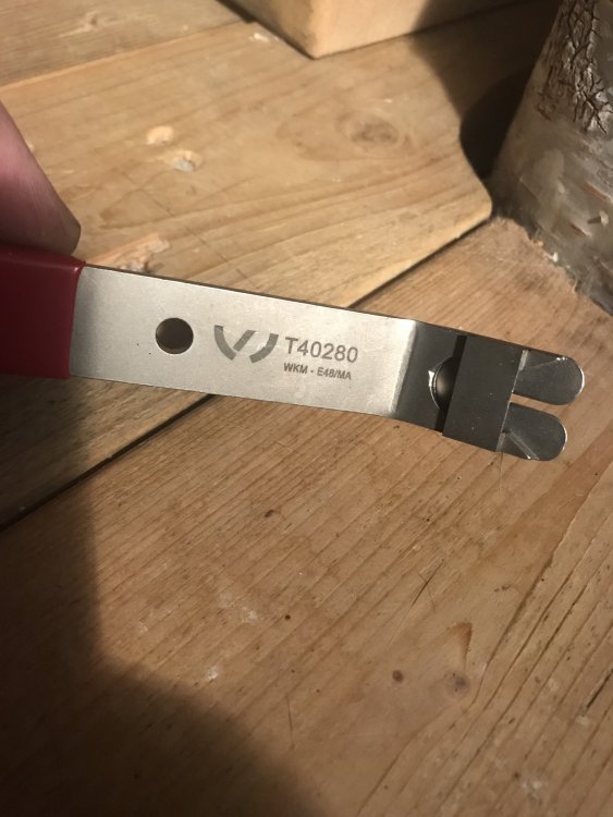

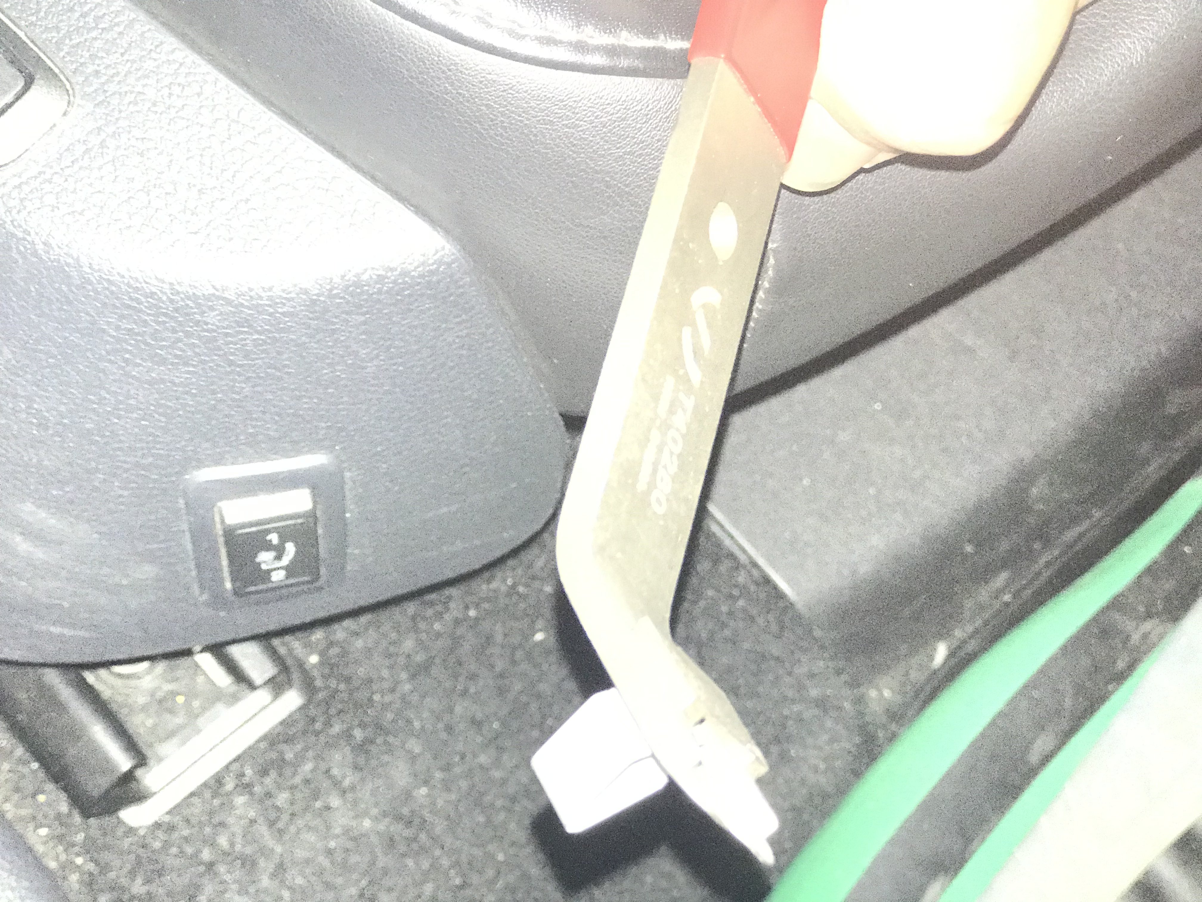

My favourite trim clip tool for removing any spring clips left behind in photo below.2F14E51B-11F2-4D5D-B81E-45EB1B6CCA5E.thumb.jpeg.c48f85b90e4a20a61e7ede2504033518.jpeg

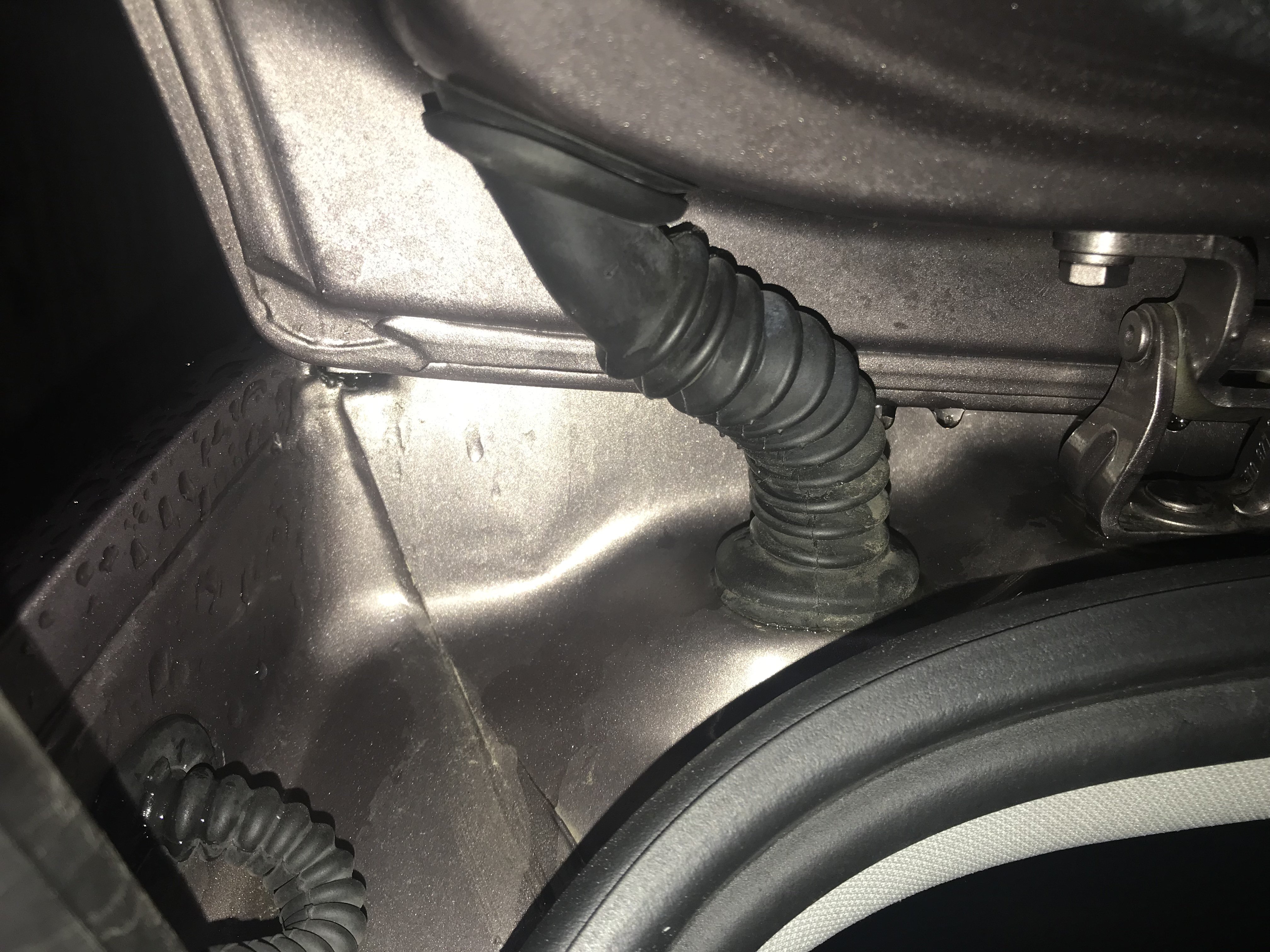

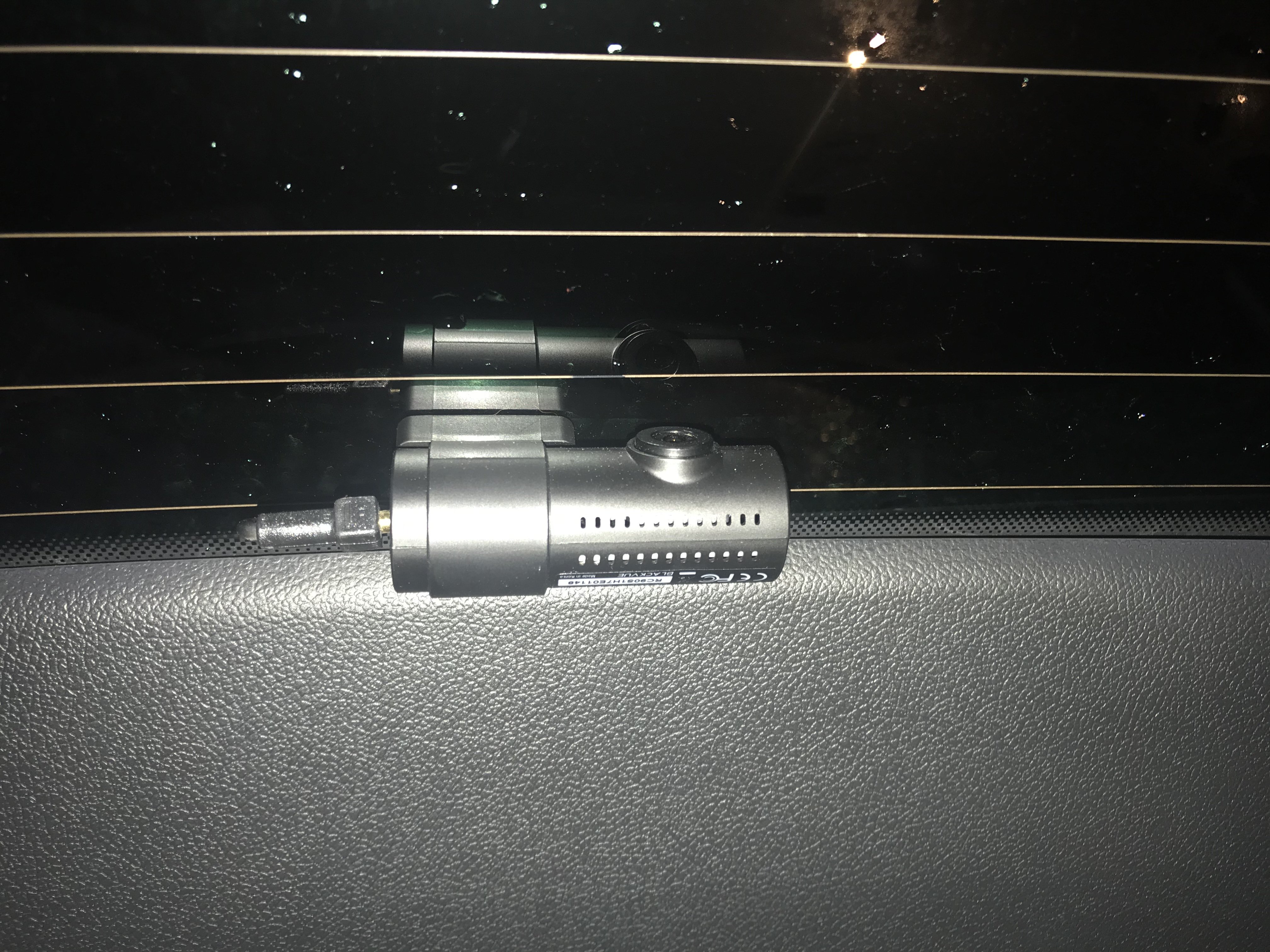

Thanks everyone, i was able to pull enough of the top section back to feed the wire through, there are about 5 clips and i found by putting my hand behind the trim from the screen upwards, I was then able to find the clips and pull that section back, then work my way along, fed the cable through the rubber tube from the headlining and result is a very neat rear camera
@psycho6149 were you able to get a picture of it fitted?
