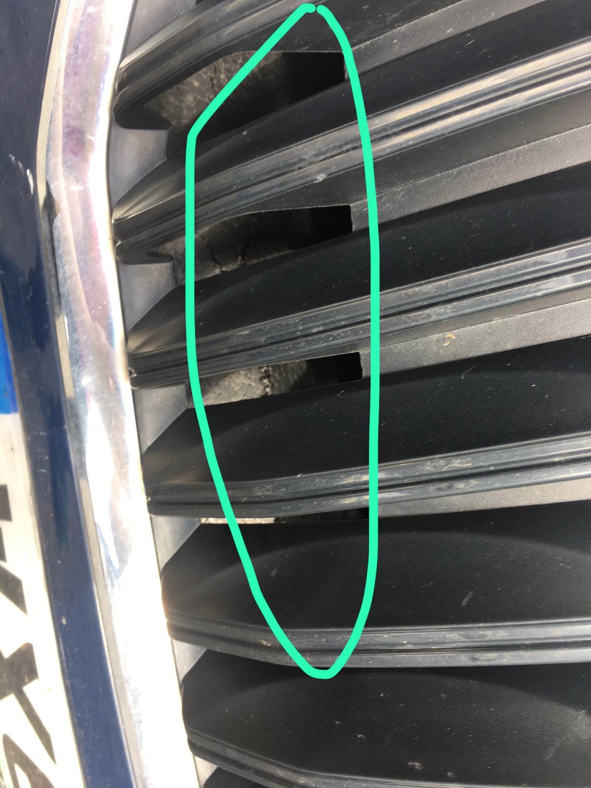

Does anybody know where I can source the impact foam that sits behind the front bumper grill? pics attached.
A neighbour left their handbrake off and their car rolled into mine, the foam has split (as it should I expect) so I am trying to replace it.

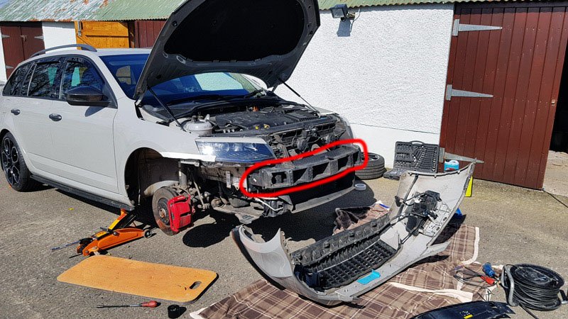

they are not moulded in but you obviously need to remove the bumper to do it. i have a thread on grill replacement with a how to. its a two hour job at most. The absorber just screws on with torxs

process is the same to remove the bumper
