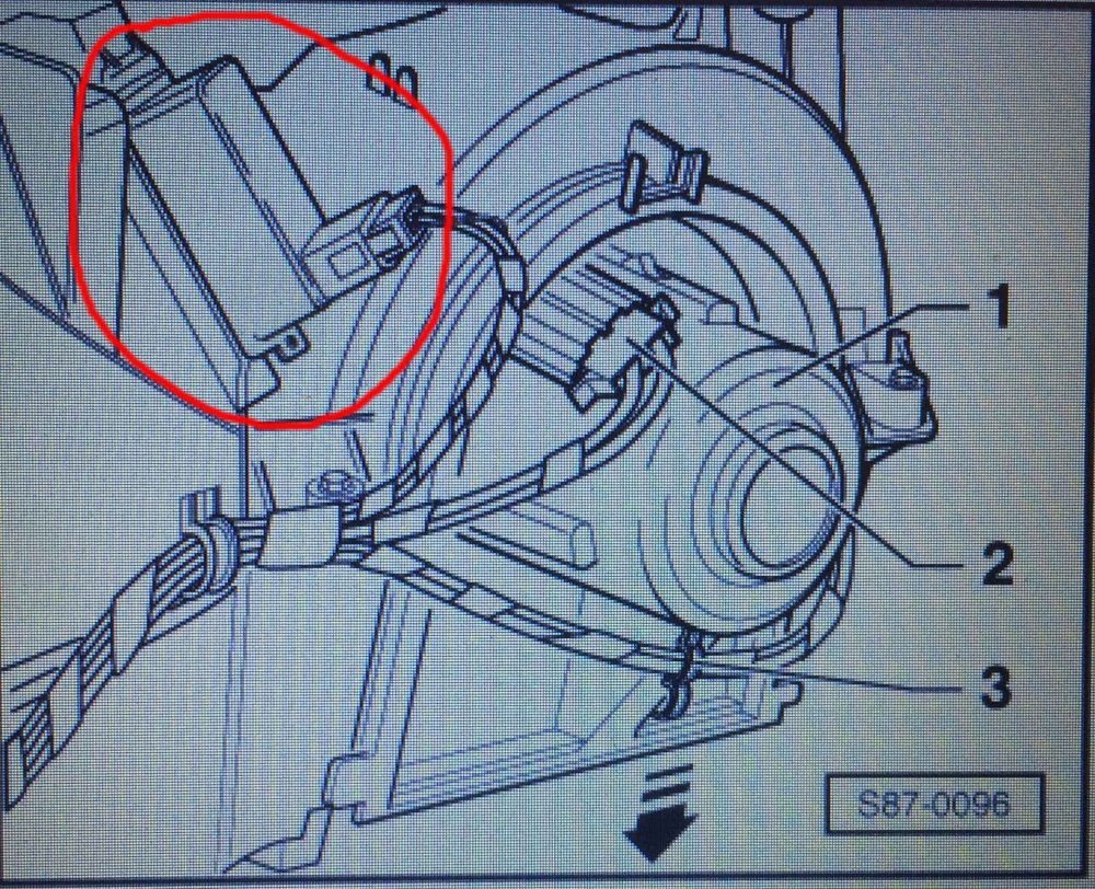

Do you have climatronic ? as there is a seperate unit fan speed control unit, if you have a basic setup then there is the fan speed resistor pack in the fan unit

This is the fan speed module on the MK1 304504049_Octy1FanSpeedmodule.thumb.jpg.152e5219847d031f9277bf749074e59d.jpg
If you have a MK2 then the module is integrated in the fan unit and isn't a seperately replaceable unit according to the manual
It is a mk2 , is it the module that would be faulty. Many thanks
I would start by checking the condition of the connector on the fan unit before condemning the unit, it might show up on a VCDS scan if there are any other things that might be the cause

 When the heater air stops, does moving the blower speed control do anything, such as an increase in noise? There is no heater blower resistor on the mk2 unless an early 2006 model is a throw back to the Mk1. Speed is controlled electronically if I remember correctly.
Initial thoughts are that you may have an intermittent connection so, looking at the picture in the post above, wiggle wiring and connections next time you have a problem.
I'd put money on a poor connection to the motor, seen it plenty over the years.
