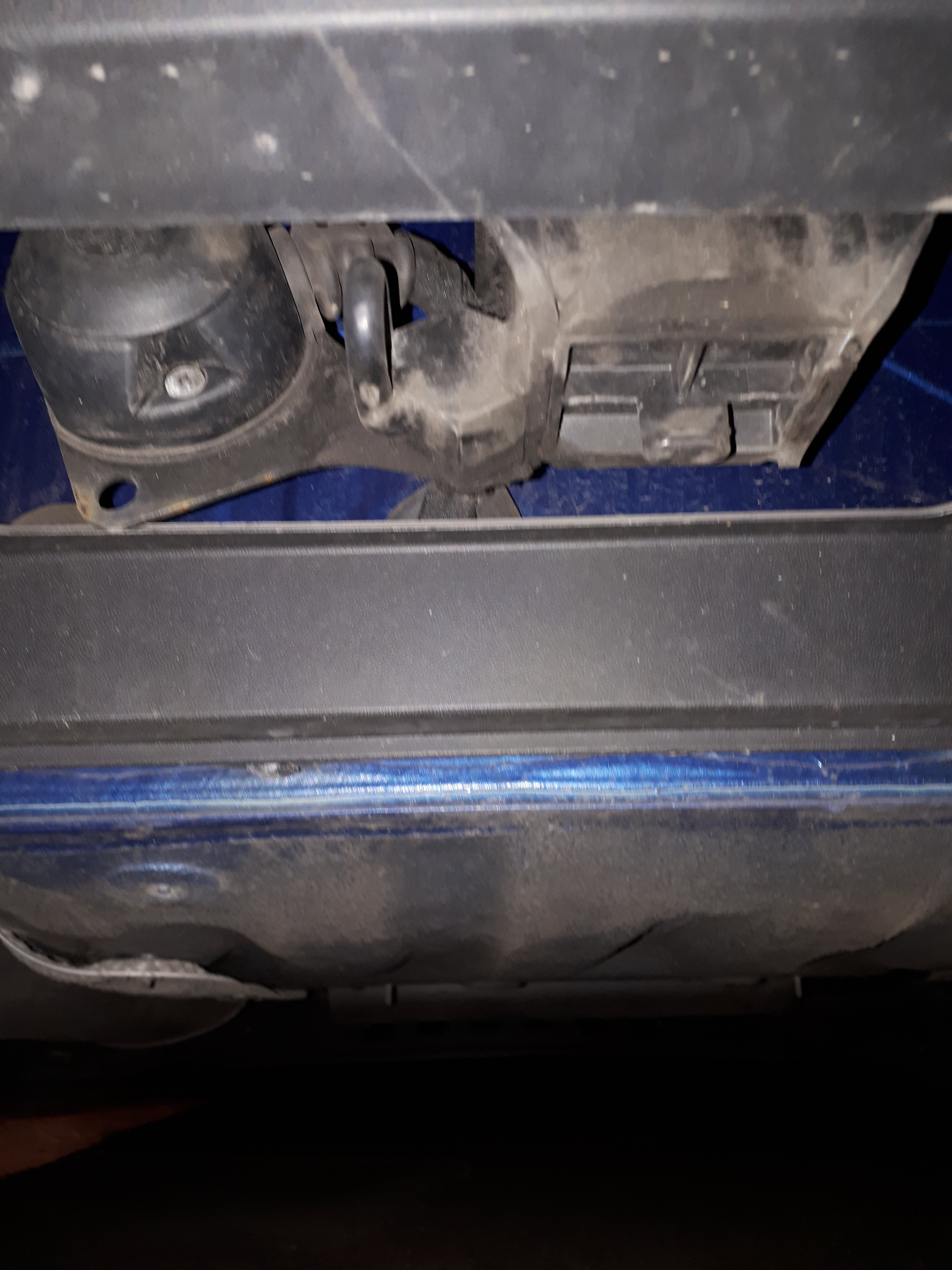

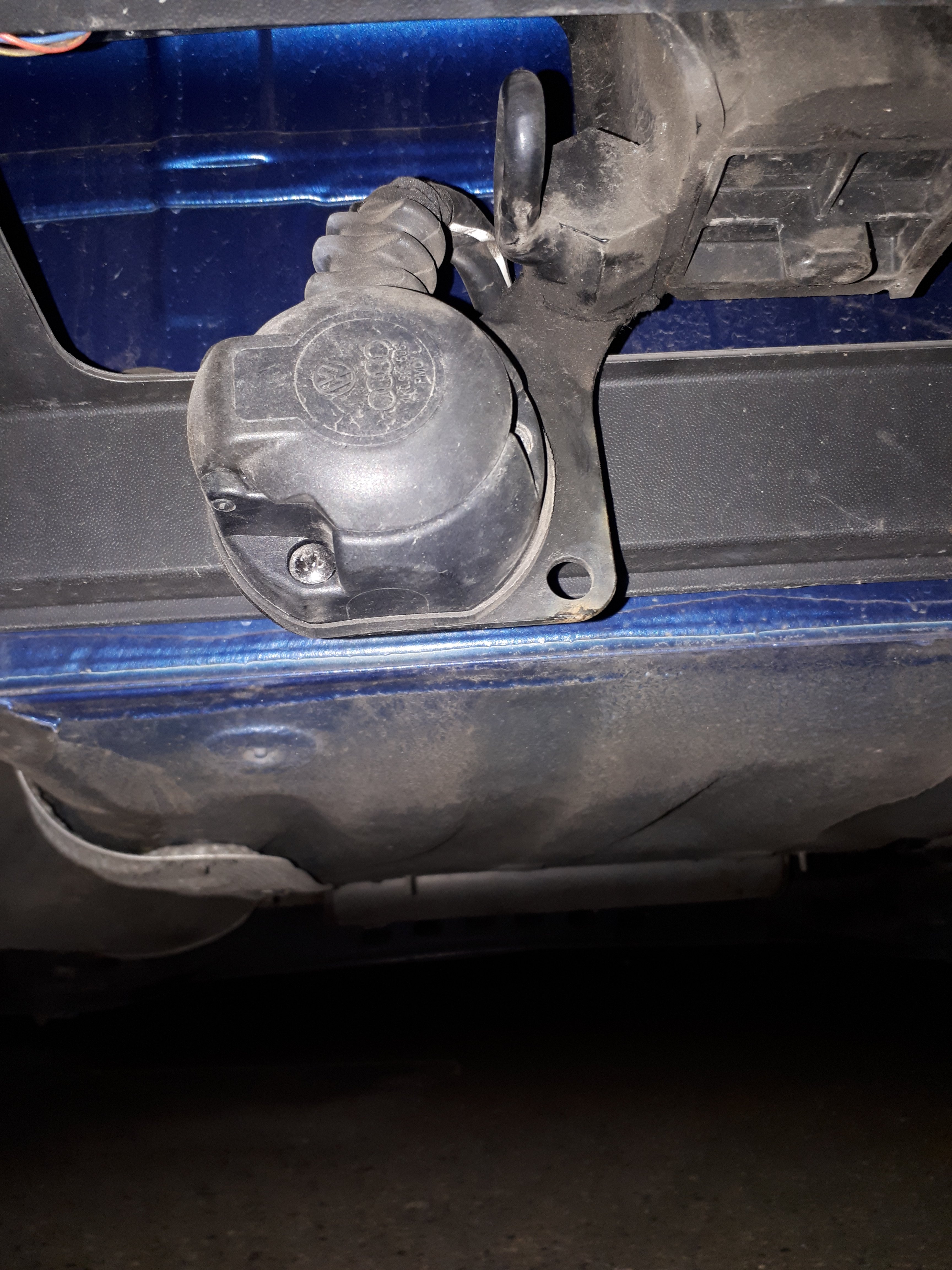

The socket on the factory-fitted detachable towbar on my SE Estate is hinged so it turns down about 90° anticlockwise. It can be quite stiff to move down as it's only held up with friction - and also a bit awkward to get at under the bumper. I've just taken these two photos which show it up and down.

It's a bit awkward to pull down but I haven't had any clearance problems plugging into it.
Me neither, once it is pulled down.
mine snags on the rieger splitter as its deeper at the back, its mm though so nothing that cant be sorted
