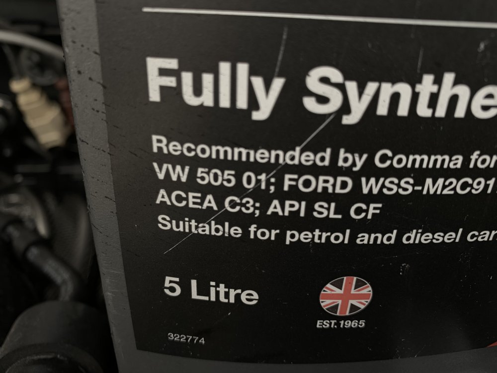

Oil
Any one know if that’s the right oil for the mk3 facelift model ?
Move got the 2 litre diesel.
its VW 507 00 for the diesel engines
PD - Pumpe Duse. That stuff is for the older engines.
Where did you get it or more to the point, how old is it?

Certainly do not use it.
The oil is not low ash, so could block the dpf is used.
Got it from motor parts direct a while back. Before I got the new car.
