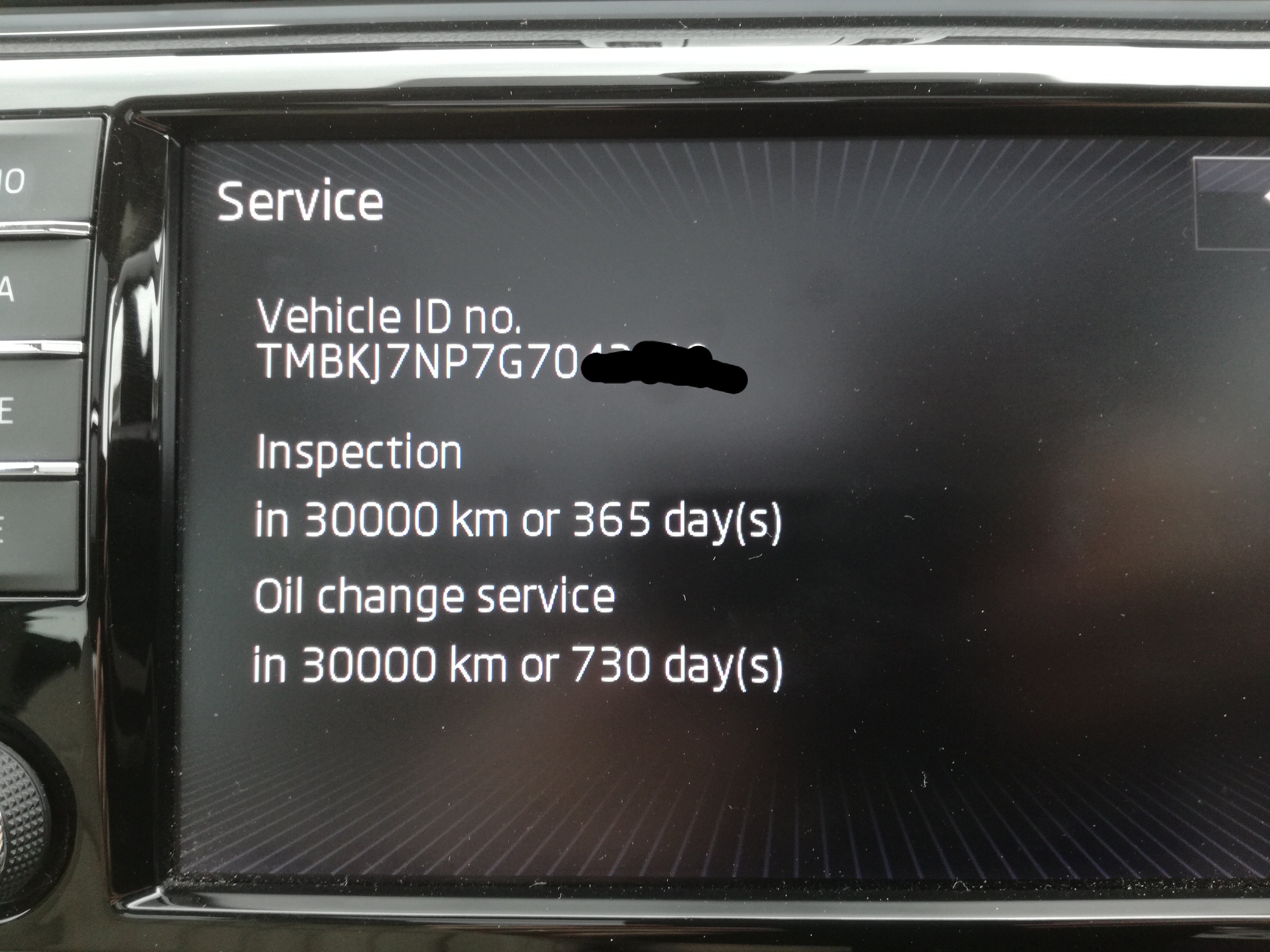

Interesting @Markbro and thanks for posting. I'm in England so working in miles rather than km. Could you do us a favour the next time you are in your car? Check the service interval  From memory it is "car/ settings (cog icon) / service". Mine gives the interval in miles followed by days. It shows two - inspection service and oil service. It's the oil service interval (km and days) I would be interested to see as I've never heard of a 30k / one year combination. Mine showed (again from memory) 18,700 miles / 720 days immediately after the service. Thanks in advance.
Sorry you are correct, it's the inspection that's 1 year but the service manager was adamant that the oil should be changed within the year which is what I would be doing anyway.
If your annual mileage is high enough to warrant setting the car to variable, then you'll be getting fresh oil once a year anyway.
Cheers @Markbro - genuinely appreciated. I'm gutted - a 30k km / 360 day limit would work brilliantly for me as my mileage goes regularly from insane to zero depending on work. Thanks for confirming.

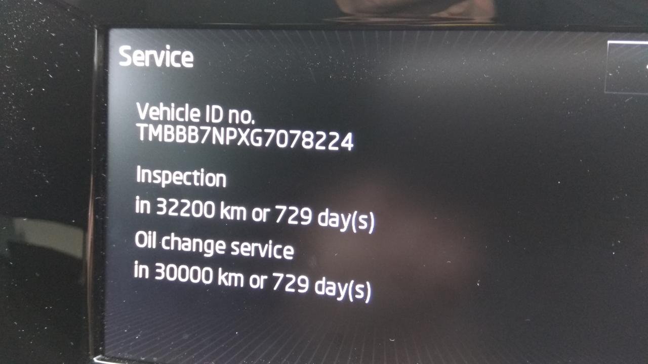

Update on this. I asked Skoda to extend the service intervals. Was surprised to see this on the dash today.
Looks right to me Stevie. On mine it is 17,000 miles or 729 days (Skoda's weird version of two years). The inspection and oil service dates never match up, but they do the inspection service at the same time as the oil service so no drama there.
