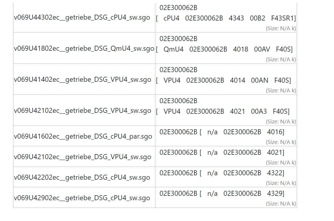

So my question is, if the dsg software, is independant of the vehicle and engine control, and in theory it is possible to flash the gearbox with the latest software, no matter what car it is released for, just as long as it is the correct unit ? From the first link there is several updates available, but they are sort of grouped by prefix, see attached screenshot.
Without a TPI explaining which software should be used, it's very hard to know which, if any, are applicable to your specific DSG.
Might be worth paying for an hours access to https://erwin.skoda-auto.cz/erwin/showHome.do it should be possible to browse all the TPI's applicable to the Superb and see if any are applicable.
Otherwise, a VAG DSG specialist maybe able to offer advice :)

Actually i have looked at erwin, and there is no tpi for updating the software in my gearbox.
But there is so many updates to the specific dsg unit - they are supposedly for other cars containing the same dsg unit. Tharefore i thought that one of those clould be flashed on my dsg unit, no matter it was designed to an octavia or a passat. But i guess im wrong....
From what I understand, there are quite a few different versions of the gearbox (with hardware changes) so there is no guarantee software from a similar version will actually work.
There are some knowledgeable people on the ross-tech forums so assuming you own a genuine VCDS lead, you could post there with an autoscan?
Oh - I can't remember if you've tried doing the DSG adaptions/basic settings yet?
