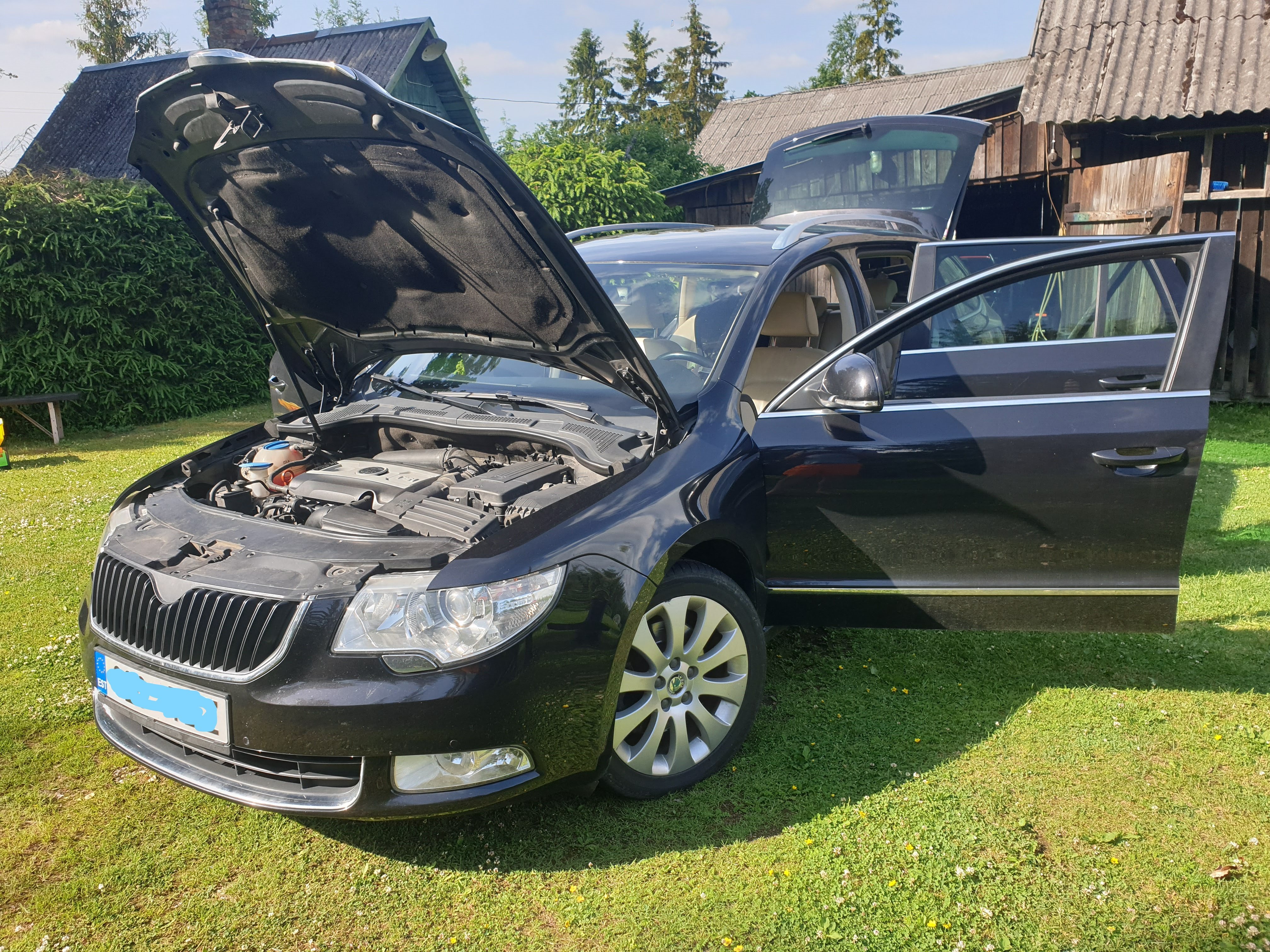

My review of the famous MK2 Superb
Hello bought it a year ago, read all the topics of the infamous DSG 7 speed and the CDAA 1.8 TSI engine heard only problems and problems only few who said it was a dam good car.
My car is 2011 Superb Estate Elegance+
with 213000km on odometer
About the DSG 7 speed has only had 1 clutch changed about 20k back was running with the original till then. gearbox is dam smooth had before BMW 530d automatic before cant even compare these. DSG changes so fast and smooth its incredible. DSG have had no software updates no oil changes on the mechtronic box. Just love that DSG.
About the engine and the oil consumption
Im using 5w40 withouth Long life ´using  502.00 oil
uses about 0.100-0.200ML of oil every 2000 kilometers and thats very good for that engine, i recommend using 5w40 after about 150k+ KM-s
Engine have had no pistons or oil rings changed (has the old ones not the new ones after june(?) mines may.
210000 engine had chain + chain tensioners + water pump changed (had crack on it) and few seals + oil change + some misc stuff škoda did this bill was 1400 euros (first chain change on this car)
car has had only regular maintenance oil changes every 15k
Ive been very happy with this car if you check the forums you only see bad stuff and no one is writing any good on it
