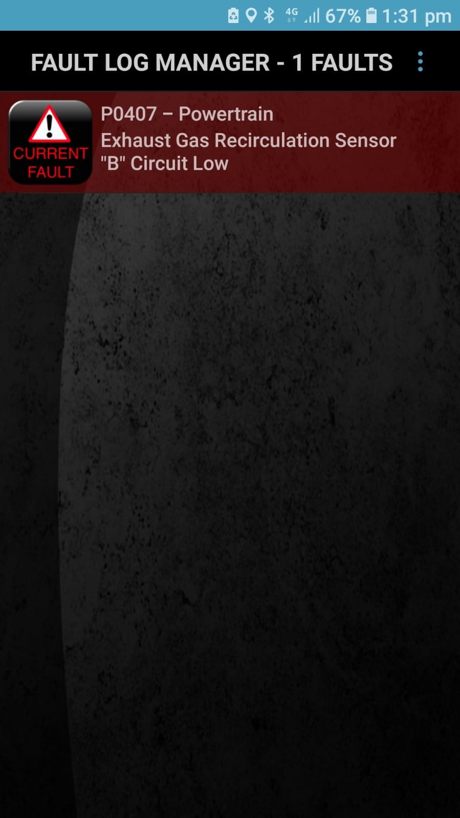

Hi, i have a question , i hope to wont bother anyone. Can someone tell me what is the sensor b for exhaust gas recirculation ? Thanks

What is the problem you are trying to solve?
The only sensor in the EGR valve of a 12-valve 1.2 Fabia is a position feedback potentiometer. Various fault codes could be generated if that is reading improbable values (e.g. 17847 Incorrect basic setting;17850 signal too high, 17851 signal too low). What numerical fault code are you seeing? What device is reading the codes?
Please confirm that your engine is a 12-valve 1.2.
Yes is a Skoda Fabia 1.2 htp and the fault code is p0407. One mechanic tould me that he can clean the egr valve and the acceleration cap.I looked inside and is dirty. The car is not running like a few weeks ago  so this could be the problem or i have to change the egr valve? Thank you for help i really appreciate. IMG-20190119-WA0000.thumb.jpg.83baa098810bdcd6a89a6e8afbade024.jpg

EGR valves on petrol engines don't really get very dirty, because they operate in such hot conditions. Cleaning it is unlikely to solve any problem.
The throttle body (acceleration cap?) does get dirty and the EGR valve outlet just below the throttle body can become blocked by soot, so yes, it may be useful to clean that.  The fault code number you show isn't a VW group specific code, and doesn't give much detailed info about what is wrong. Find someone near you with VCDS and get some better information before spending any money on parts or work.
Alternatively, buy a handheld scan tool that is compatible with VW-group cars of this age, maybe around £20?
