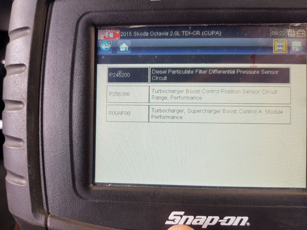

Just recently bought a skoda octavia mk3 vrs diesel. Ive had the car for a few weeks and everything was running fine until yesterday morning. As ive started the car a few seconds later coil light started to flash with the start stop error message. Anway turned car off and then back and light has gone off and car has been running fine all day. Today morning same thing happend, so ive had thr car plugged in and its coming up with three faults, ive done a quick bit of research and the common thing thats coming up is boost pressure sensor. Just wanted to some info or advice of u guys. Thankyou

Has your car got any ECU tuning on it? Be it a remap or tuning box?
They can cause that error to come up. When I had my dtuk box set on the highest settings, it threw this error up. Toning it down a bit solved it.

No everythings currently standard, no mods just yet.
