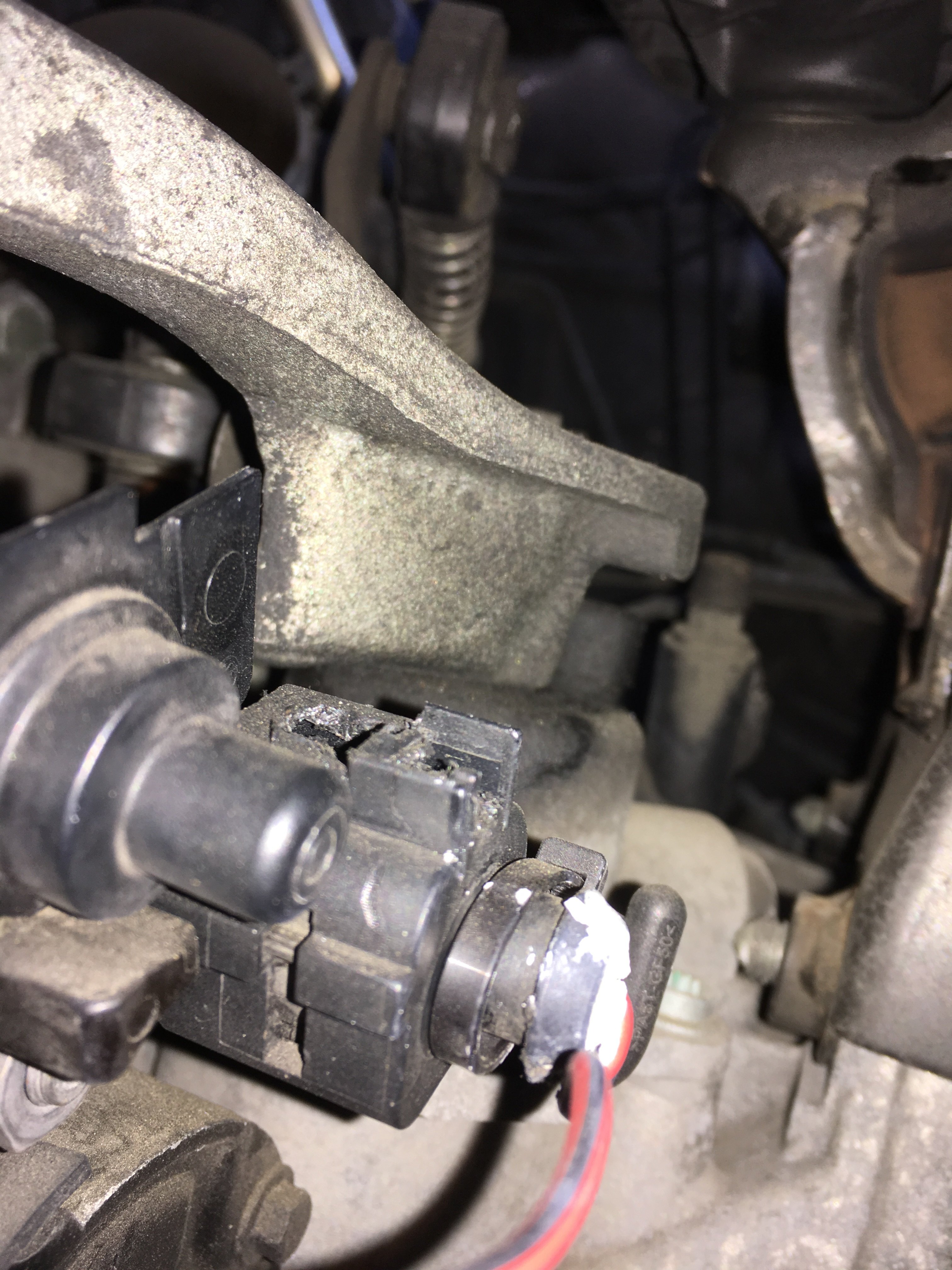

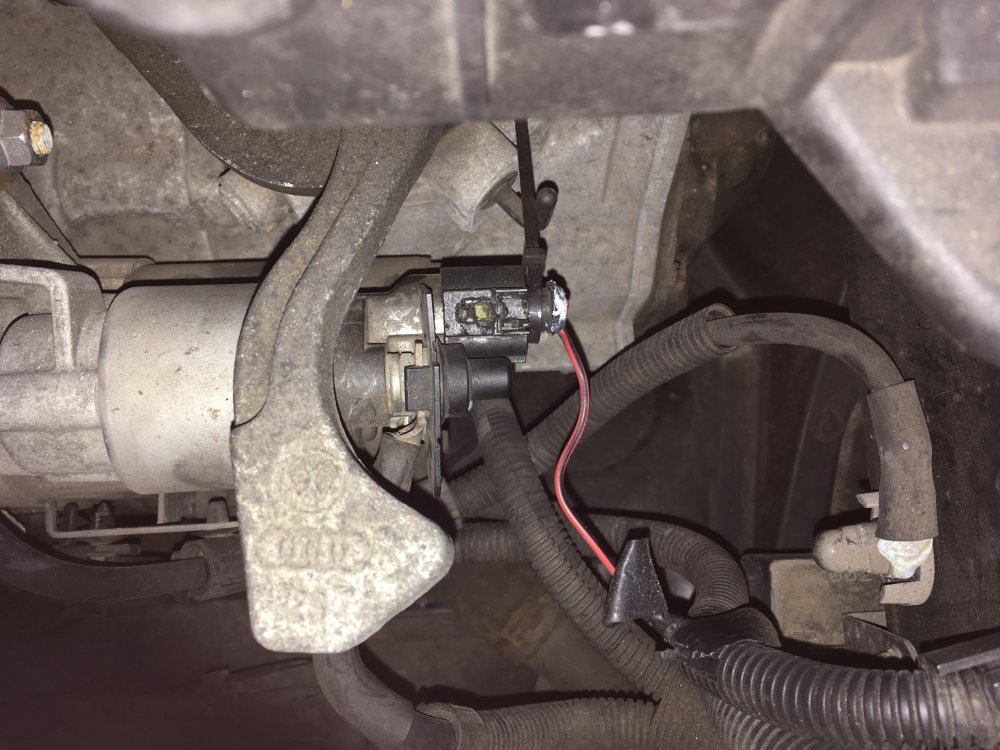

Here are two pictures I've just taken.
The RAC man looked at this when I originally broke down back in March of 2016. He was able to make a roadside repair, which is when the connector disintegrated. The repair has been ok since, but has now started to be a problem again. Wiggling the wire will get the car started until it happens again.
The white "residue" you can see is actually some plasticine we stuffed in the hole to try and seal it up from the elements.
I am tempted to take the battery box off and take a proper look at whatever is left of the connector. Hopefully then I can identify the correct part and make a proper lasting repair with a longer piece of wire.

Original connector was busted and not reusable.
Have connected a new piece of wire temporarily with a 4.8mm blue female receptacle crimp.
Will order a replacement connector to fit properly at a later date.
Started first time on the drive (cold engine) and after a 22 mile test drive to get the engine bay nice and hot.
Fingers crossed that's sorted it.
For completeness, ordered a pair of 1K0973751 on ebay (from latvia) and it was the correct part.
