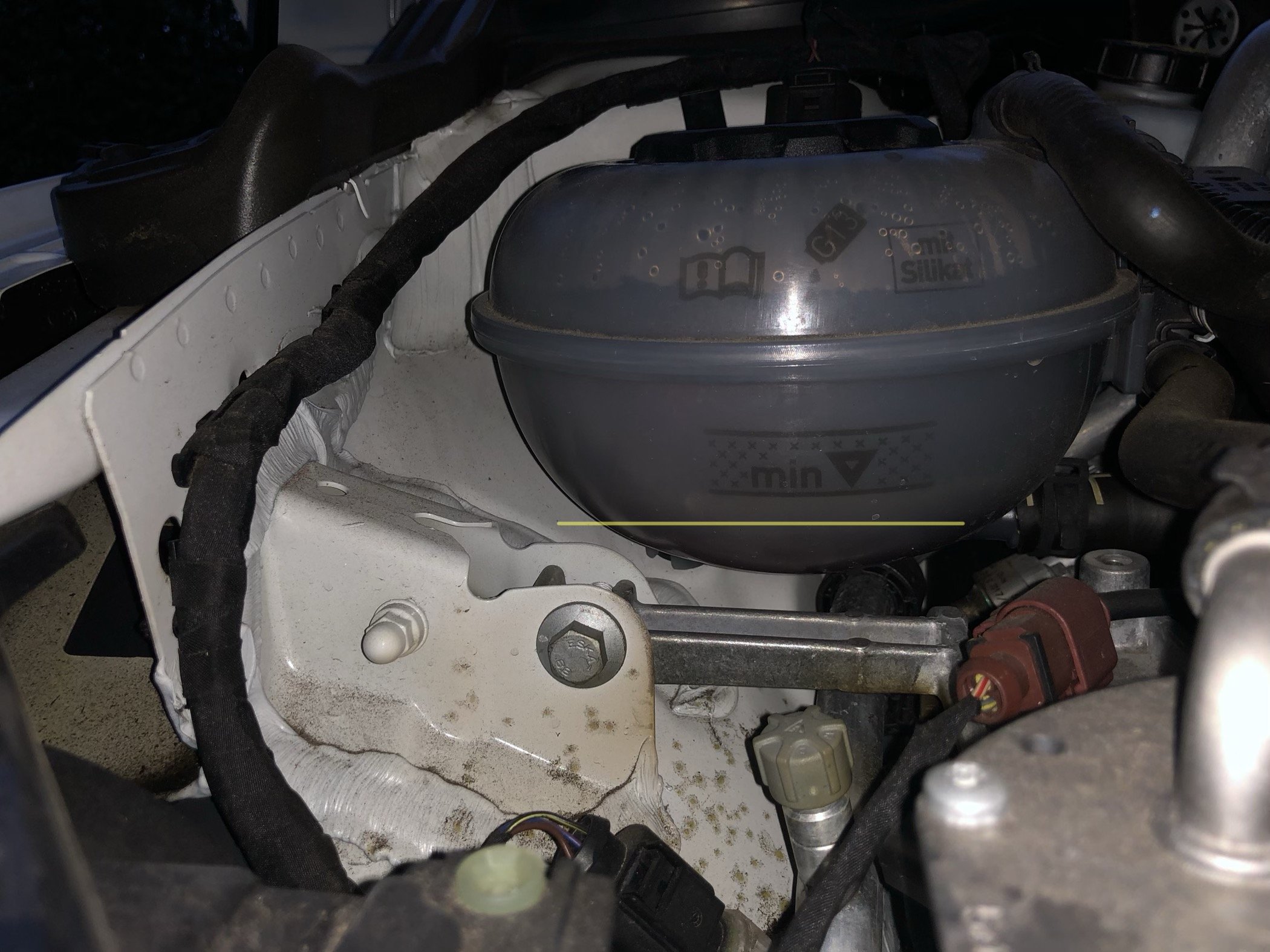

Yes I think it has, unless I didn’t get the angle right before. But with a phone light flash, the level is low as illustrated with the yellow line.
I think I might just call the dealer and see what they say. I’m very wary of coolant lights as I had ongoing issues with a Touran, albeit that car was older and 100k mikes on the clock!
