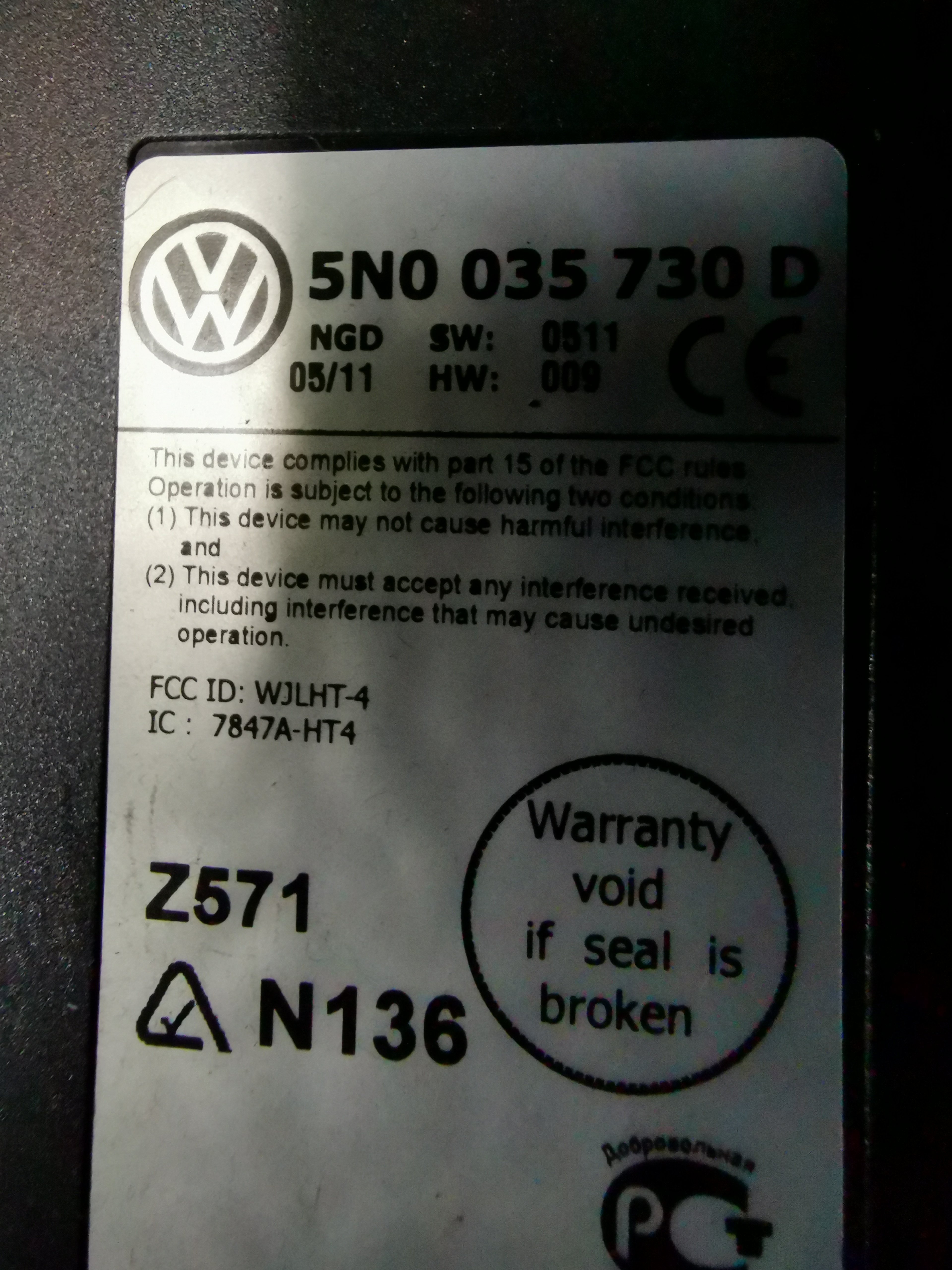

Have a look under the drivers seat to see if you can find the module, if you find it post up the part number.

As requested here is the module that's under the driver's seat.
