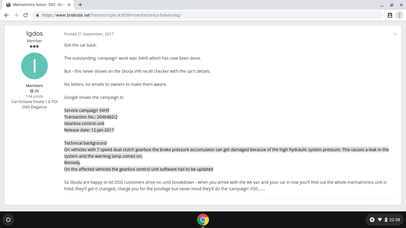

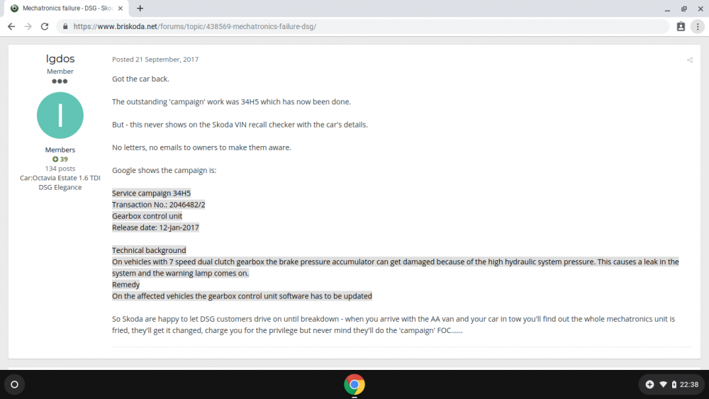

With DQ200 DSG from 2013-2015 there was / is a MCU / DSG issue with some, that is quite a few worldwide actually.
In the UK that is 'Service Campaign' 34H5 that covers it, & there is a Software Update.
This came about because of failures of some units from some plants, so wherever in the World anyone with a 2013-2015 DQ200 DSG should check if they should have had the car called in, was it called in, or was it one that a 'Voluntary Recall or Service campaign missed.

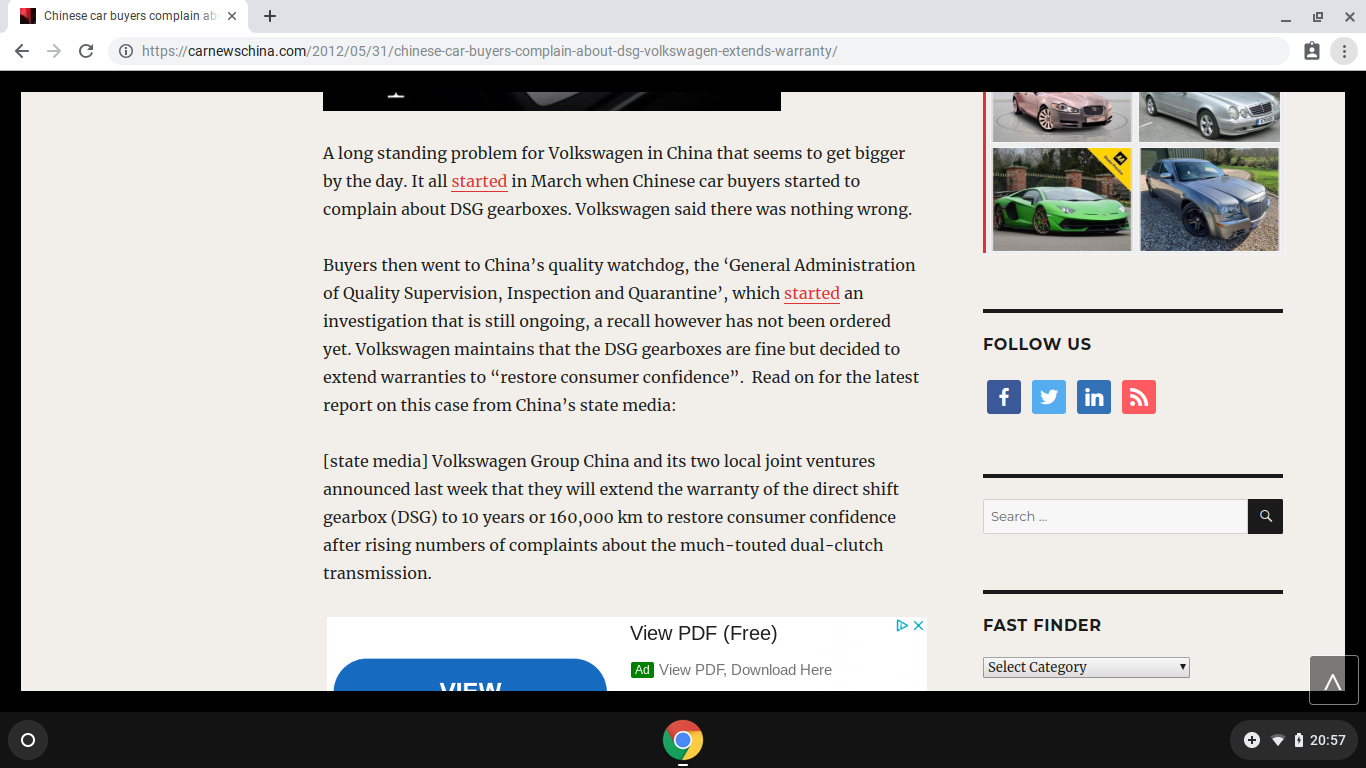

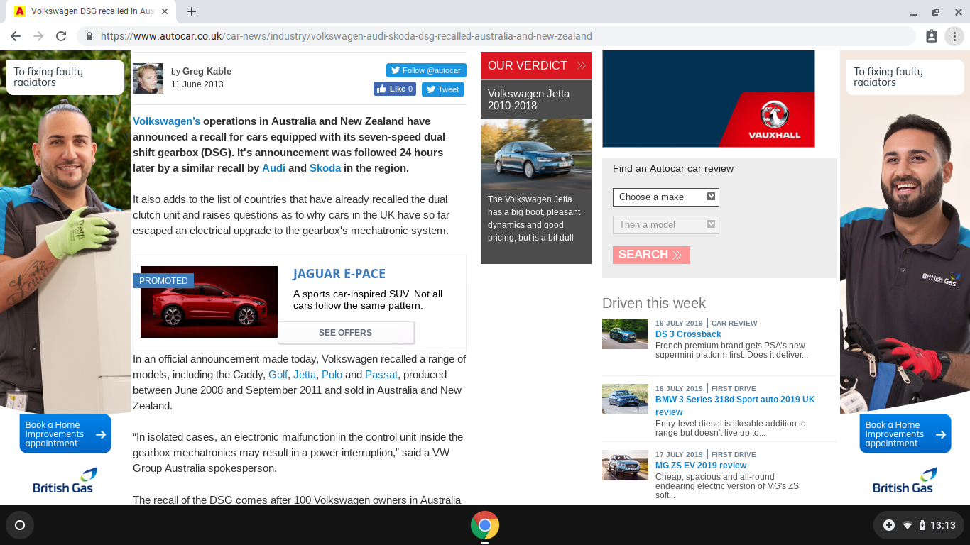

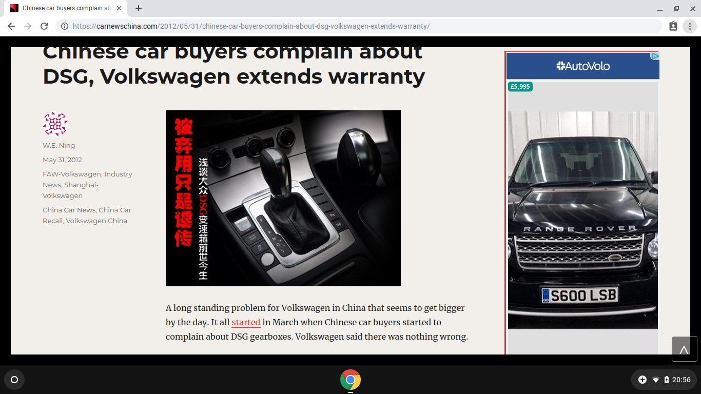

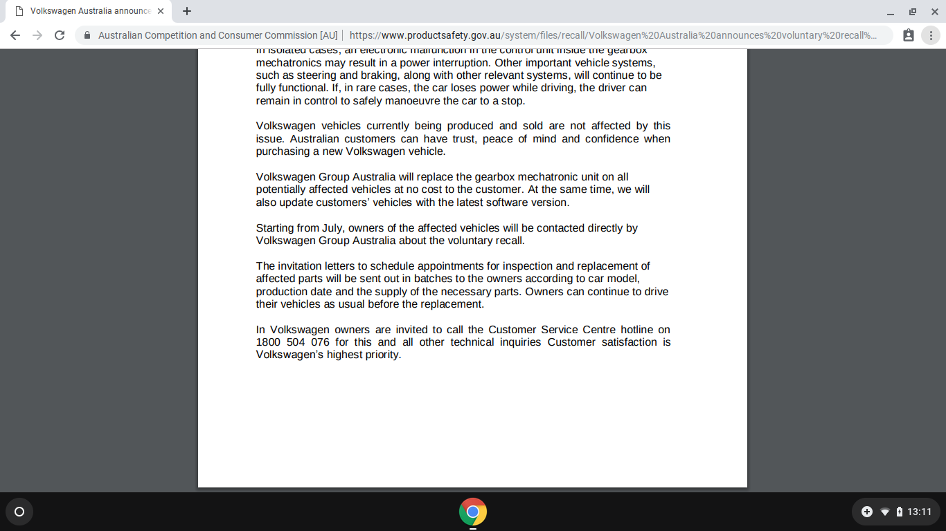

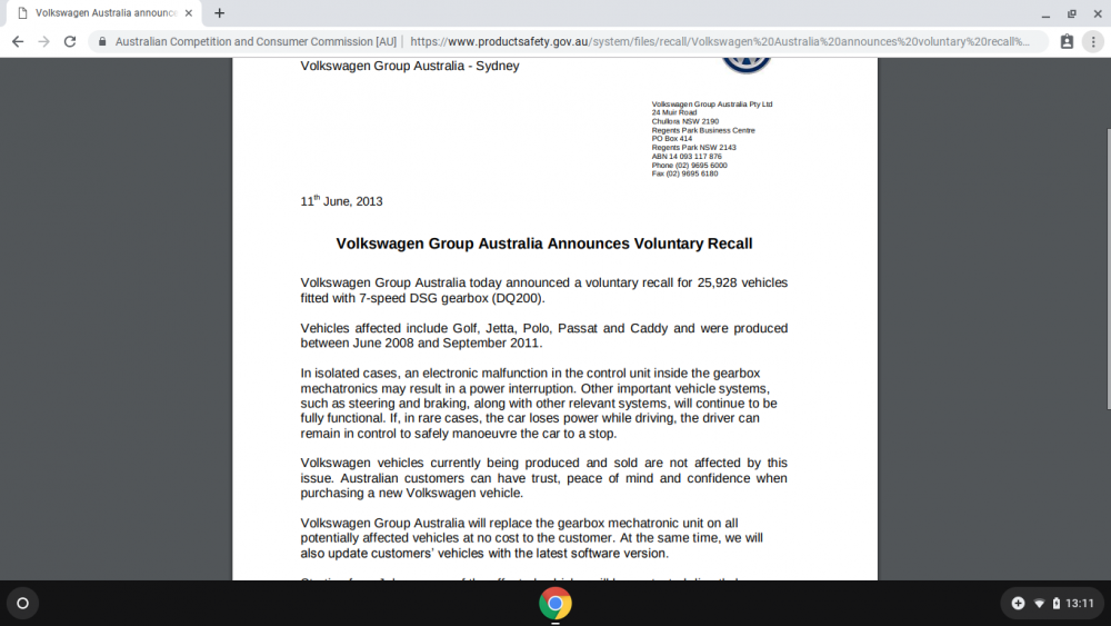

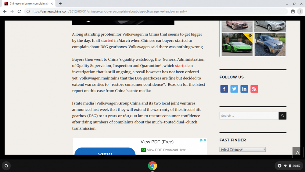

The reason that the VW Group can and sometimes do cover Mechatronic Control Unit Failure DQ200 7 speed DSG's on 5 year old or older cars is the World Wide recall in 2012/2013 that excluded Europe Obviously, but in some World Regions like China extended warranties were given.
(Europe obviously not in the World so just a Service Campaign from 2014.)

In New Zealand & Australia Mechatronic Units were replaced along with the Synthetic Oil for mineral.
Edited by Roottootemoot
