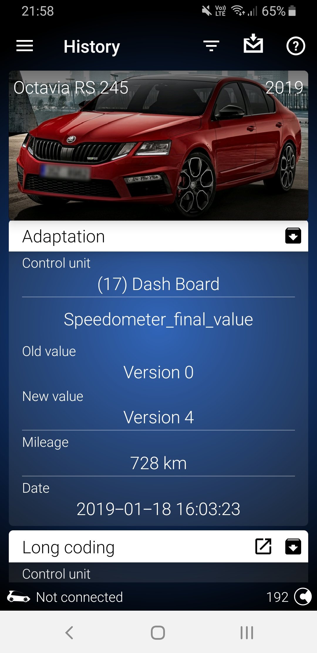

As per the picture, mine is version 4 which gives the 10mph increments but keeps the original end value I believe.
However, choosing any of the other numbers and seeing what happens won't cause any harm!

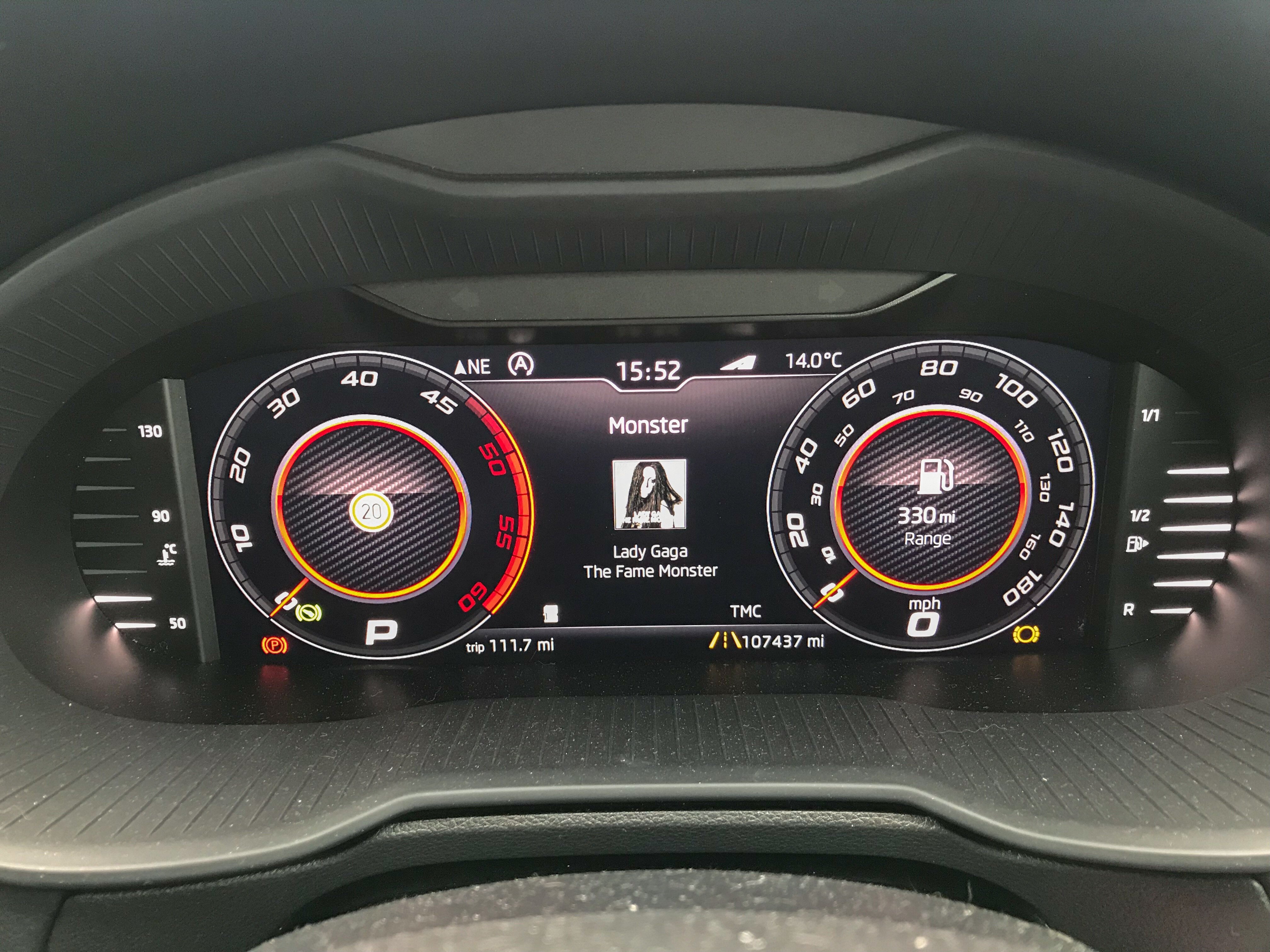

Pictures :)
Version 5, 10 mph increments and 180 mph end.

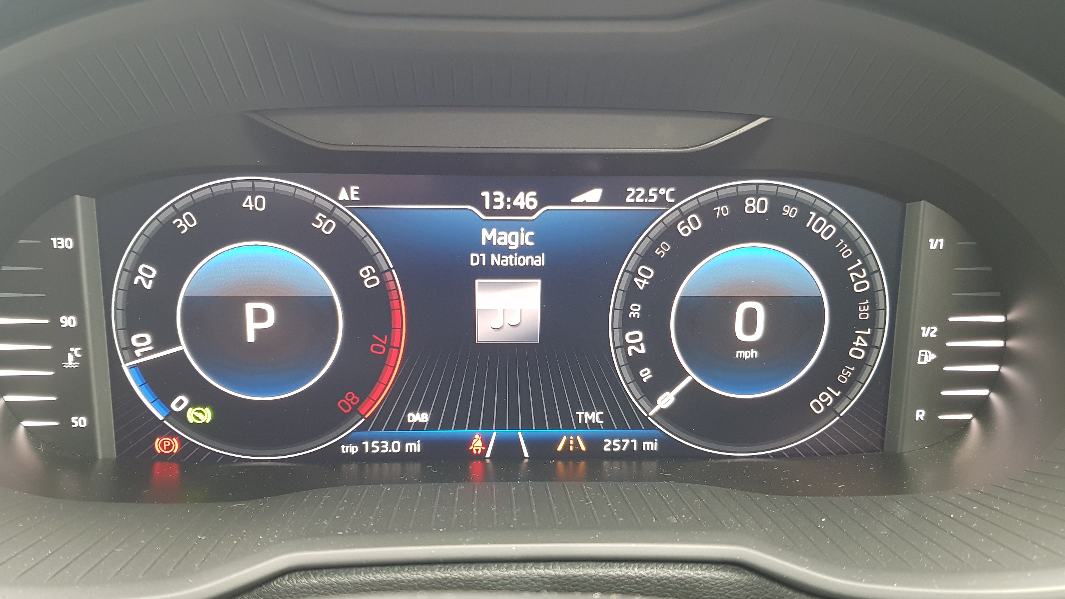

I got a better display
Clean and sharp. 😊
Clean and sharp. 😊
MAGIC.:rofl:
Clean and sharp. 😊
Now that is nice, can you choose any colour, there's no Carbon look.  May I ask please, how did you change it ?
Yeah it's in OBDELEVEN.
Dashboard (Control Unit 17)
Adaptation
Display Depiction
Now I can't remember which version it is. I think it's version 4.
As for colour I don't know how to change it.
This is the regular non vRS display. Was going to recommend this if you are not sold on the vRS font. I need to get my FL BCM in the car so I can get ambient lighting!!!
