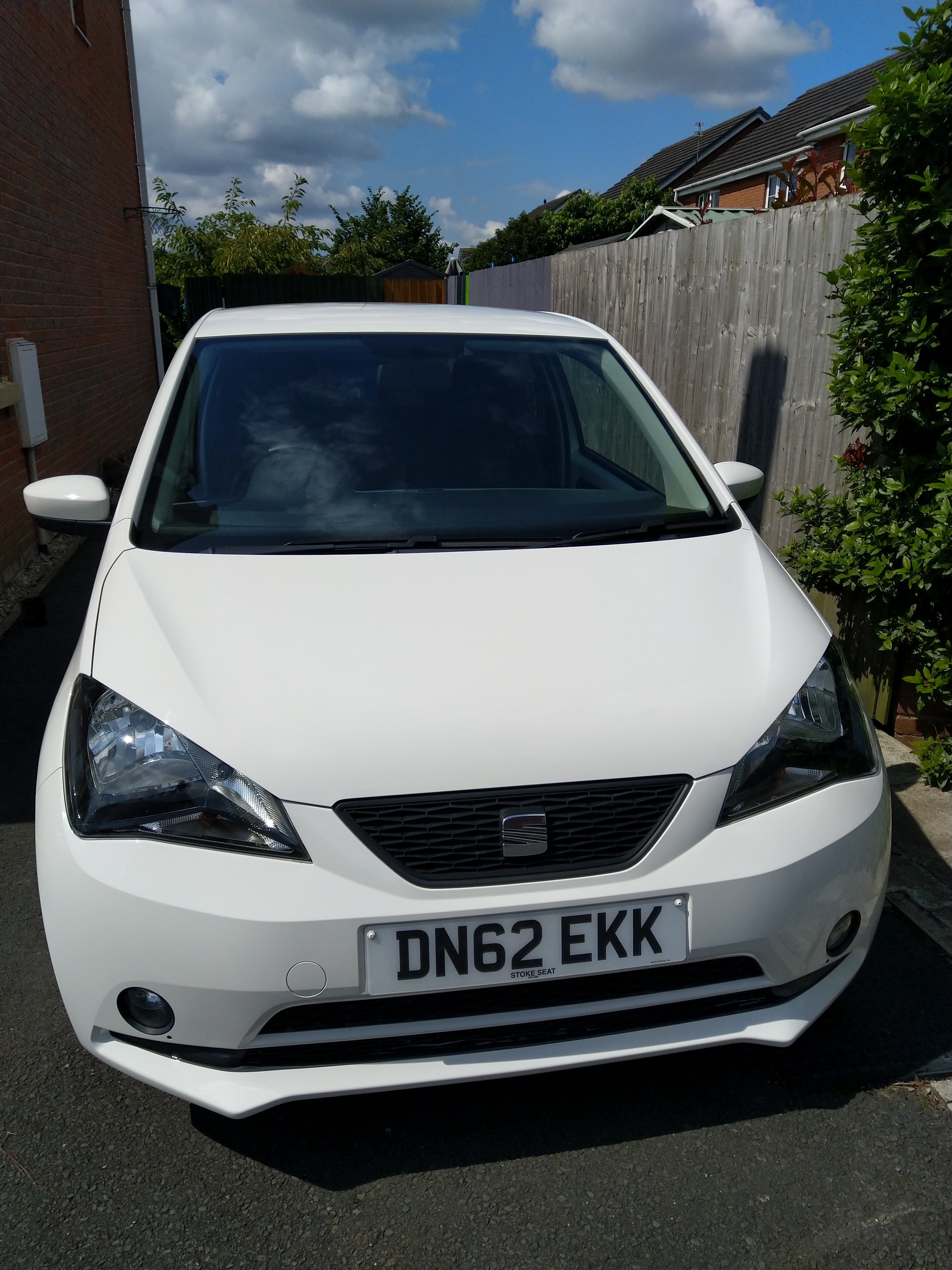

pic of the car, after a good clean..

Your Mii looks a nice car. What better car could you get for 3k? I have a Mii and a Citigo.
