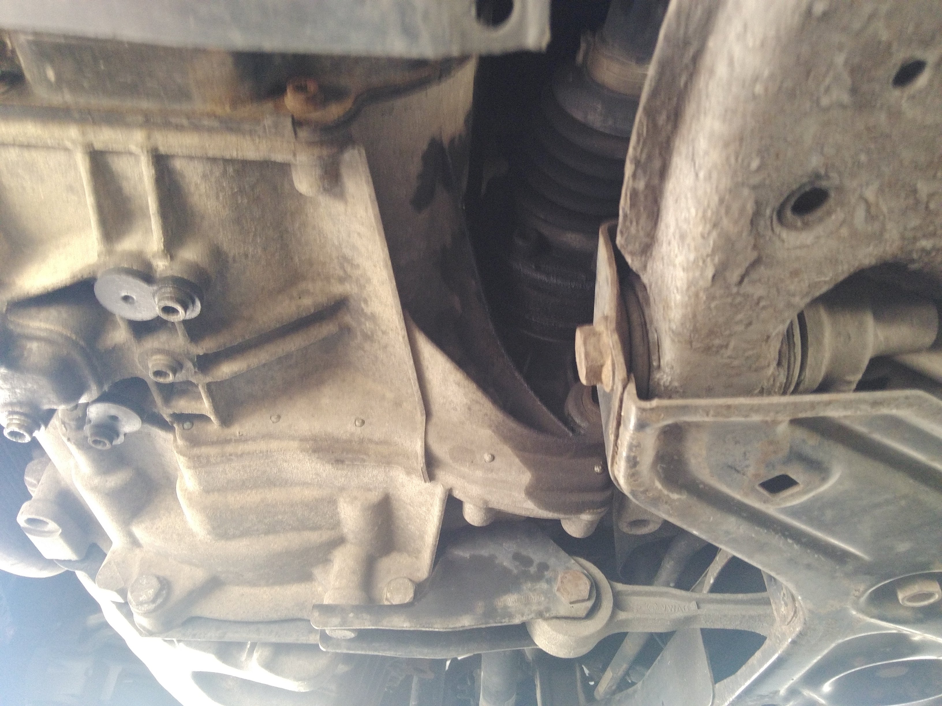

Hi all. All set to change the gearbox oil on my 2002 1.9SDI & hit a problem pretty quickly! Where is the drain plug? I can see the 17mm hex fill/level plug at the rear of the casing, but no obvious drain plug. There are two smaller torx bolts at the lowest point of the gearbox but imagine these are fixing gubbins inside? Some knowledge would be much appreciated. TIA

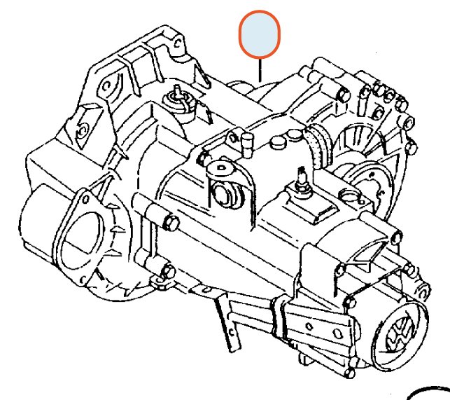

OK that’s the 020 type box.
So something like this

Similar, you can just see the filler hex behind the wishbone bush in this pic
⬆️ I meant to add 'but where's the drain?' 😬

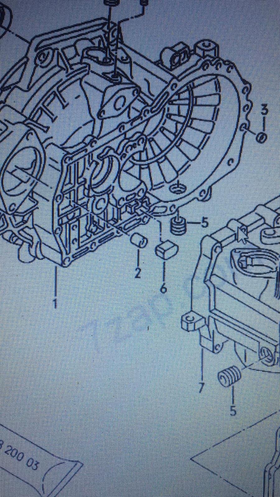

#5 in this pic is the drain plug1112669556_02Drainplug.thumb.jpeg.fce1d526e95c3e9242044e7b2d964f2c.jpeg
Wrong type of gearbox though
That's from the 02* parts listing ??
Yeah, SDI should be using the 001/002 gearbox. You can tell as that picture has the slave on the top.
Edited by Tech1e
The SD ASY engine is listed as havin 02T* gearbox ??
Fair enough. But looking at his photo from under the car clearly isn’t as the parts catalogue is indicating.

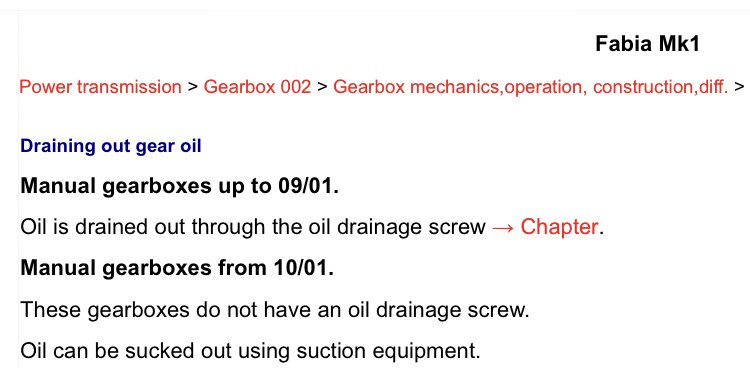

Level bung is on the diff and no drain bung (as per workshop manual).

I changed mine when I first got my Fabia. Had to buy a suction tool as no drain plug on mine either.

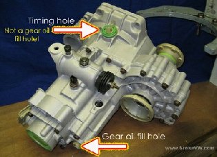

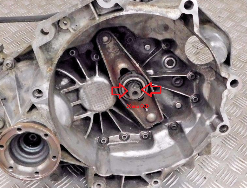

That's the drain plug, fill plug is on opposite (inner) side of diff, a little higher. Just above/behind the right driveshaft.
Can't find my best pictures of it, but it's just partly visible on the extreme left hand edge of this photo. Ignore the red annotation, photo was taken for another purpose.
Better pic (though you can't see the drain plug in this one):
