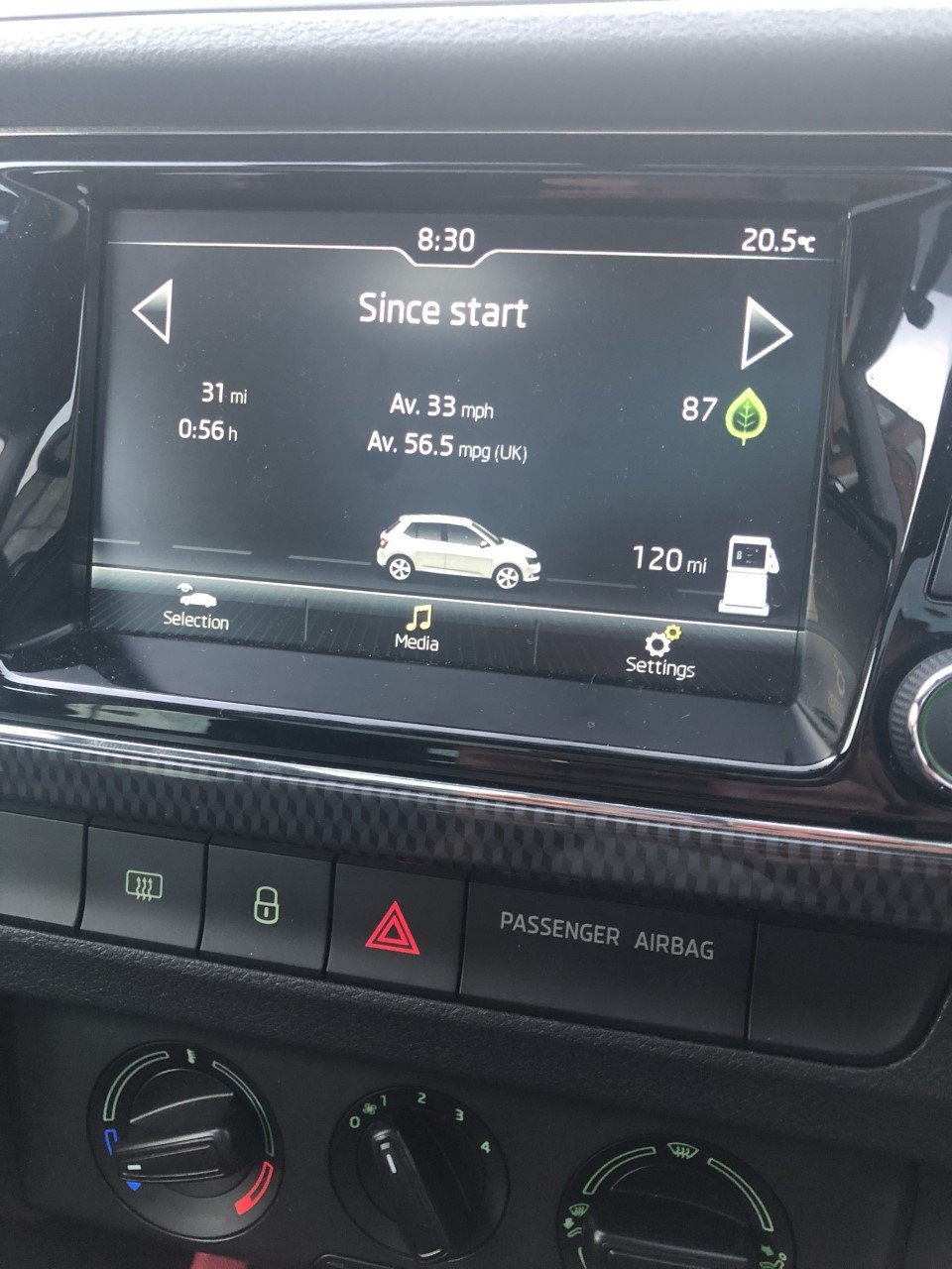

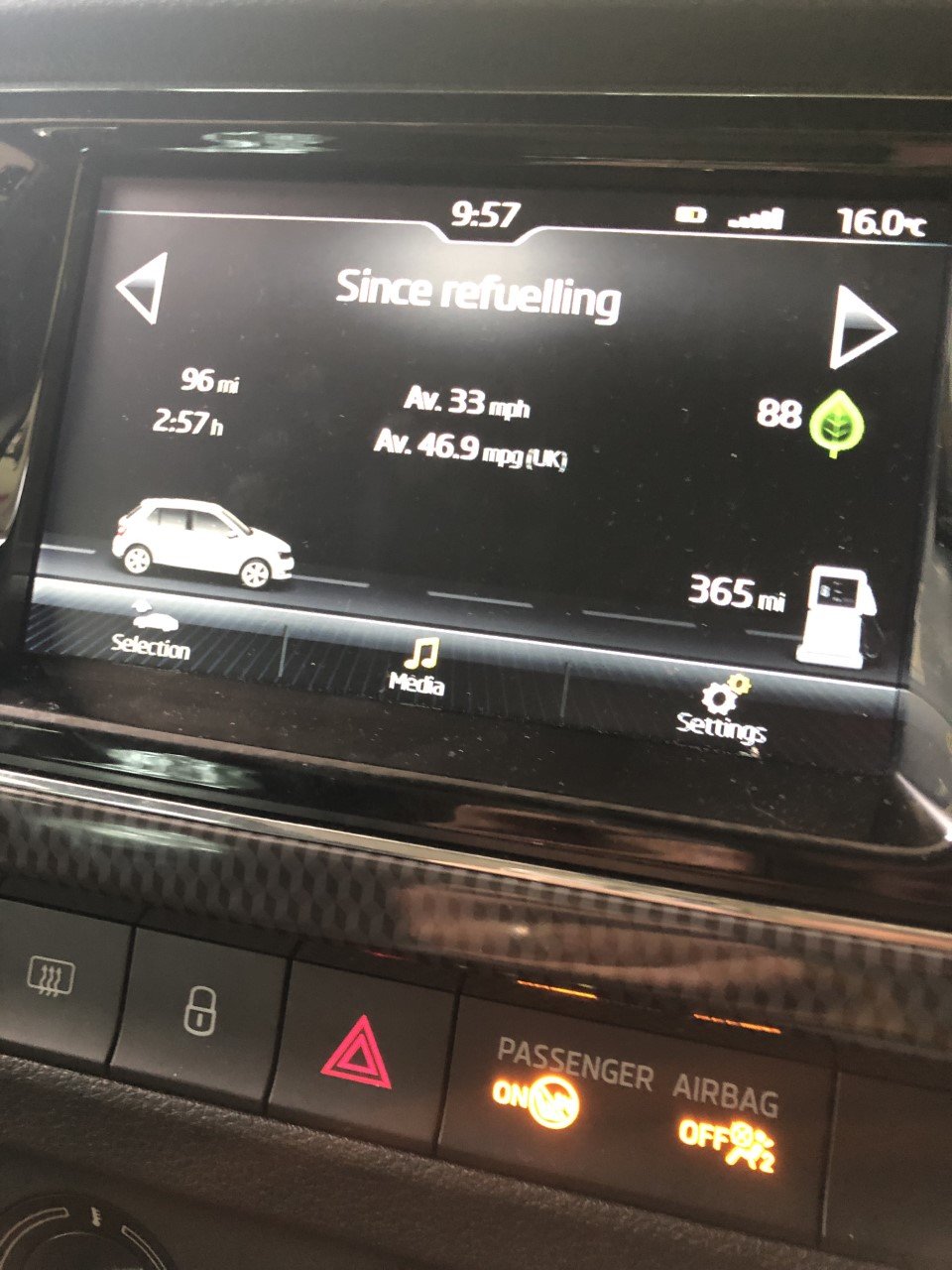

this for me is the difference between v-power and Shell fuel save they are from the same route (Avg speed 33 mph same driving score -/+1 but just less distance , the 56.5 is fuel save.
still not sure why, might be just me getting used to driving the car. going back to v-power soon to confirm it
It'll take a few miles for it to adjust to the new fuel anyway. It listens to the knock sensors and then itll adjust timing accordingly.

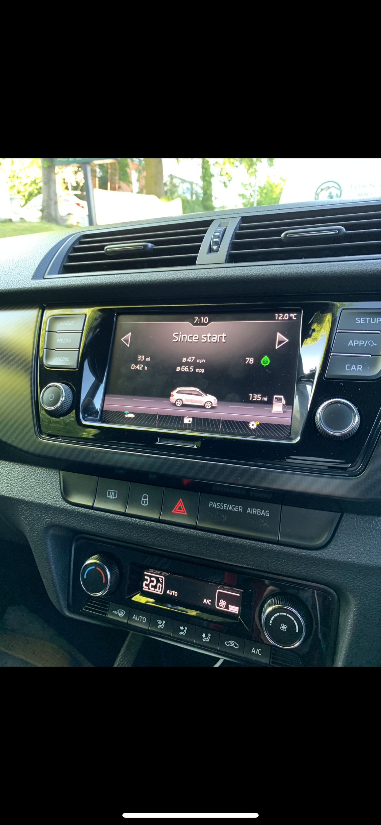

If i drive gently with my 1.2 i can get 50+mpg on short/medium journeys. On long journeys if i follow lorries i can get close to 60mpg, my best so far was 59.5mpg.
This is my normal commute on the 1.0 mapped to 145. Tesco fuel.
wow lol thats nice.! tesco momentum or normal?

Just normal Tesco not found any difference in premium fuel tbh possibly +1mpg but not enough to pay for it. Just a local mobile remapper APR don’t have any maps for mine yet so waiting for that.
