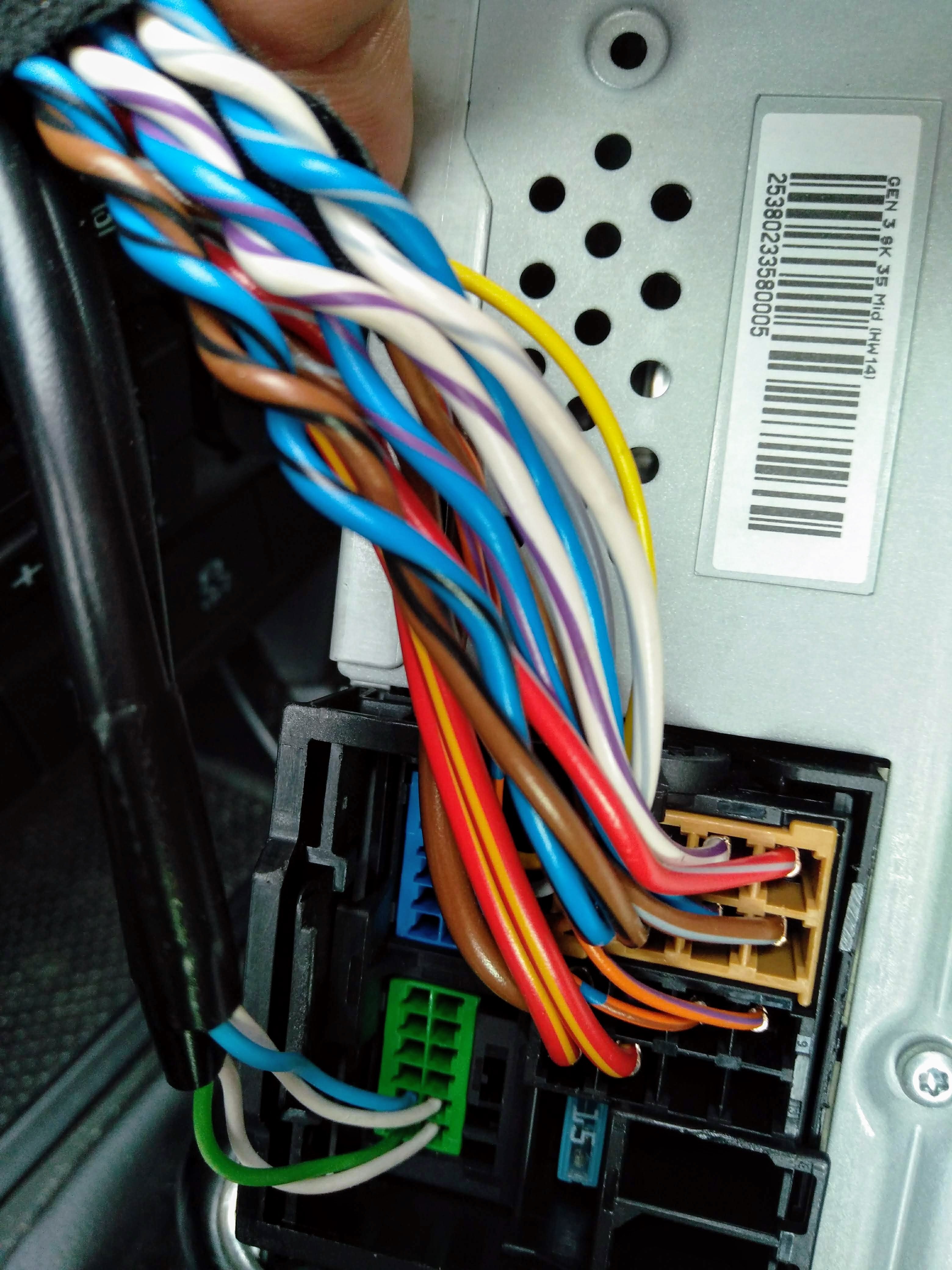

Ok I have a facelift model from '14 so maybe different scenario. Here's the back of the unit - what am I looking at/for here?
langers2k, trying to match your diagram with my pic if the 4 wired pins on the green block are the 5, 6, 11 and 12 you speak of then missing wires are not my problem (sigh)

If you have an AUX socket, I would not expect it to connect to the 4 'Tel' pins. Instead, it should go to the 3 'Aux' pins (1, 2, 7) in section 'B'.
