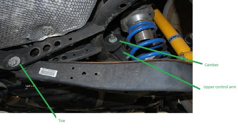

there are two adjusting bolts on the rear one for camber and the other one for toe.  (see pic)
these are the bolts for the rear camber

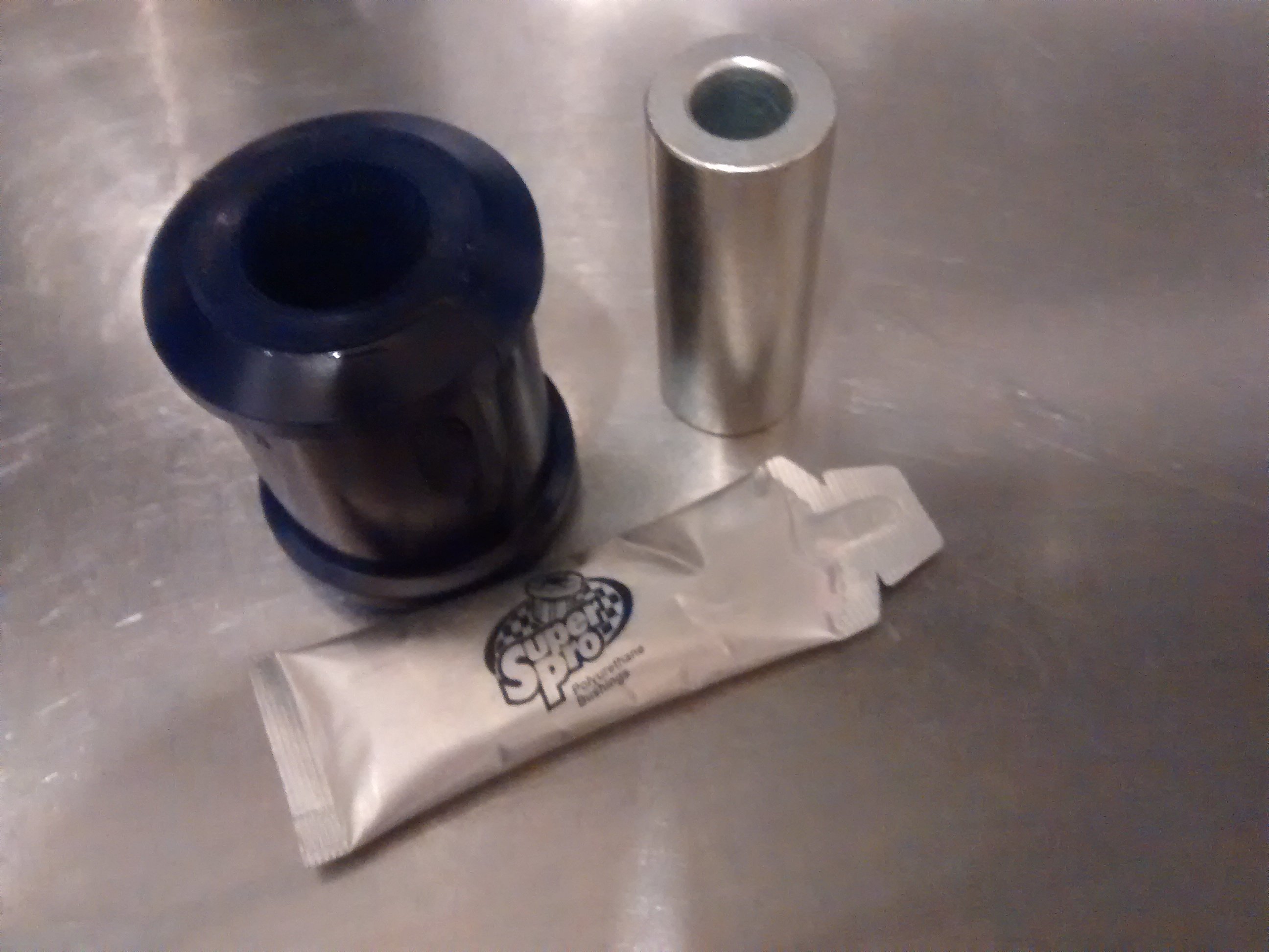

These are the superpro rear toe bushes I'm planning to use as I bought the bushes already but haven't got round to fitting them yet.

No they are different as there are two bolts that secure the lower rear control arm (where the coil spring sits in)
inside adjusting bolt and
https://www.ebay.co.uk/itm/VW-Audi-Lower-Rear-Suspension-Toe-Alignment-Eccentric-Bolt-Nut-Kit-Genuine/183086466988?fits=Plat_Gen%3AMK+V&hash=item2aa0cdc7ac:g:2u8AAOSwtAlbvU7w
outer normal bolt (although you probably get away with re-using the outer bolt - despite VW advising to be replaced each time)
https://www.ebay.co.uk/itm/Genuine-VW-Audi-Rear-Wishbone-Control-Arm-Bolt-Nut-Golf-Jetta-Touran-A3-Q3/183142205020?fits=Plat_Gen%3AMK+V&hash=item2aa420465c:g:WWIAAOSwGvtbpslr
also just to clarify so that you are getting the right parts that the above part numbers are referring to the toe bushes only.  You will need different parts if you are replacing the rear camber bolt and bushes as well.   Here is a link to the toe bushes so you understand what parts I am referring to.

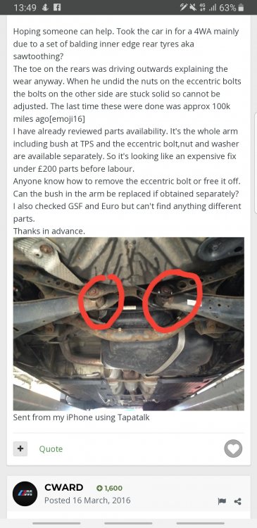

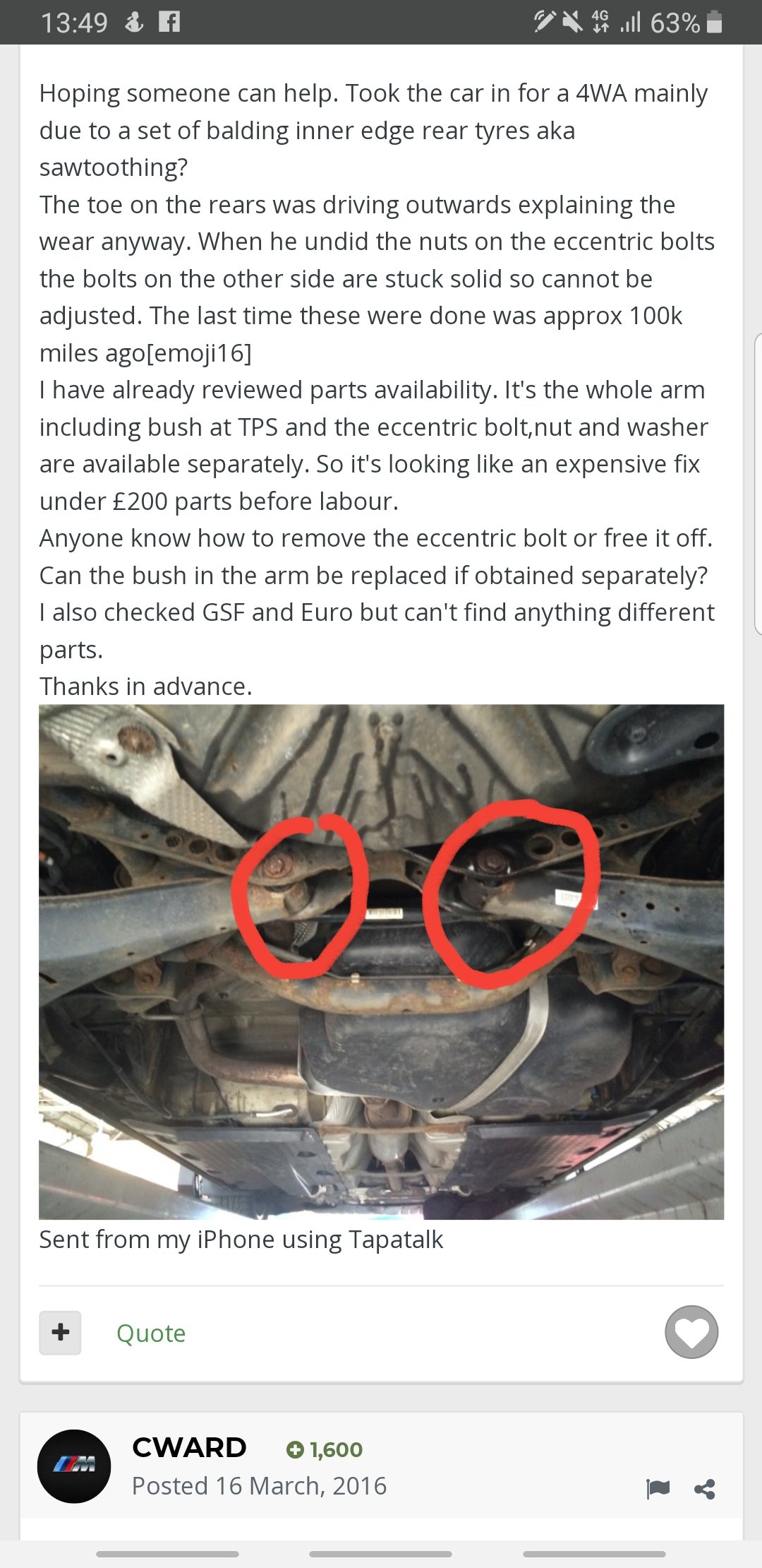

Thanks again, I'm not very familiar with the backend suspensions of the vRS as you can see🤣 I'm just kinda going by what the mechanic told me as well. Its these bits I circled is what I need, i should've taken a pic tbh lol. The camber bolt and bushings in it.

No probs, yep the parts I've list are correct for replacing the parts you have circled in red.

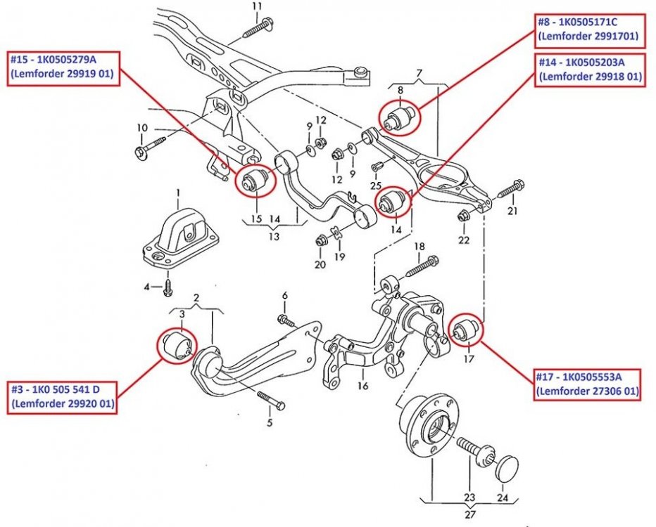

Hello, thanks for all the help so far, anyone know the what the bush is required for the bolt labeled camber in this pic?
