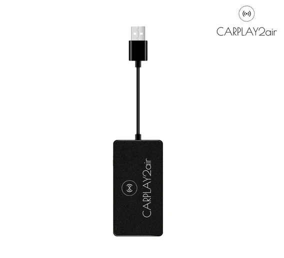

This one is for wireless apple carplay in Skoda
I got this one for my Kodiaq, and it works great.

I love Carplay and use it for Google Maps on most journeys so I'm delighted such a gadget exists but for £124 I think I'll be plugging in a cable for a while yet.
How reliable is the connection and does it support all the Apps/features you get with a wired connection?
I presume your iPhone connects to this dongle via WiFi and not Bluetooth due to bandwidth required.

Hi Winston_Wolf
It works great.
It uses a WIFI connection, and it connects shortly after the car is startet.
The connection is very stabil.
I can use all Apps, like wenn you are using a cable.
Pity there is no such thing for Android phones.
