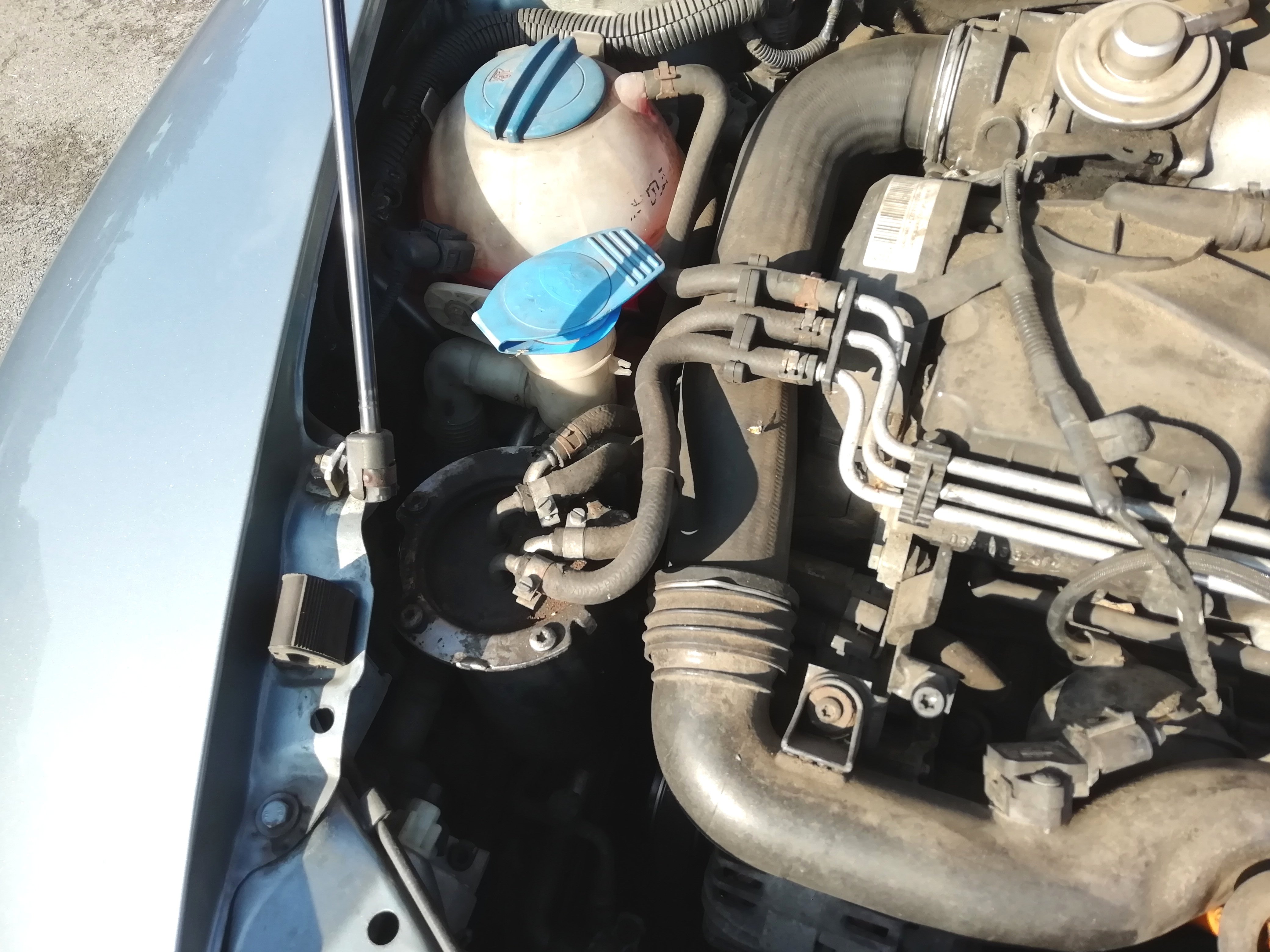

I think I'll run a can of Liqui Moli Diesel Purge through the system.
Am I right in thinking the bottom two pipes on top of the fuel filter housing are what go in the can, and the top 2 connect together to send the fuel from the pump back to the tank?
I've got no idea about the fuel filter I usually just stick my injector cleaner or fuel booster into the tank
So a few months later, I'm still getting poor MPG.
I ran a can of Liqui Moli Diesel Purge by bypassing the fuel filter, and that seems to have cured the smoke on cold start however.
