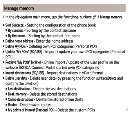

This is what the manual says:
I haven't tried it, so don't know whether it works or not, but it seems if you go into the navigation menu, press "manage memory" then "delete user data / dest memory" it will get rid of everything. I seem to remember deleting individual destinations when I got mine 18 months ago (ex-demo like yours), but I'm blowed if I can remember how. Good luck with it.
