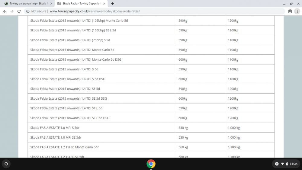

Do you think spring assisters would be a good idea on the rear?

The caravan would leave you with no payload i.e no, clothes, chairs, awning, bedding, water carrier, waste carrier almost all the paraphernalia that a caravanner carries.
