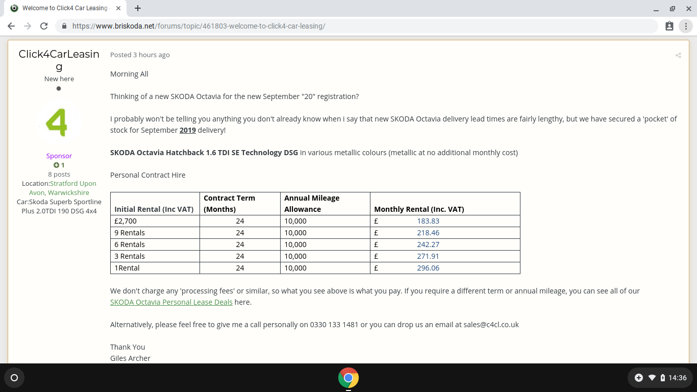

Might interest anyone looking to get a new 1.6TDI.
A '20' reg in September? :blink:
They will just be in the car trade, why would they know about a '69'?
