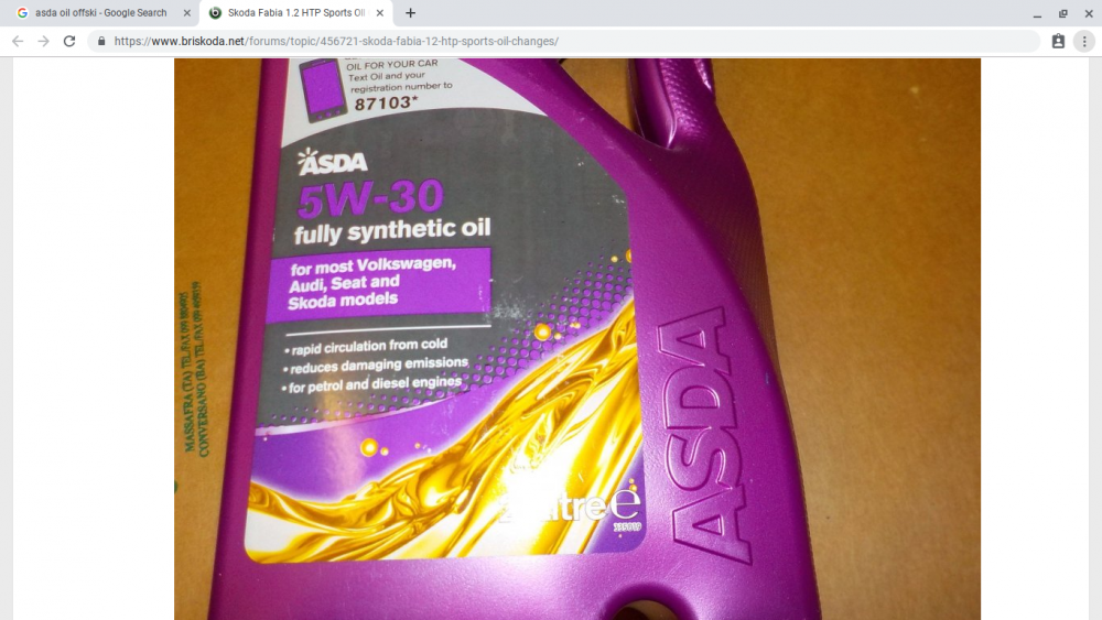

Go into ASDA and buy the 5w 30 FF III that they sell that does 'meet VW507 00 spec'.  It says so on the container.
*Read the spec to see that your car / engine is among the 'most' that is written on the front panel.*
