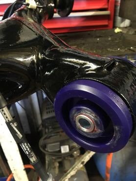

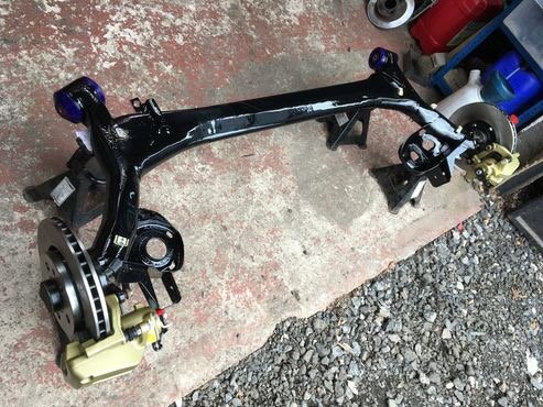

Jst dropd off my fabia at a mate,s garage to get some powerflex bushes fitted on the rear beam. Eny body fitted a set or have pictures/guide how to fit them

Thanx all for your replies bushes fitted took about 3 hrs in all. I did use the guide recomended on here.  Car is a little more precise on the road but my original bushes had obvious signs ov wear.
