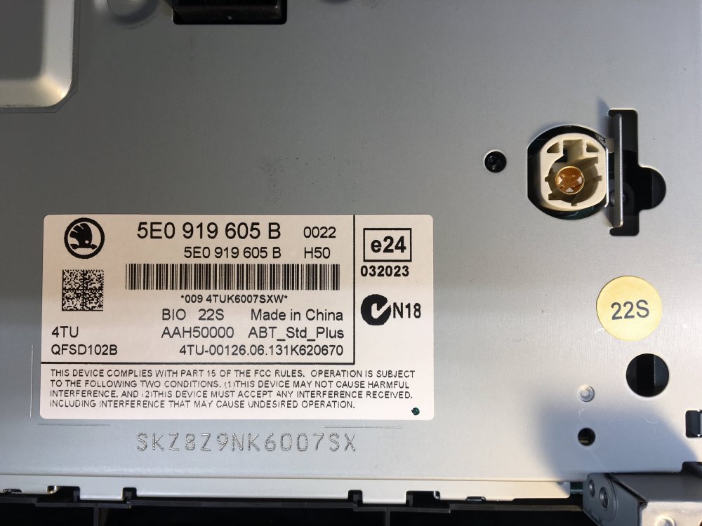

[email protected] cost for rework depends on which radio it is and what needs doing. The latest MIB2.5 can replace a MIB1 with ease but it really depends how much you want to spend. Rework can be anything from £180-400 odd depending on the radio. The SIM card provides 4G LTE WiFi in the car which will be useful for some but I’ve only used it a couple of times.

Depends on what you want, I would go MIB2 if you want to spend as little as you can and still run SmartLink or an 8 inch screen. It doesn’t have to be a Skoda unit but the rework cost to flash Skoda software is very expensive, the Skoda units are usually cheapest anyway.

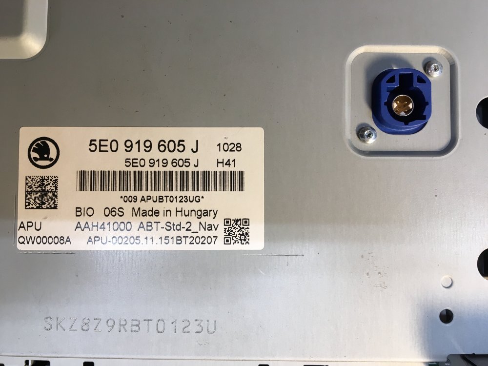

And pawel could get CarPlay on it ? 😉
Yes. Screen choices are 6.5 inch screen (5E0919605J) 8 inch PFL Columbus (5E0919606) and 8 inch FL Amundsen (5E0919605M) and you will need a new USB (5Q0035726E).
With my existing having mdi instead of USB - will I need to replace harness ?
