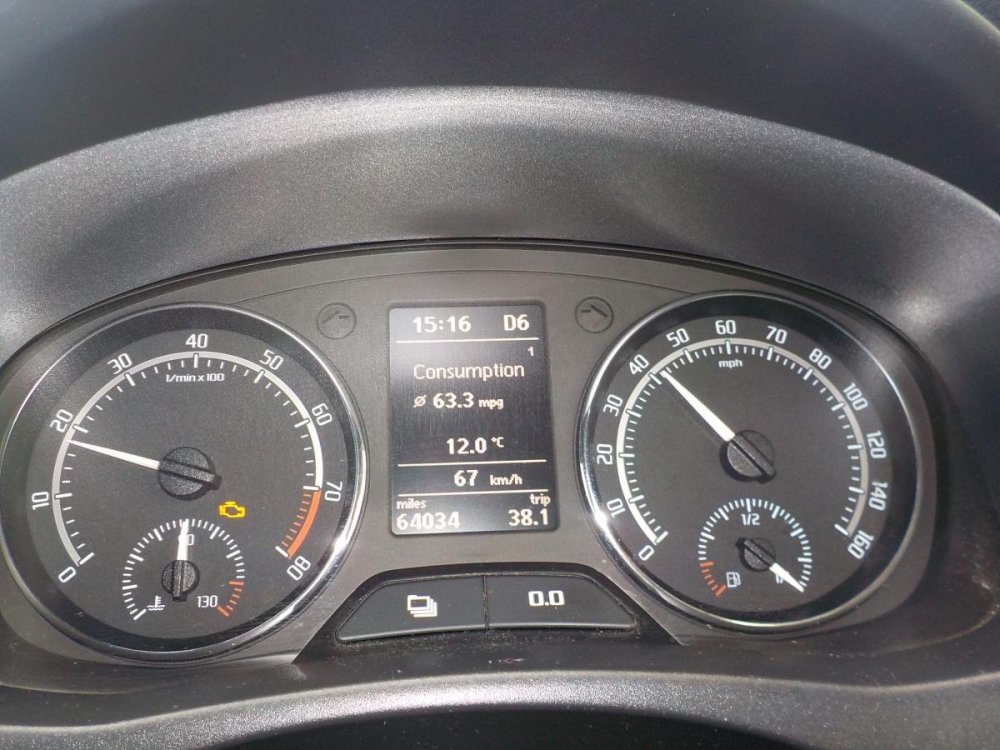

Hello people I’ve recently just brought a Skoda fabia vrs 2010 180 dsg and the last couple of days the engine warning light has came on. It’s only got 51k on the clock but the weird thing was I just filled it up with fuel and was driving at 30 mph down my road and it started juddering and the engine warning light started flashing. Has anyone else had this issue or is my car just a dud. Please help me

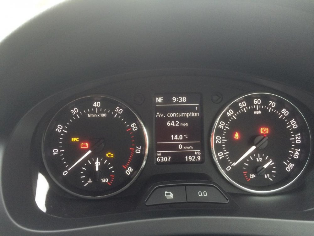

I did once get bad Super Unleaded at a Sainsburys and it was about 8 miles later engine coughed and i was booting hard it and it went into limp mode,
both warning lights on, engine and EPC and the turbo disabled and i was very near having a brown trouser moment as in the outside lane and moving quite quickly..

Just found this in the boot and it seems to be misfiring from when I was standing behind listening to the exhaust and I can feel it every now and then when sat in the car. It’s upsetting because I love this little car and only just got it lol
