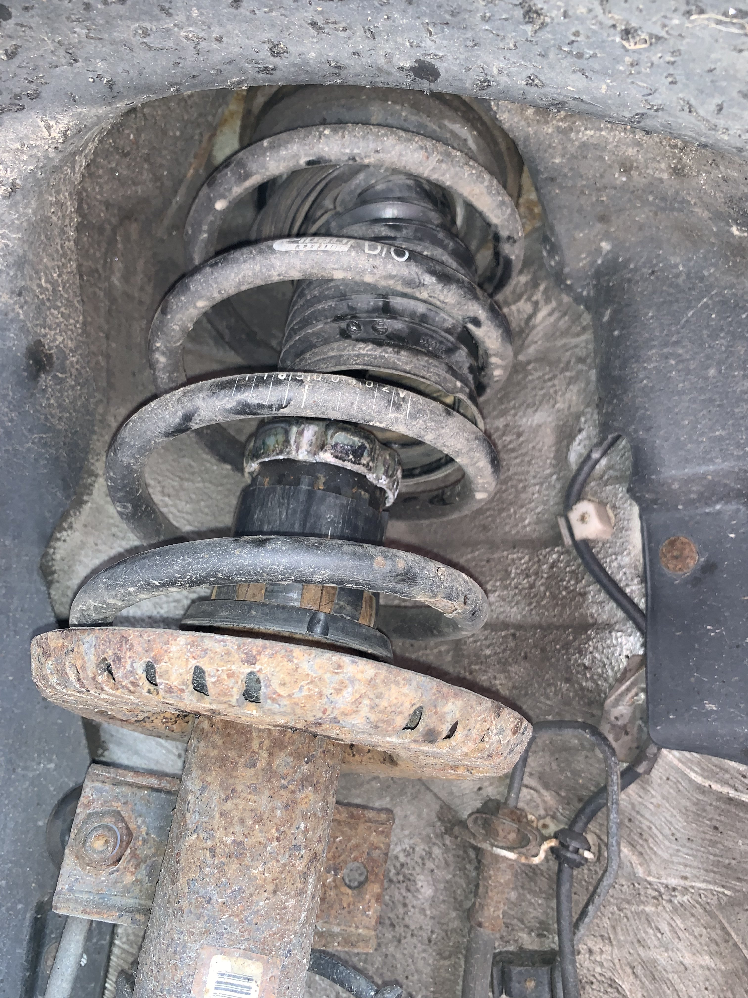

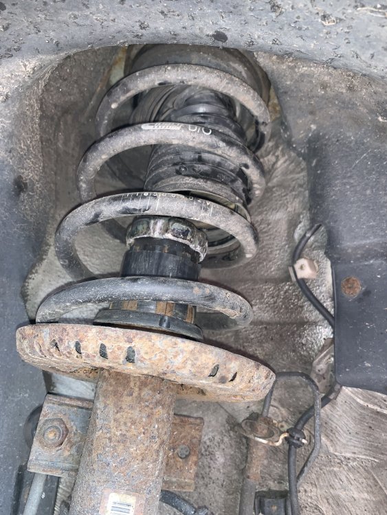

On the other hand, is the top of the spring broken in your second picture? Something looks amiss.
The shock boot is twisted and torn.
  • Sponsor
Caused by?
42 minutes ago, Wino said:
Caused by?
Probably the missing bit of coil spring you mentioned, tore it up as it exited the strut.
Yeah that spring looks busted.
No wonder the steering is horrible, luckily the OP takes good photos but it's a shame he has his eyes shut while doing it.
Last time it happened to me I heard the piece of spring hit the underside of the car as it bounced off, sounded like a gunshot at 70 mph.
Mine sounded like a spanner hitting the road but I was only doing about 20mph when it fell out.
