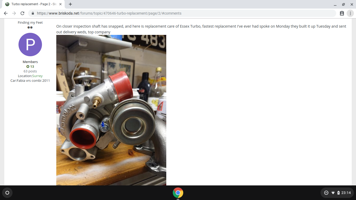

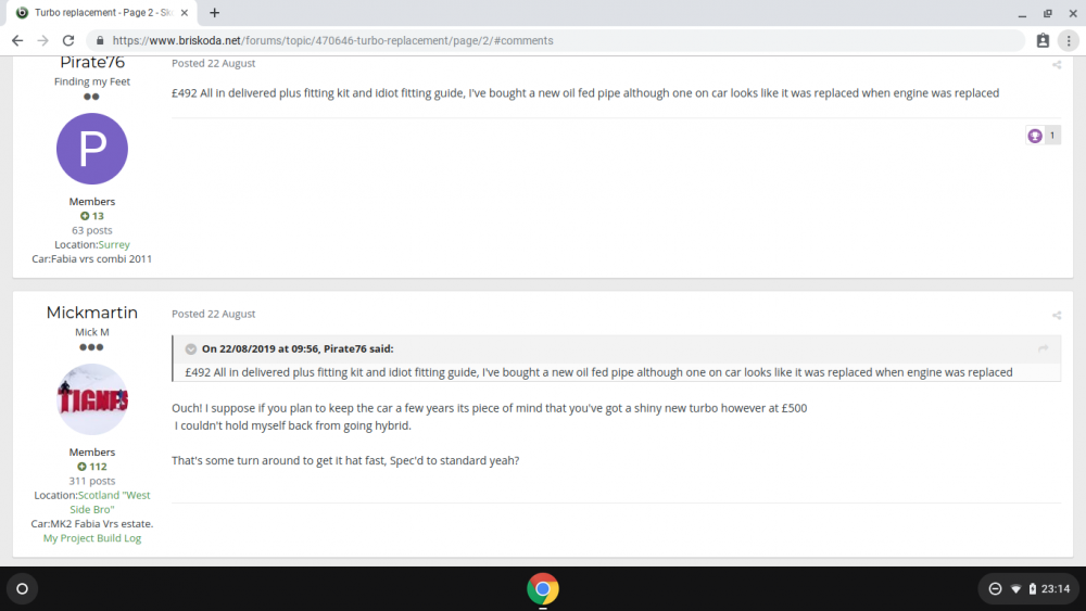

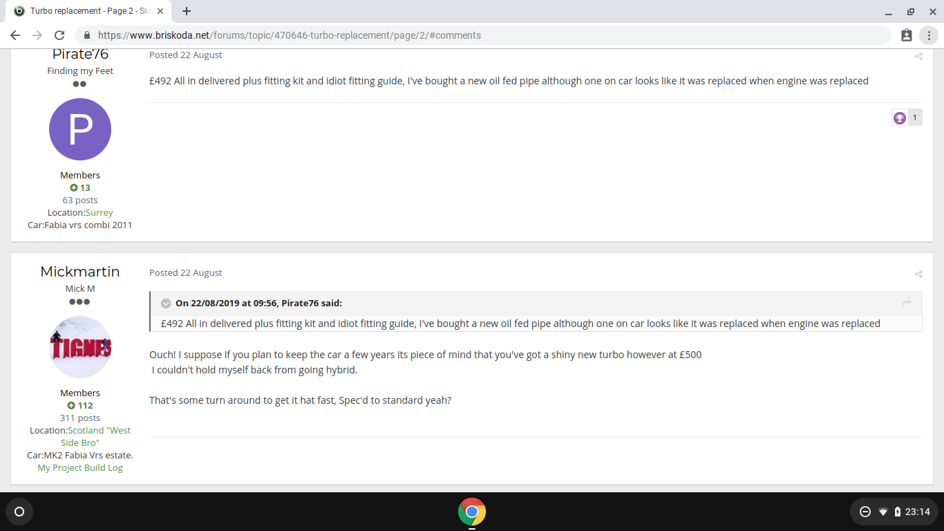

This is a different engine needing a turbo, a 1.4 TSI Twincharger with 180 ps.  £492.
Obviously not from VW / Skoda with a 2 year warranty but then not everyone needs that.
1.2TSI's with actuator faults can just have an actuator with needing a complete Turbo & actuator, but many Dealerships will not tell a customer that.
