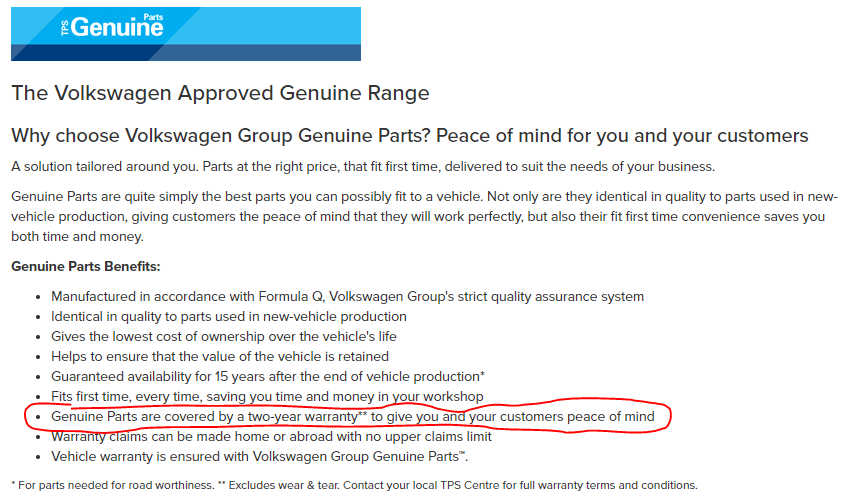

Back in January the car went in for cambelt kit and water pump change. Also asked for the auxiliary belt to be done, genuine parts used from TPS who are owned by VW so they have to fix it. How long I shall be without wheels I don't know. Tis damned annoying though. My first breakdown in 15 years!

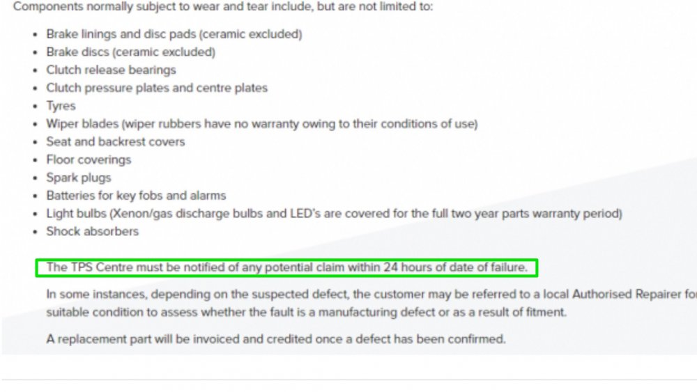

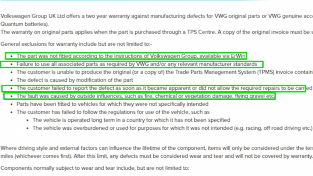

Done some homework. TPS who supplied the parts owned by VW UK. Warranty process means the car has to go to Fish Bros Skoda in Swindon for assessment. The fact I used an independent garage doesn't matter. There is a law called the Block Exemption which means that even if you use an independent rather than a dealer and if the same standards are used, trained technicians and methods; then there is no wriggling out of a warranty if things go wrong. Trouble is, I still have doubts.

Just been told and the answer was of no surprise. Independent garage fitted the parts so they must have been fitted wrongly even though in 6 months I drove 5,000 miles!
My indie garage is obviously disputing this as it was a VW trained master tech who fitted it and back in 2016/7 as well?
