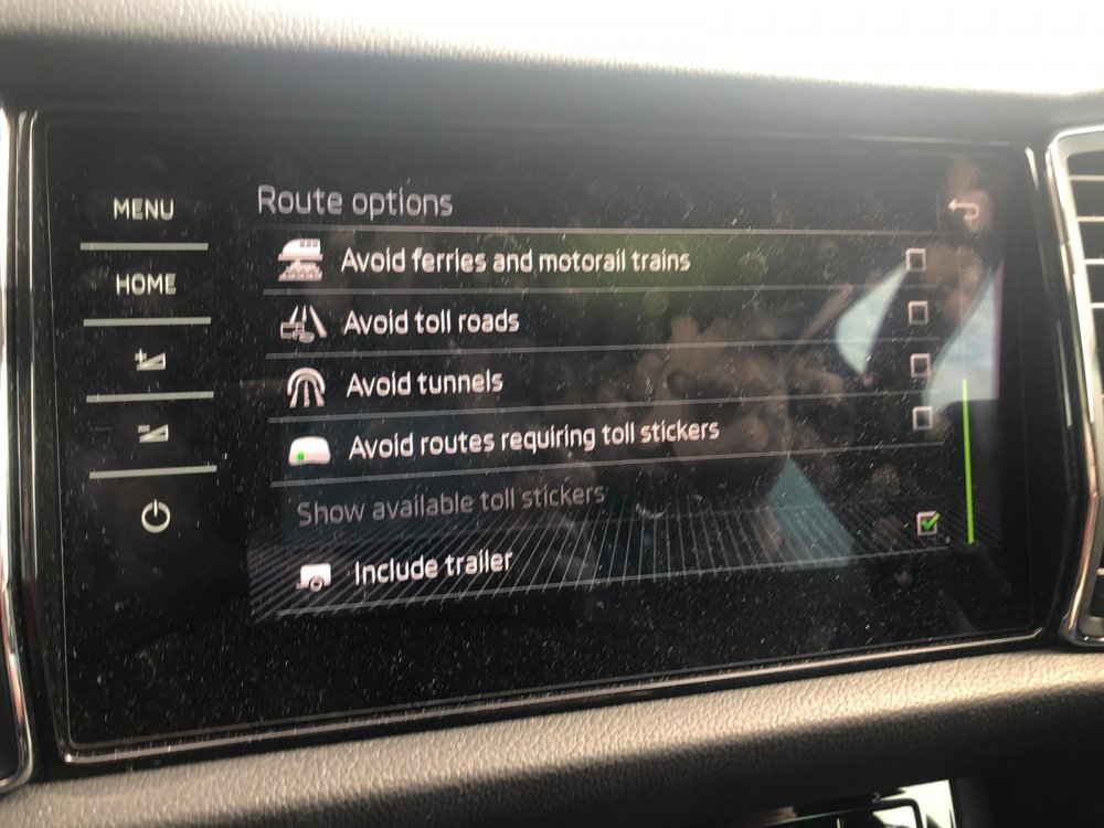

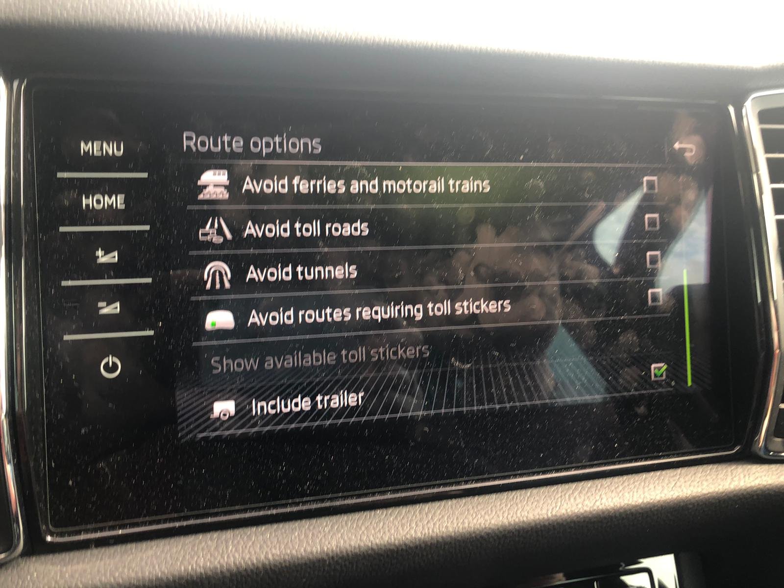

Plus it automatically enables Trailer Mode in the route planning if satellite navigation is fitted...
