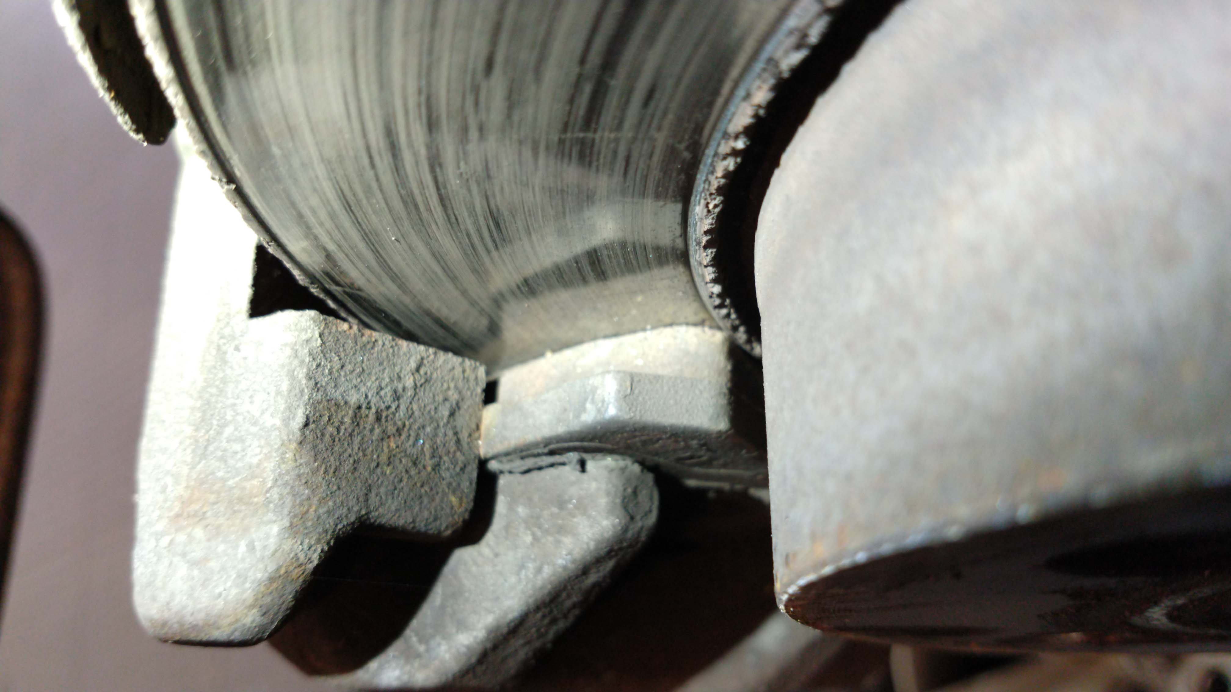

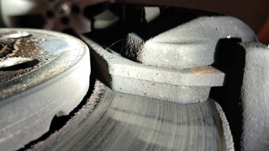

Ok, done me usual pre winter check.
Fitted new front tyres at 58k miles, they were fitted at 27k miles, with rear tyres down to 5 mm. Tyres rotated.
Front brake pads at 8 mm and rear pads at 7mm, with all brakes stripped, cleaned and regreased.
All disk faces are clean, flat and have no rust spots/patches high points. All are original brake parts.
A small rusty lip has started. Photos are before the strip down.
First photo is front and second is rear.
So I should wear them out in about another 5 1/2 years 58kmiles time.
Thanks, AF Falco
