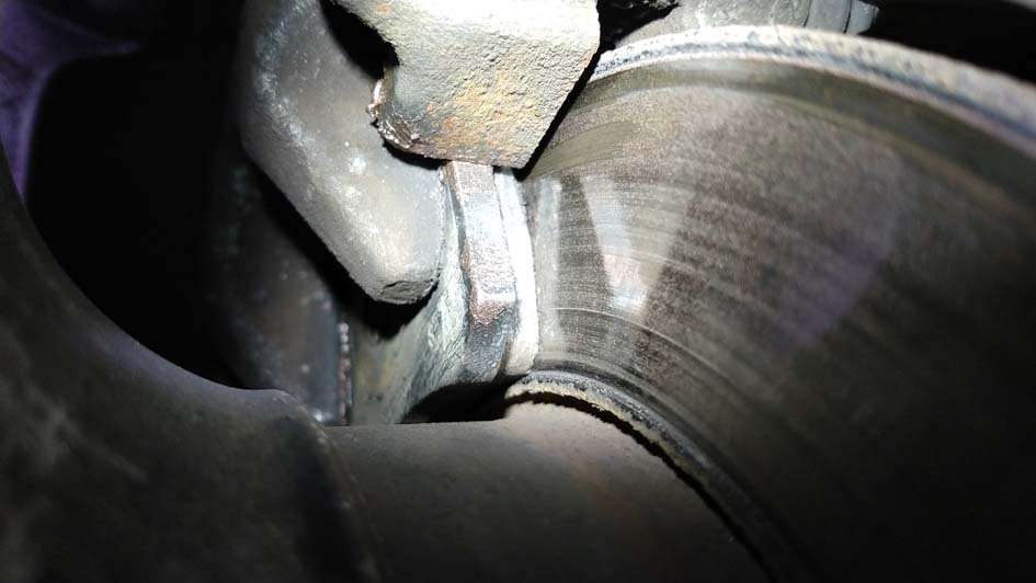

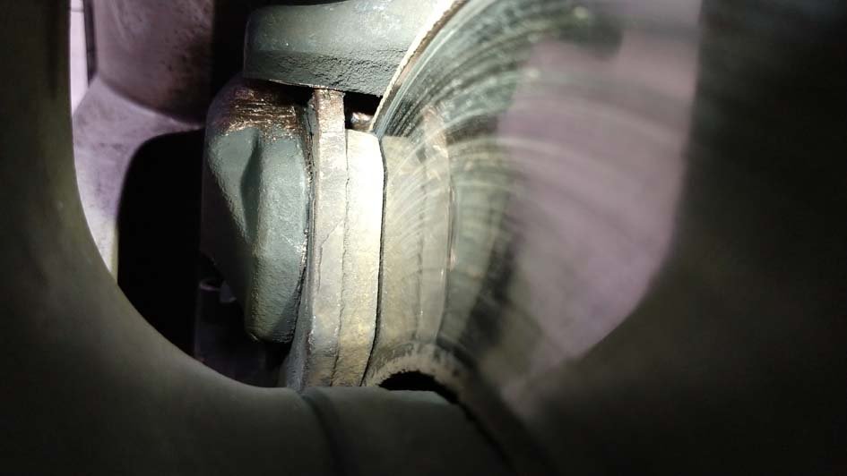

All brakes at 68K and are still original from new from 2016.
Front brake pads at 6 mm and rear pads at 5mm, with all brakes stripped, cleaned and regreased.
All disk faces are clean, flat and have no rust spots/patches high points. All are original brake parts.
A small rusty lip has started. Photos are after the strip down.
First photo is front and second is rear.
So brakes are about half worn. 😲
Car still good.
Thanks, AG Falco

More effort than I'd give the car, and great longevity, well done.
Just for info perhaps, If that's copper grease it's no longer recommended for (modern) brakes.
Edited by nta16
ETA: Please note - I am not a mechanic or expert in anything.
 Keep away from any rubber boots / seals.
Thanks, AG Falco
