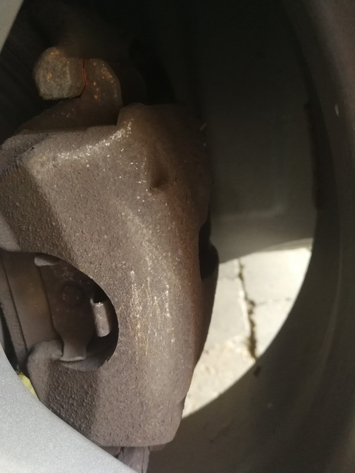

I really can't see anything casted.
On the other hand, I am now pretty sure it's the 256mm based on a quick measurement so the FS111 must be somewhere behind all the dirt 😉

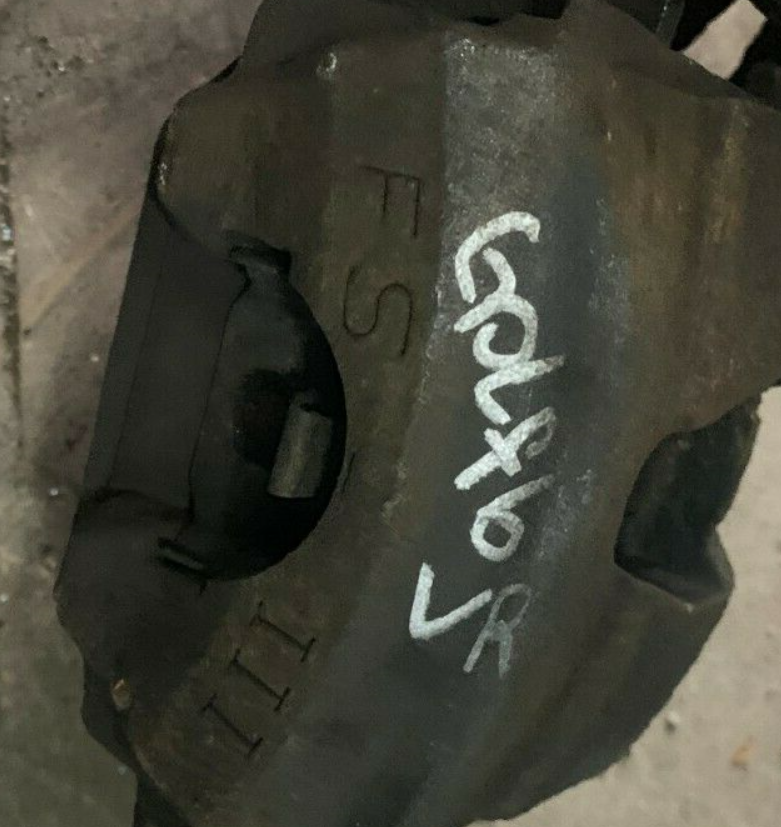

That's odd, it's usually really clear, like this.
Looks a bit different where two of the outer pad clips sit too?

They look to be very close to being FS111, and the pads and carrier certainly look like that type of front brake set up.
