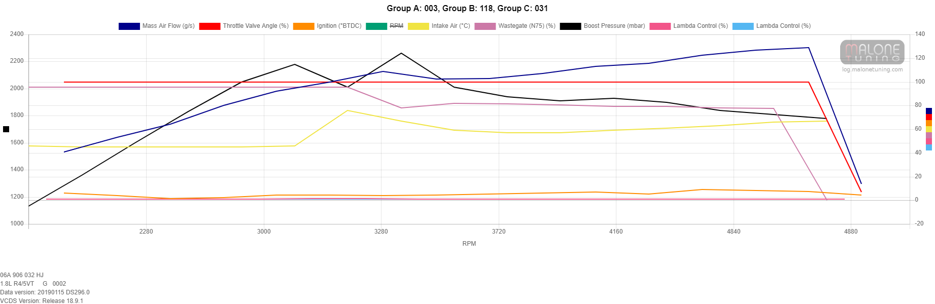

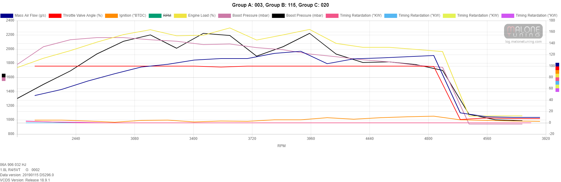

Logs -
https://log.malonetuning.com/chart/261485#H8KLCABfZHNdAgNNwozDgQ7DgiAQRMO%2FwoXDs8KSFG3Con4Lw6HCgMKywqHCm1RowpbDhVTCv17CoMKJw7E4M2%2FCnsK1w6rCkcKfd0rCqCPDp8K6FQXCk8KDXsKuwpnDqcKDLcKCworCmMKQwr3CoDrClsO0QhYtWcOvw5rDr8OUH8OHZ8KhwoA6eMOxBcKlwpdnEMKuw5gXH8KCfsO%2FYMOFFBcZwrJGw74NdgIDM8Kcw6ACV8K4woFpVmUGw6fCq8OkwrLCrTTCvGZ2w64LWQJuTsK4AAAA
https://log.malonetuning.com/chart/261486#H8KLCABfZHNdAgNtwo5BCsKDMBBFw68yw6sJJGppw68SwrJIwpshBjTCkXEUw5vDk1cjFBddw457w79%2Fw4ZaYBrDi0oqeMOxMwlgwoPCrcODf8K4OcOwwqvCjMOPwpRJRS7DizQDw6oTDsKFw5PCh8O2EyFSJsO2QnDCmsK8EsKLwpLCojbDpcK3dDTDjk7Cn8OCZV1jwovDggsdw4bCh8Kgw57CvzBwworCvcOUwrE9eRFWwqPDgRvDnsOxwrHDv8OWOQRTQ37CkTJPQ8KqwqPCpnPDrgvCjCEkc8OjAAAA

Looks like you're overboosting - do you have a standard downpipe?
MAF reading looks to low for a tuned car.
So after new plugs and coils you still get a big bang from the front?
New plugs and coils - big bang continues. Replaced the MAF with a brand new Bosch unit. I am running the standard downpipe.
Can you check your water temperature reading via vag-com?
Also your intake temps are way too high if you ask me. From what i know above 50 celsius computer pulls back timing and boost.
It was really hot outside when I did the logging. Today I checked what VCDS showed prior to trying to start the car - the outside temp was around 12 degrees. The coolant and intake air temp both showed 18 and the Throttle Valve Angle was at 4.7 %. When the car failed to start on the first attempt, the coolant temp value stayed at 18, the intake dropped to 12 and the TVA went to 0.4 %. On the second attempt the car started perfectly.
