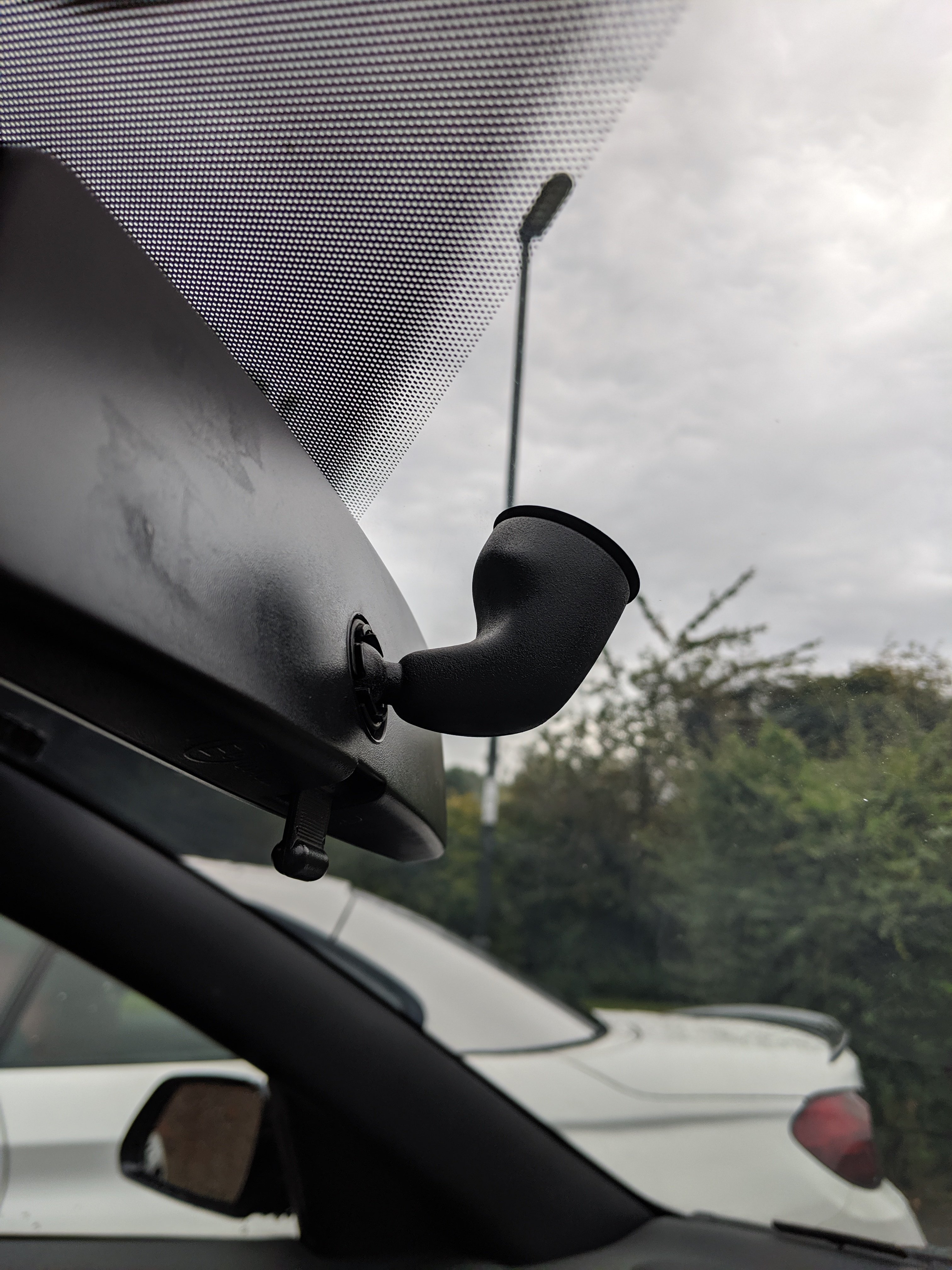

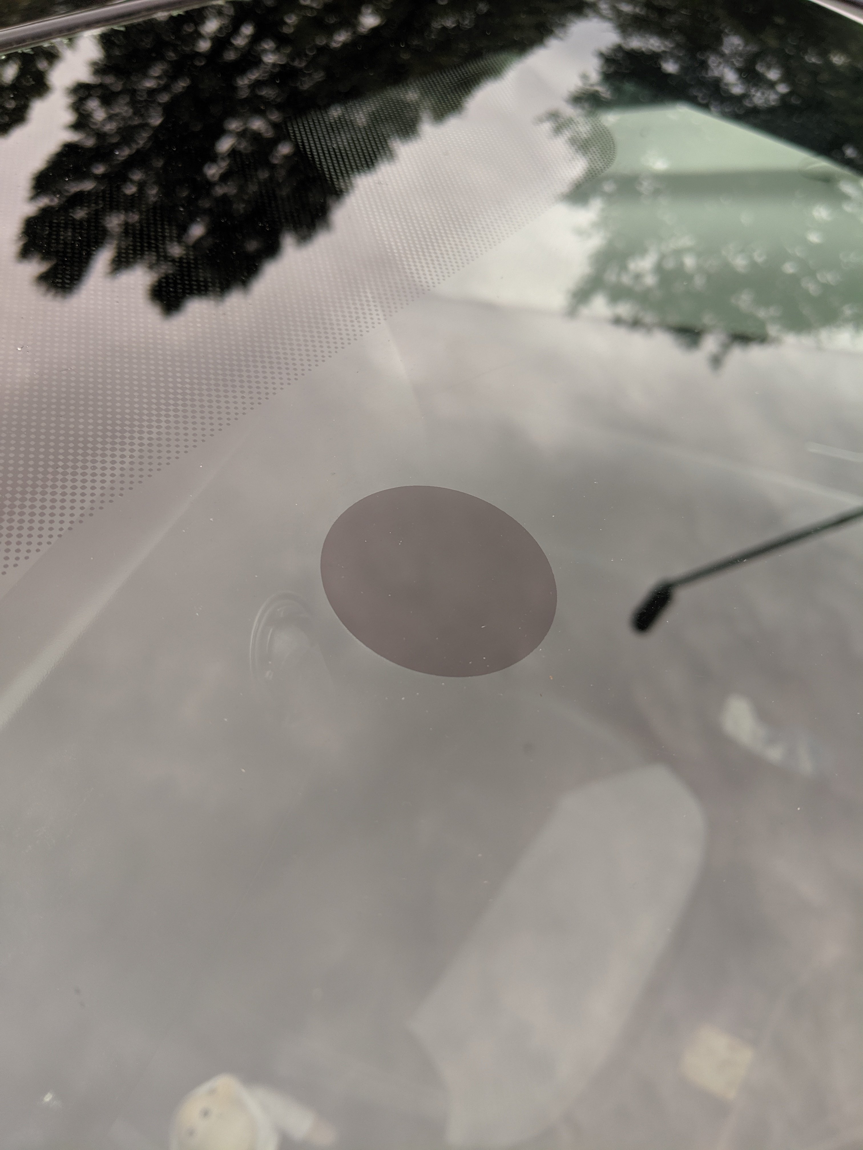

So I played around with it, and still the same problem. I'm not sure I have auto wipers. Doesn't look like there's any sensors.
No, you don't have a rain sensor on the screen.
Intermittent operation is manual using the same controls but the timing is fixed for each of the positions - or on your early car you may not have the 3 position switch.
I would try spraying contact cleaner (NOT WD40) into the gaps around the three position switch as others have used this fix for poor contact effects on both stalks. Some have gently opened up the left stalk to get better access but not sure about the right stalk.
If your car doesn't have the 3 position switch and thus only one intermittent speed, then you may have to replace the right hand stalk assembly.
