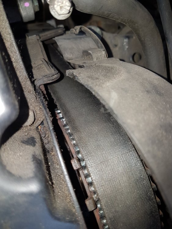

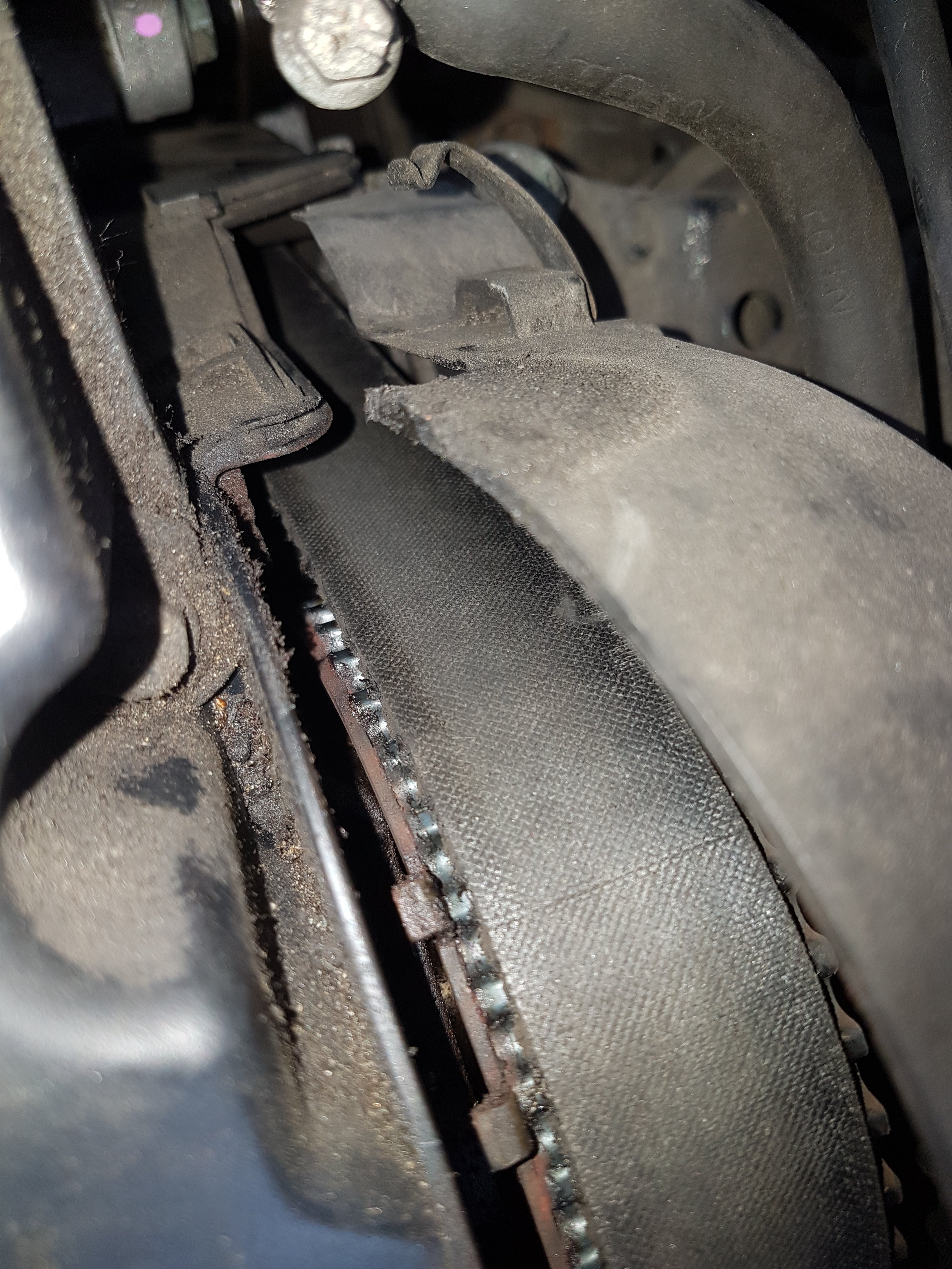

So I did a visual inspection this weekend, to know if I should really replace it.
And I really don't know...
Could you tell me what you think about it?
Is it clearly about to crack?
It seems really "gummy" but no tears.
Keep in mind that the car has a lot of weak points, like the clutch becoming a little weak, expensive to repair, that's why I did not do it, and won't if it could keep up for 2 years.
Thank you :-)

Forgot to say : no weird noises or anything coming from the timing belt. Everything turns fine.
It seems well aligned anyway, perhaps without tears, but this "gummy" condition makes me wonder.

I'd get some quotes from some local garages and see what the best price is.
Then balance that cost against what it would cost to buy a replacement engine or vehicle quickly if it did strip some teeth and damage the engine beyond repair.
Unless it is really obviously cracked it is very difficult to accurately asses the condition of a cambelt. The fact it is way past it's recommended interval I would say replace it.
It looks horrible, replace it.
just drive it until it goes bang, the car is worth almost nothing so just drive till destruction I say
Quote
In money terms perhaps but think what would happen right now if you took your carkeys and flushed them. How would your next few days go? Probably be seriously difficult but on the other hand if you were thinking of buying a new car this weekend then not a problem.
Timing belt is on its last legs.  Change it.

Cost of the cambelt vs changing the car
The value of a car is in it's utility, not what salesmen tell you it's worth in order to persuade you to spend your hard earned money on a 'better' car!

Could this timing belt keep doing its job for one or 2 more years? Did you already replace belts which were much more worn out?
Perhaps someone already left a belt in his 1.9 TDI for 300 000 km? :D
Can I test it? I saw some guys saying to pinch it a little bit, and see how it reacts (should leave a little mark for a few seconds).
It sure looks awful. The "gummy" look could indicate that it will not break apart, but perhaps loose some teeth first? Making huge noise, and then I would "just" have time to shut the engine down immediatly?

timing belt goes you have no time, it is game over.
with the list of faults you are describing and at 400k km's I wouldn't throw another fiver at it personally, I would drive it until it goes boom
I agree, drive it into the ground.
