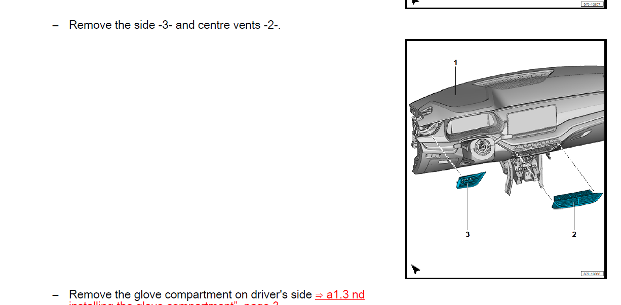

Hi,
From the repair manual it doesn't look like you need to do anything special in order to remove the vents.
Hi,
Brilliant, thank you. I was concerned with hidden screws.

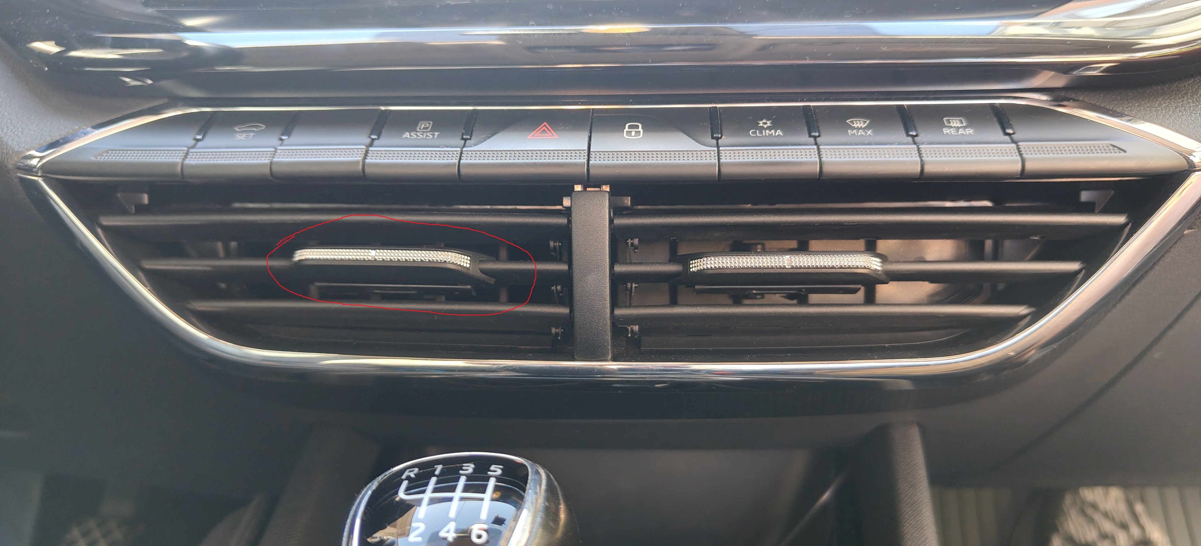

Has anyone managed to remove the central grill?
I want to remove it to put in ambient  light but I'm not sure how to pull the part.
What central grill?
11 hours ago, TheUltraRunner said:
What central grill?
The central vent (No2 on the photo you posted).
Τhe instructions just say you remove it, obviously by pulling it. But I don't know exactly how to do it and I'm afraid I might do some damage.

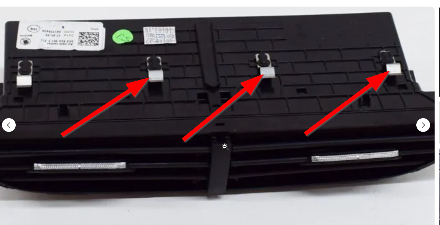

This listing shows the vent from a few angles which may help...
https://www.ebay.com/itm/145327885156
Thanks.
Yeς, I saw several photos on the internet to understand how it connects. I don't see any holes for screws, it must be with a clasp. But I don't know where to grab it to pull it.
So it looks like just these metal clips hold the vent inside the dash  and nothing more.

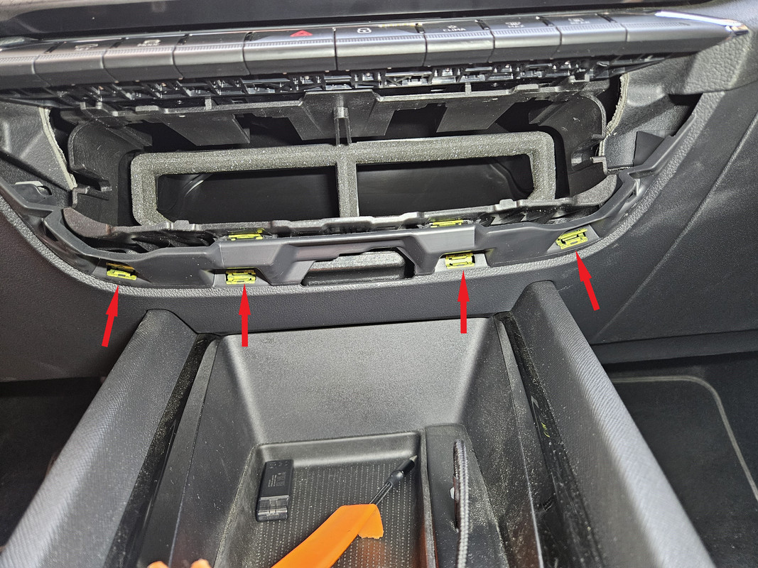

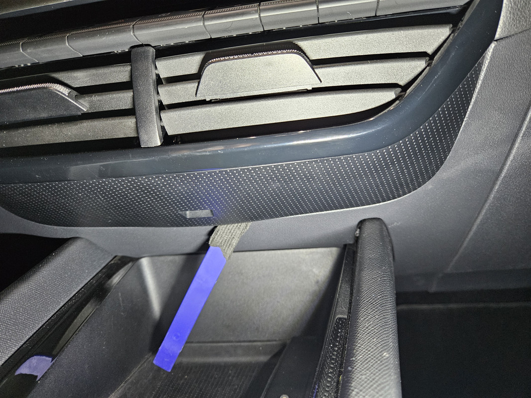

Ok, i did it
for the record, there are 4 clips on the underside of the vent, (actually the vent cap) that need pressure to come off.

There are no screws, only clips. Start pulling this out from behind with a plastic trim removal and be gently.

Well basically I just need to show on some photos how exactly you released those 4 clips.

Great, I still didn't manage to pull the mentioned part out of my car so can you please send me some photos or maybe a video with a steps how to do it? I can't send personal messages🙄

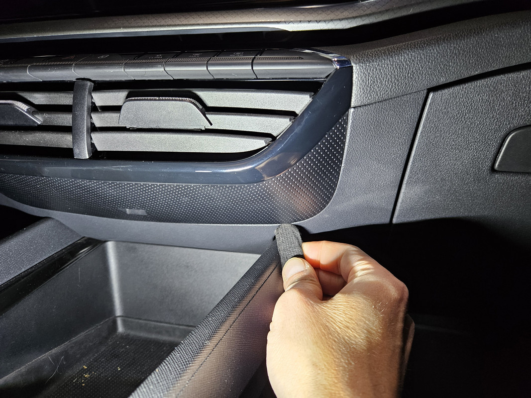

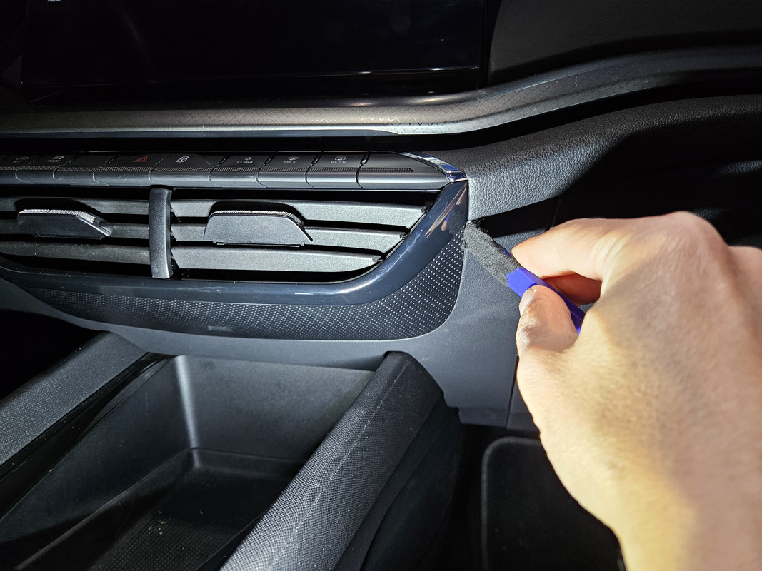

check this out.
On 14/04/2025 at 19:42, Giannis20 said:
check this out.
I know.. its crackling.. its on my fixing list.. didnt find the time yet..
Did you solve it? cant see the pictures youve posted...
