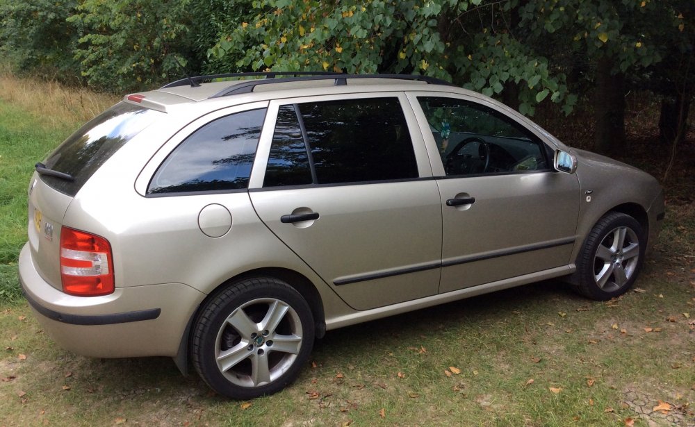

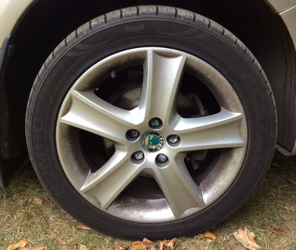

Hi,
We have a Fabia Mk1with 16 inch alloys, which I assume a OEM Skoda.
Were looking to potentially stick some winter tyres on steels, but want to go with 15 inch steels.
I’m guessing these are probably 5 x 100, which if I have understood correctly would then mean mk1 Octavia and Passat steels would be suitable? What about steels from a later mark of Fabia or did they change to 5 x 112?
Can anyone confirm please?
Thanks
