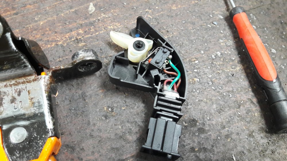

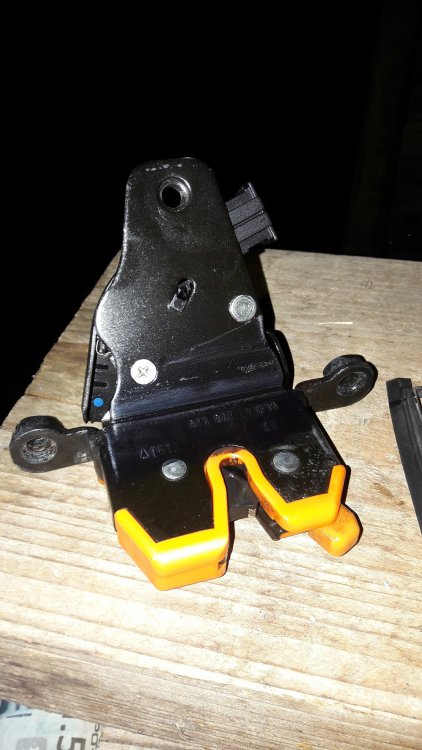

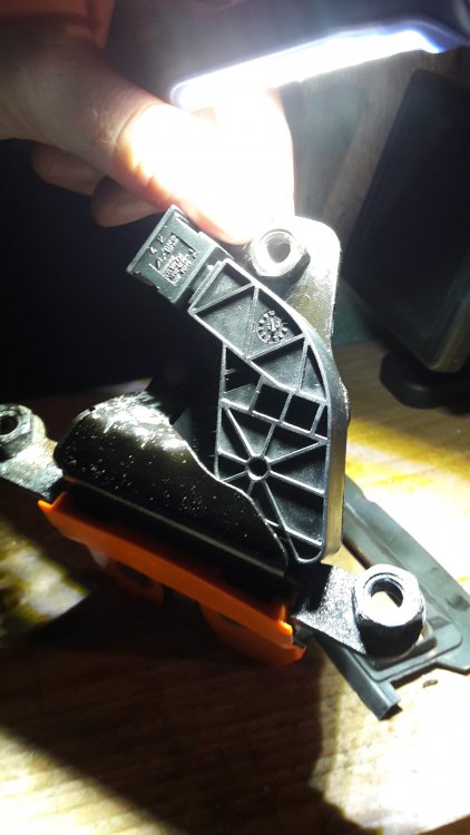

Pull the plastic trim off the tailgate (takes a lot of pulling). Remove the plug and the (three I think) screws from the lock unit and it comes out quite easily. The screws on my car are 8mm XZN spline. Some locks have one microswitch and some have two.

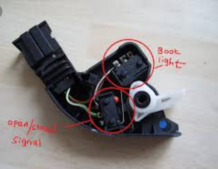

Two switch type...
