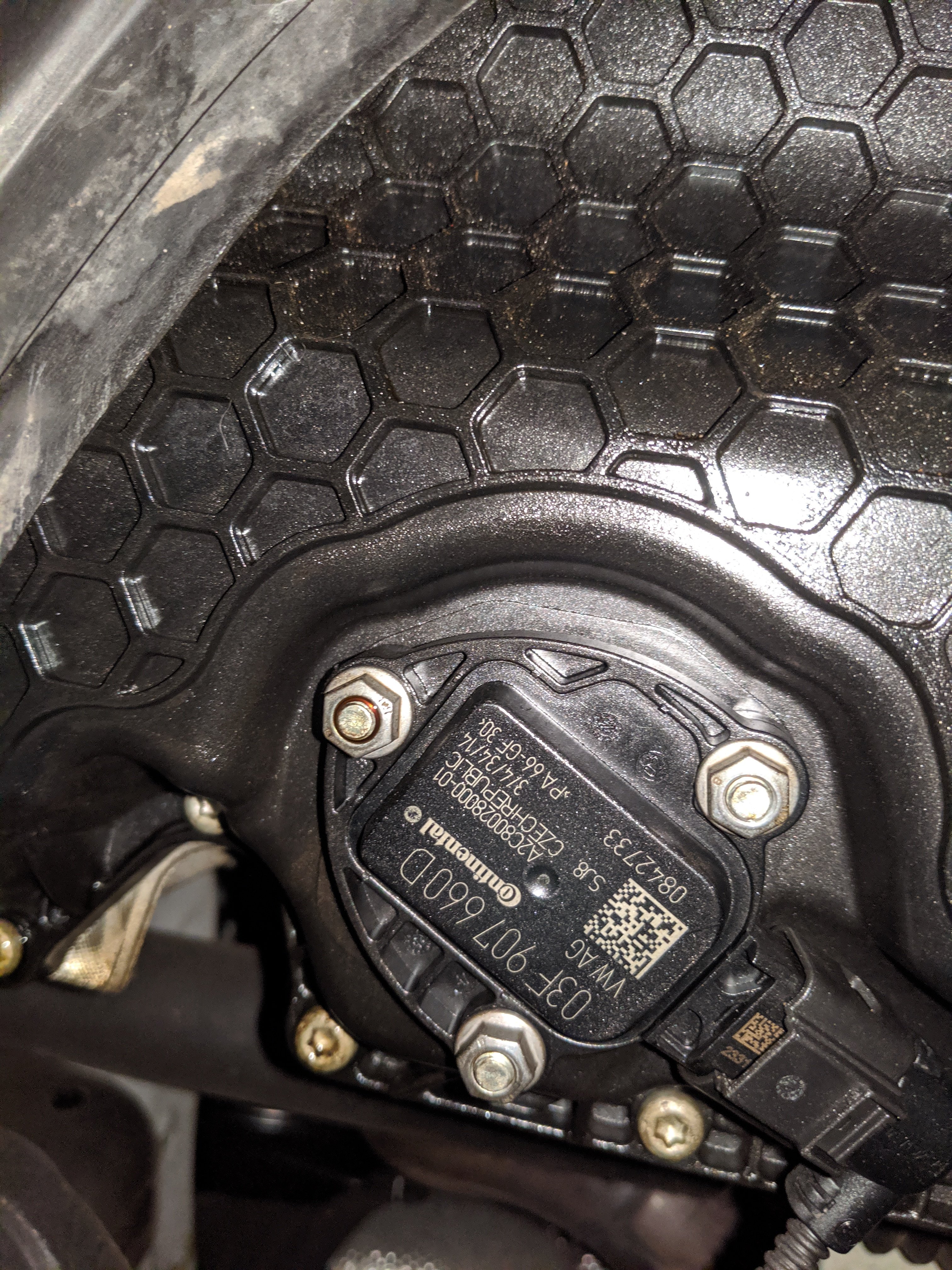

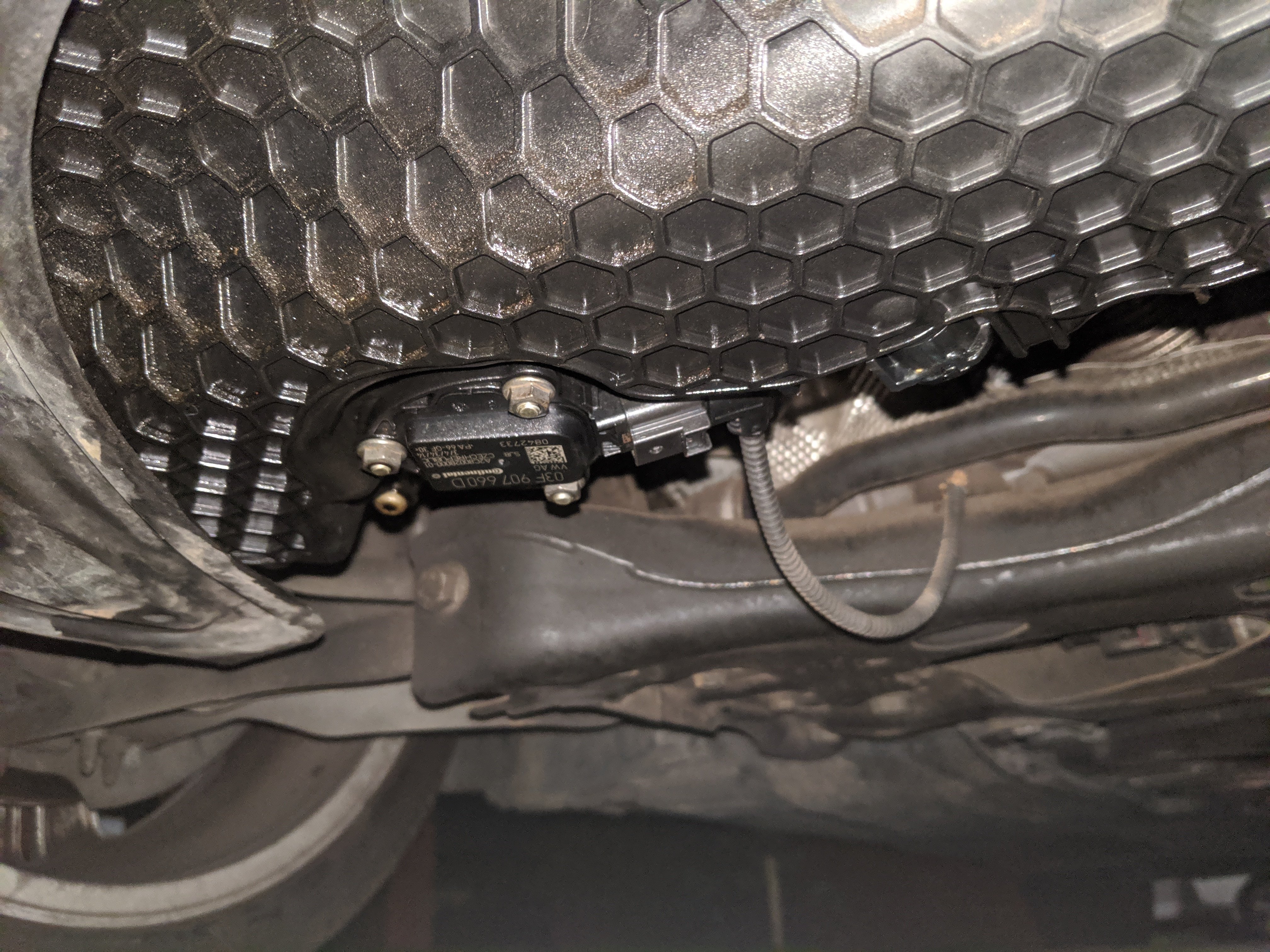

Hi guys,
Got a warning notification today to check oil level which I found strange as my car was serviced in May. It was serviced at 99663 kms and currently sits at 105700.

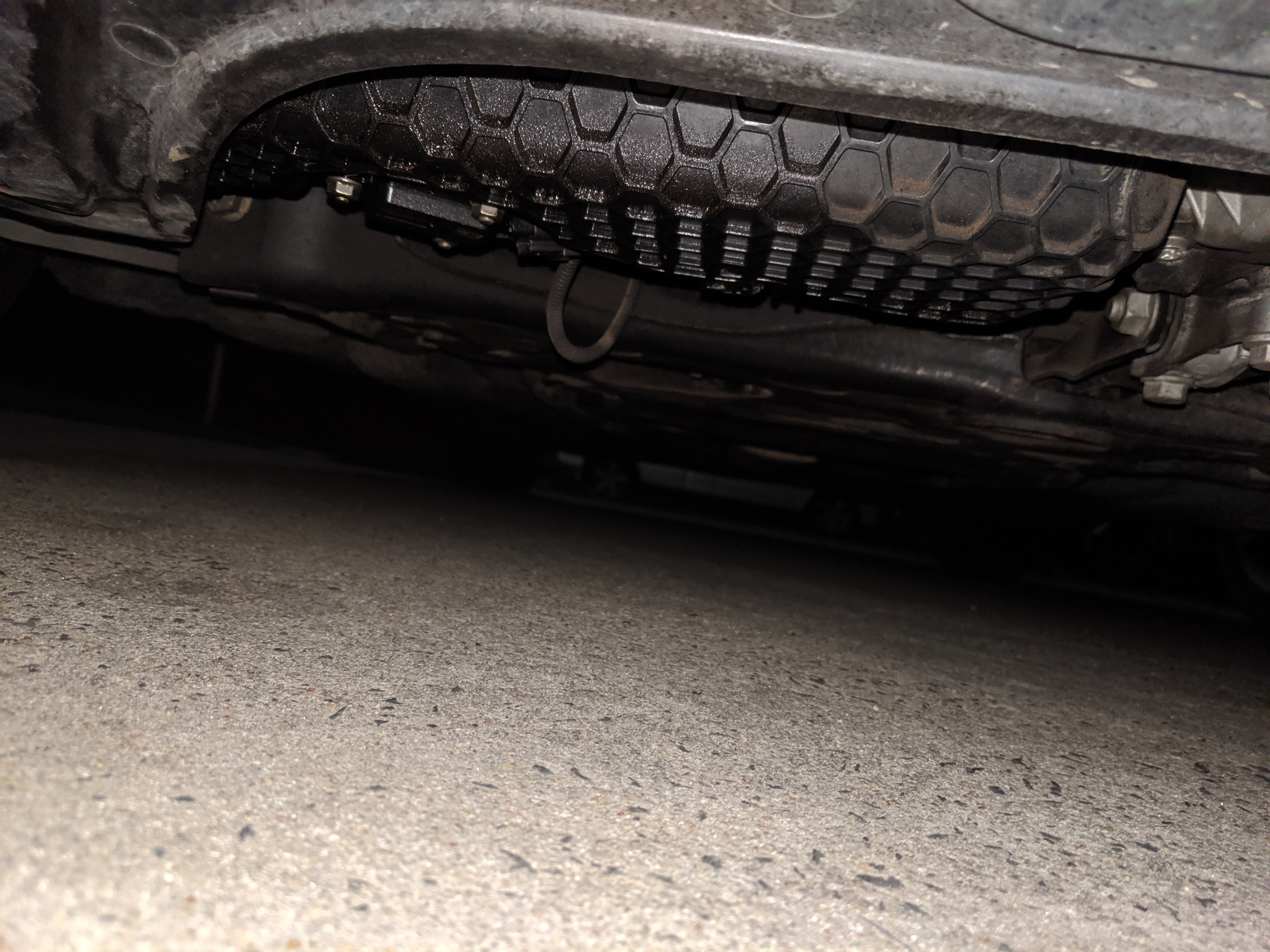

Looked under the vehicle and found a possible leak? Oil isn't leaking onto the ground, I've found it contained in some sort of catchment.
Does this appear to be a leak in anyone's opinion?
Any help is greatly appreciated.

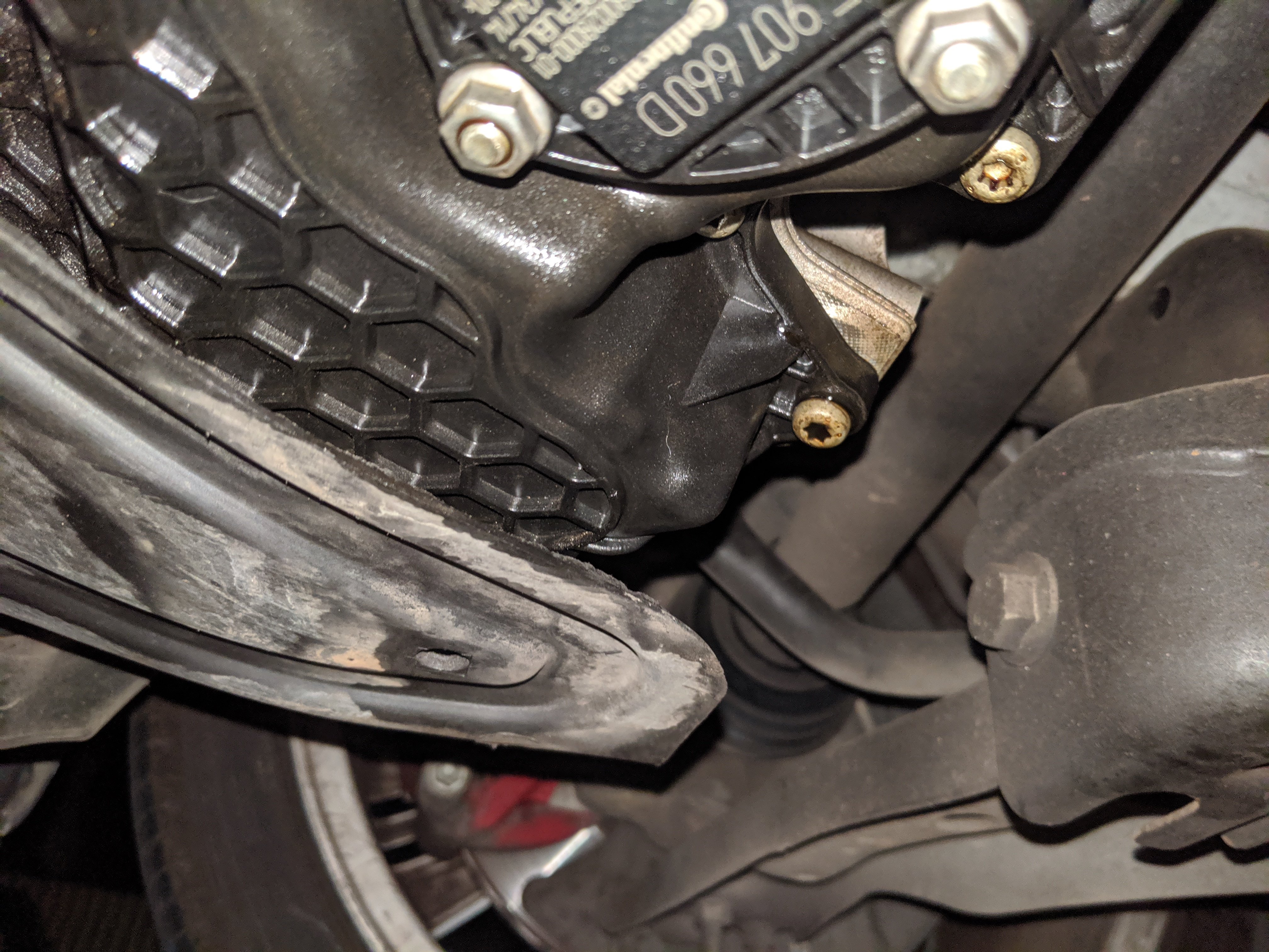

Another photo

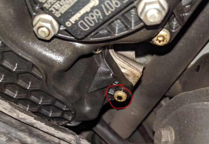

The pictures show a modern car plague, plastic sumps, and plastic sump plugs, weak in comparison, and more more susceptible to impacts and to user error i.e. not replacing the sump plug correctly or over / under tightening the bolts.
This Torx bolt looks to have it's head full of oil, possibly suggesting the oil leak is dripping off the end of this bolt.
Difficult to tell from the photo but it looks as though it is potentially loose by a couple of threads?
I'd start by checking all of the Torx bolts surrounding the sump plug first.
