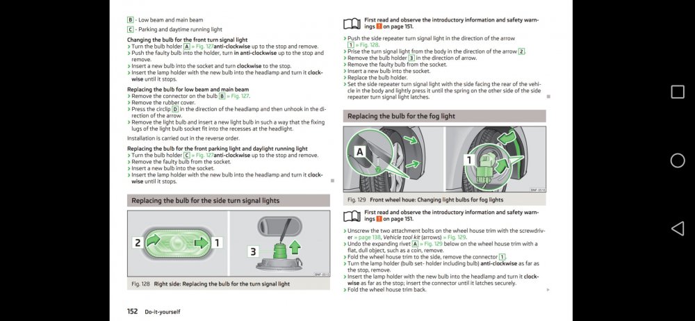

From memory how to change the side repeater bulbs is detailed in the handbook, along with showing correct removal of the repeater, check out https://vwupparts.com/ for spares.

Not  in the handbook
On 21/09/2019 at 08:55, Stu308 said:
Not  in the handbook

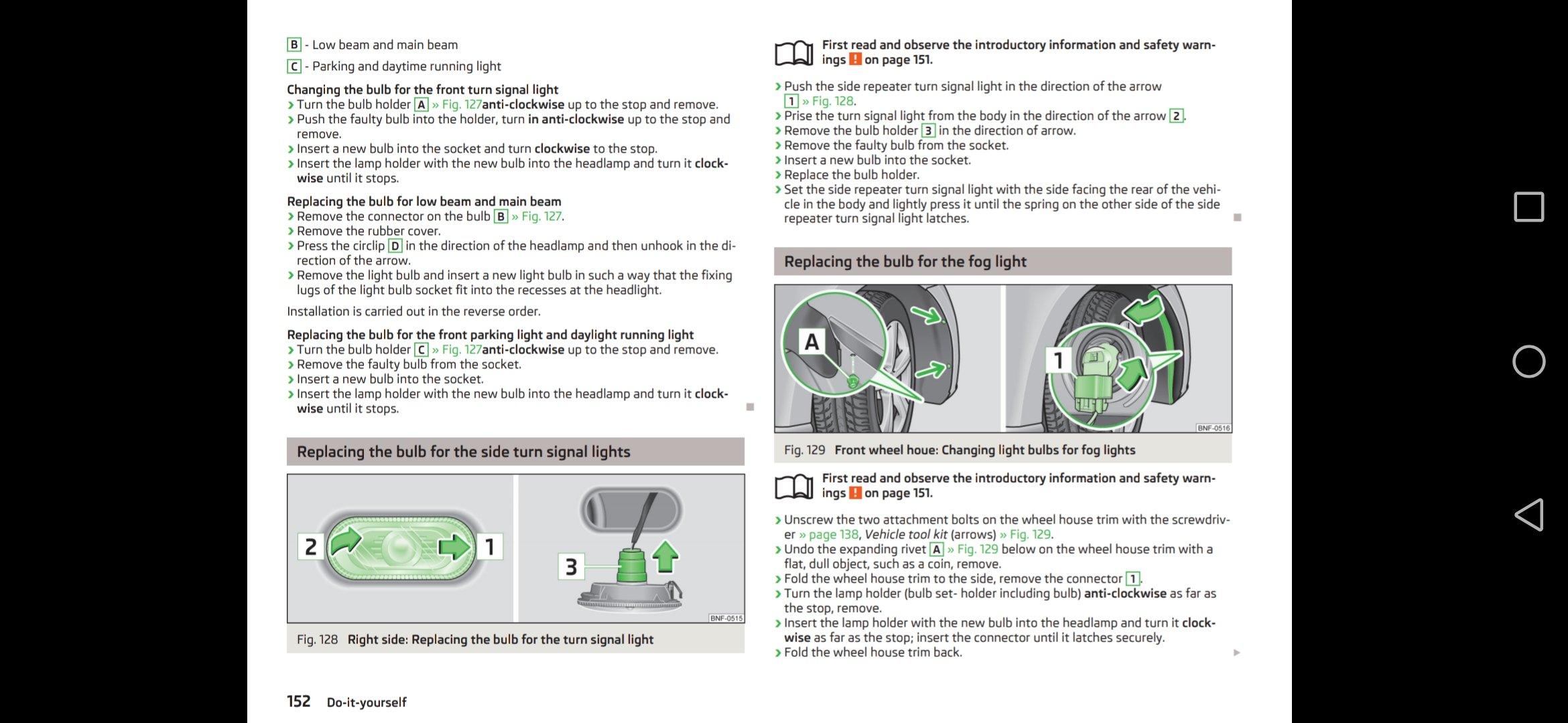

Page 152 :)
Screenshot_20190924_070559_com.google.android_apps_docs.thumb.jpg.b809f072b191e3043be9d1ac4052510a.jpg
Thanks, this is not in mine.
