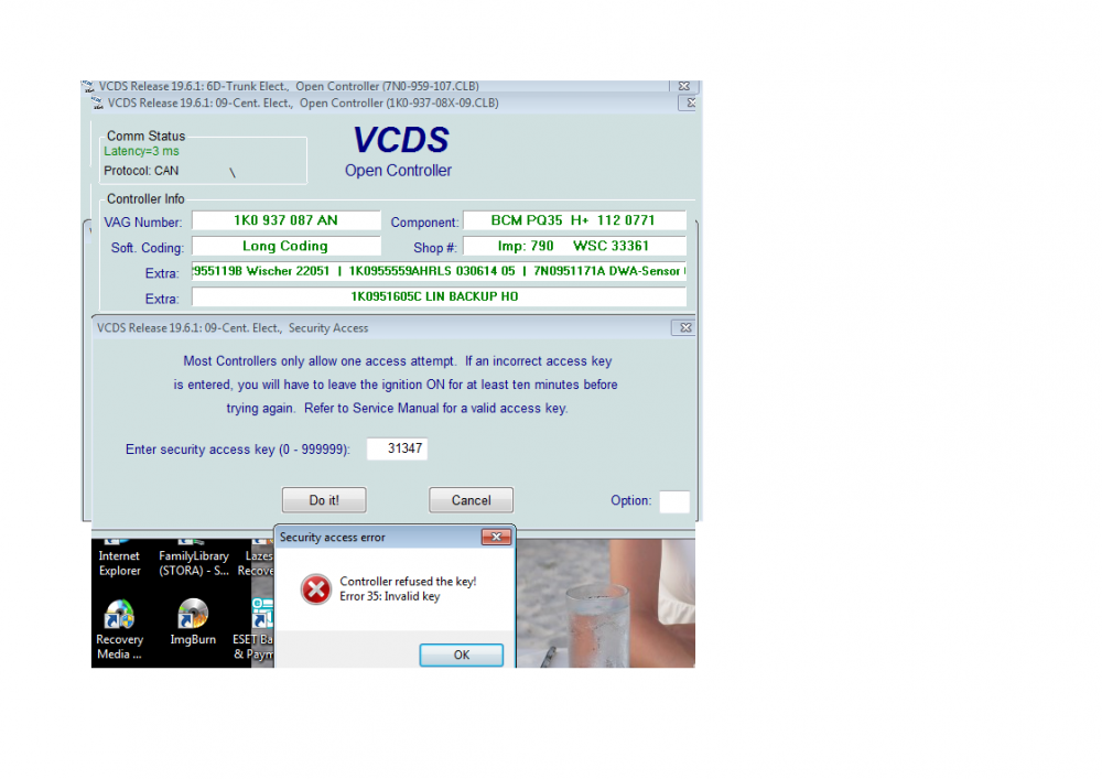

Hi ,
I was Trying to access in Central Electronics 09 Security Access 16 using 31347 and it is invalid, tried multiple times with no luck. I've got Superb II 2015.
Does somebody know what could it be the right code please?
Thank You !
What are you trying to do and did you try hovering over the input box so the tooltip comes up?
To " @Tedandmyska " - Nobody knows this security code. I Hope - just for now 😞 If you try wrong code few time, there is a chance the controler to get blocked for some minutes or hours..

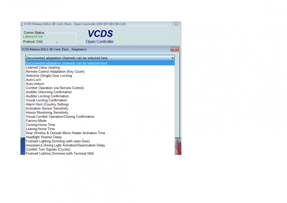

langers2k thanks for reply, I'm not getting anything when hovering mouse around or near the little window, I was hoping to enable the second rear fog light . I can access Adaptation in central electronics (see the picture ) but the adaptation for rear lights is not listed there 😞 . I read somewhere else that somebody had the same issue. Is there any way how to find out the code, plese Anybody ??
VCDS probably can't enable the second fog light on your car I'm afraid...
Take a look at byte 18 of the BCM coding. If it's 00 then stop! This means that none of the default light configurations are correct for your vehicle. If you start messing with byte 18, there is a good chance you'll not be able to restore the stock/existing light behaviour.
Instead, you would need to use something like VCP or ODIS-e and create a backup of the section from the BCM EEPROM containing the light configuration. This means you'll always be able to get back to the original configuration if something goes wrong. Once you've done this, it's a super simple change to enable the second fog lamp.
I'm not sure if you have halogen or LED tail lights. At least for the LED version, I don't think the fog lamp is fitted to both sides as default so you'd also need to replace one of the light clusters. Worth checking before you try and get it activated.
