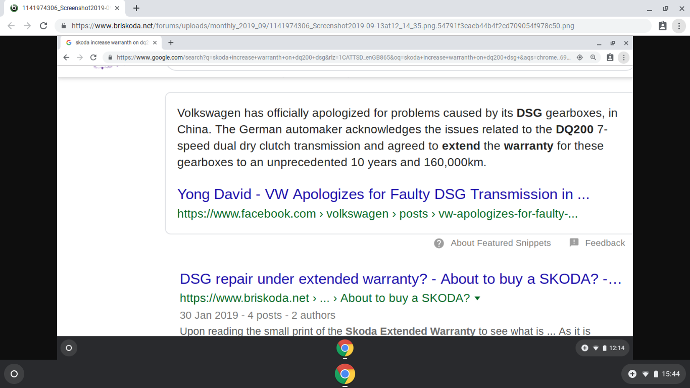

Odd that China got a 10 year / 160,000 mile Warranty at the time of the World Wide Recall but 7 years on they can not offer that on all DQ200 DSG's as being fitted now world wide.
